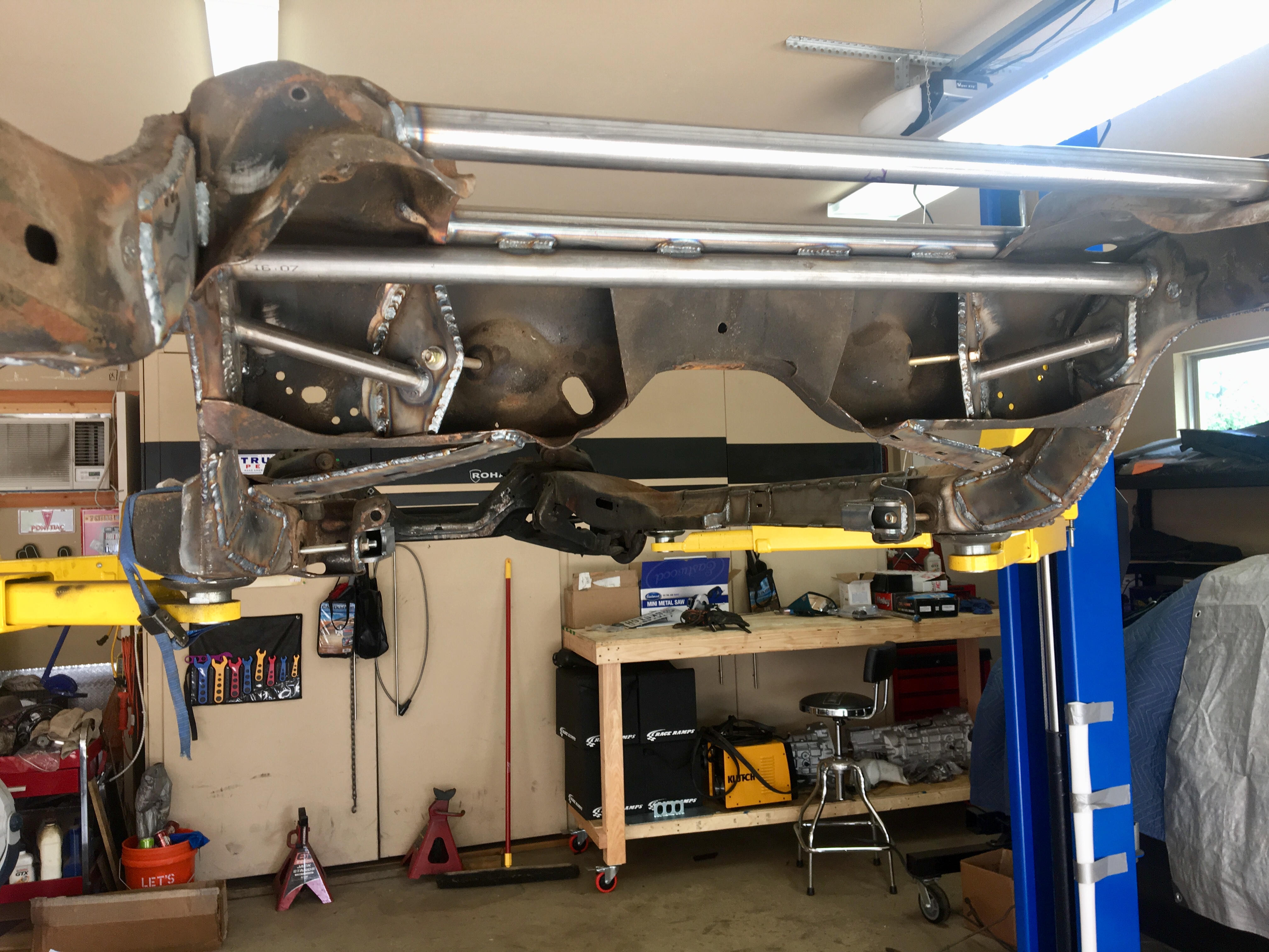

      Hows it going guy, Ive started a new project, and wanted to share on here.. It was a 1986 Grand National with 76k mikes, had a little of a built motor and has ran 11's in the 1/4(not me the previous owner. Well being a guy who cant leave crap alone I decided to rip her apart. I have bought a LT1 motor, a LT4 Blower, have a Texas Speed cam kit, a Wegner front Accessory drive, a built TR6060 with a 4th gen Fbody tail housing. I have some pics of what she looked like and will start with those. I have CCW's 18x9 front and 18x11.5 rear,(255 front and 315 rear) full Baer brakes, Quick Performance rear end. Im smoothing the firewall, pulling spare tire bump, adding Vintage air.. I notched the frame and added a ton of reinforcing, and boxed the frame, the frame is over at powder coating. I have a full QA1 coilover suspension, AGR steering box, aluminum bumper mounts, Griffen Radiator, Im adding a Dakota Digital dash, doing a PSI Harness, tore/tearing out all wiring and adding a american autowire kit, bought a GNX flare fit, and adding the GNX fender vents to help with keeping motor cooler., doing the Corbeau seats that look almost factory to a GN.. Car should be awesome. Shooting for 700 rwhp.. I blame this on Don Hutton, as Im in a holding pattern with paint(he is a popular guy) and I bore easily...EDIT... bleww LT1 up.. bought a Built LT4 from LME..

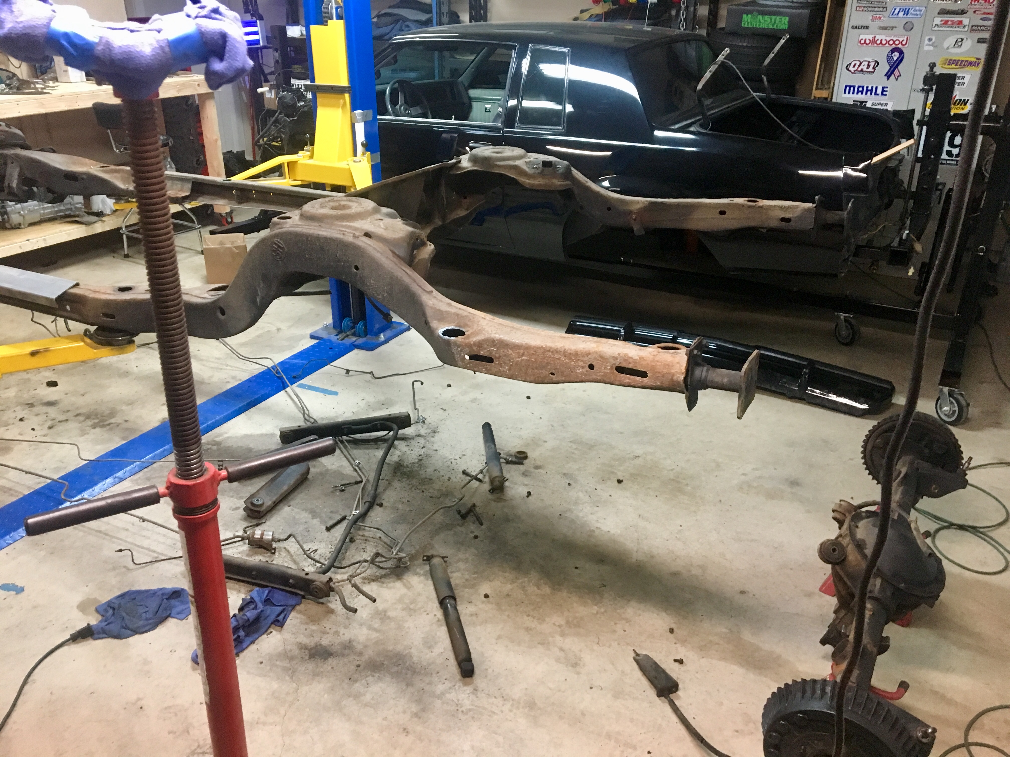

      Well now the fun starts... frame is back

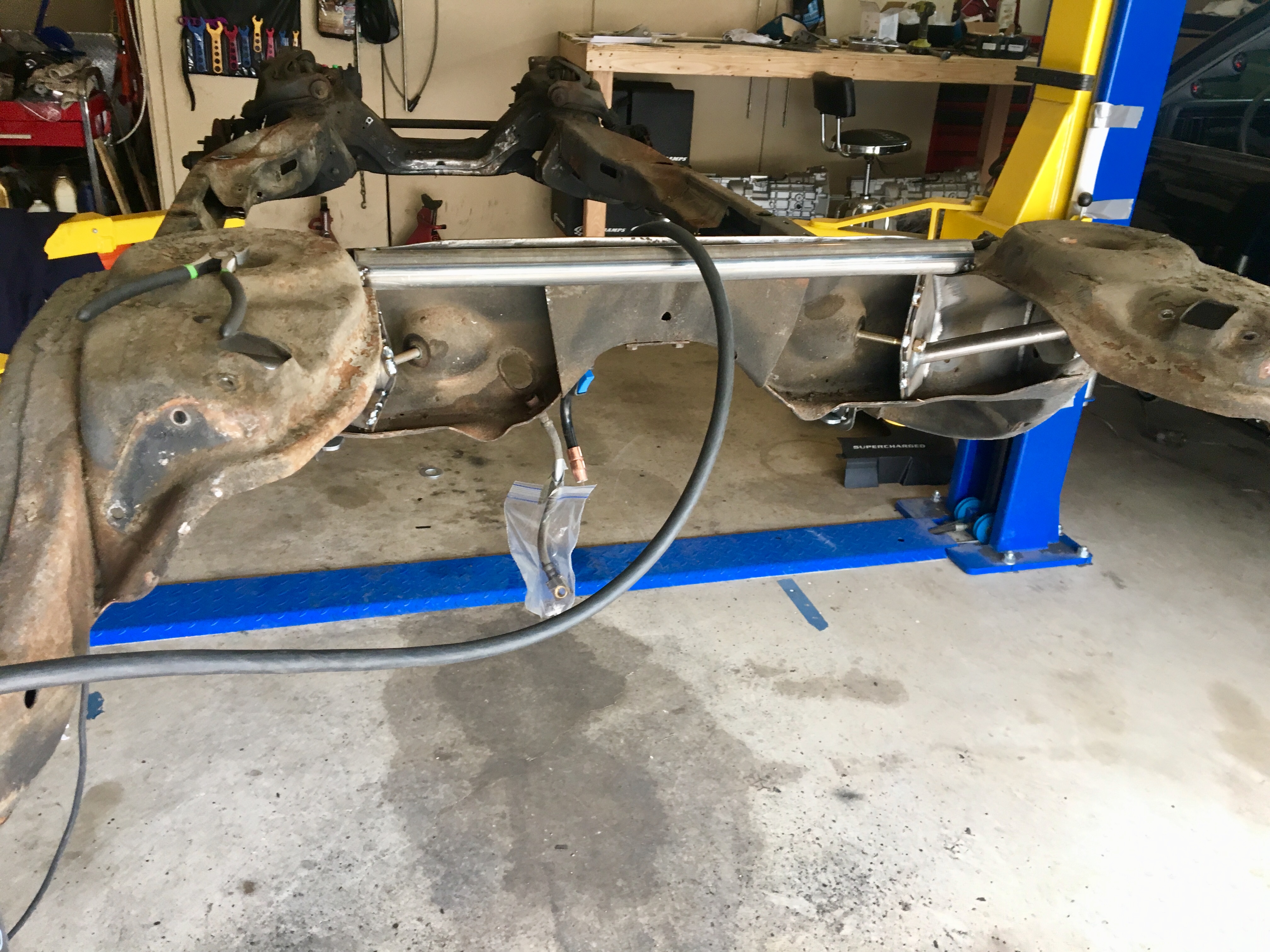

      Well started the back side of the GN

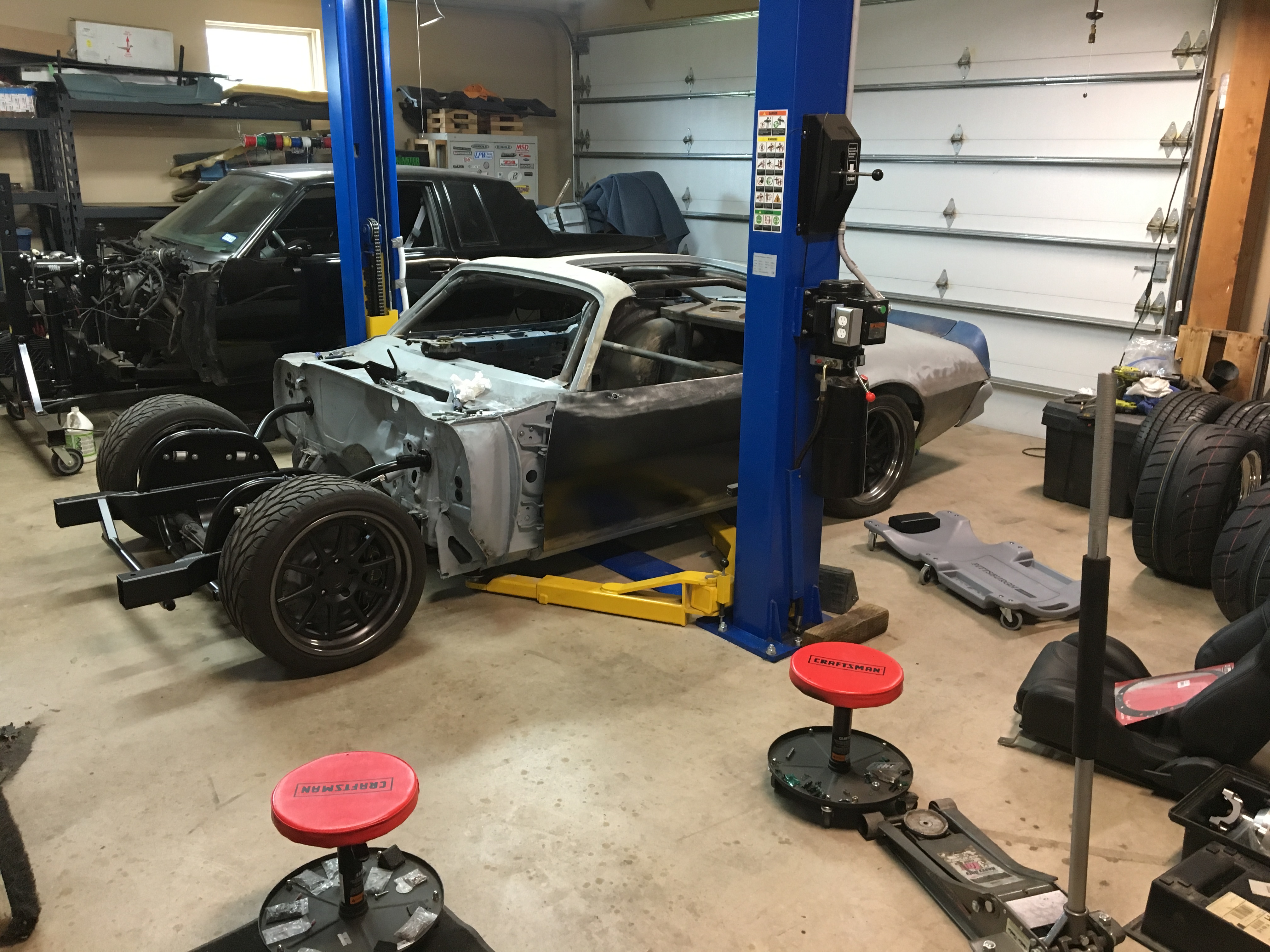

      What a guy... Did anyone else notice the two comfortable chairs that were pointed toward the LT-4 engine? Yep, just sit there and admire! LOL Really, great job so far on the car.
