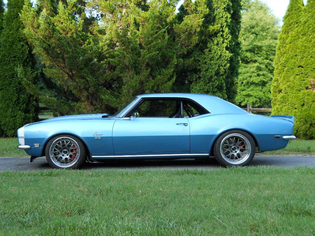

      I don't have any pics of the air cleaner but I'm running the 1st gen Cowl Induction hood with a Spectre cowl induction air cleaner base which has no under hood air intakes, along with a K&N filter top. All the engine intake air flow now comes in through the hood. I already had the hood so I figured I might as well use it as it was intended. Simple air cleaner base change and done. This dropped my IATs very close to ambient air temp.

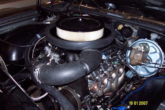

      I am putting this out there as food for thought. I have less then a 100 bucks into this "kit".
      I built this intake for my '08 Envoy Denali right after I got it last fall.
      I pulled off all of the factory stuff, measured every thing and ordered adapter sleeves and a 4" 90 degree polished aluminum tube.
      The parts I ordered:
      Spectre 9781 Air Intake Tube Coupler Black 90 Degree Elbow 4" Diameter Intake (Throttle Body Adapter)
      https://www.siliconeintakes.com/alum...89d1a58cfc1c1b
      https://www.intakehoses.com/silicone...oss-black.html
      The goal was to eliminate the Helmholtz resonator by the air cleaner
      and the quarter wave tube between the MAF and the throttle body
      AND make things look a little better...
      I mocked up the new adapters
      and made a pattern to cut the tube out of foamcore board (I use a lot of this stuff for fab work).
      I used heavy duct tape and a hose clamp to plug the resonator tube.
      I moved the PCV vacuum fitting to the MAF adapter and added a longer piece of hose to hook it up.
      Used the template to cut out a chunk of the tubing and got everything mocked up.
      I reused the hose clamps from the MAF end of the stock tube and got everything put together in time to go to dinner Friday nite.
      There is no sound difference at an idle but once you step on it and get the RPM's up you can hear a nice throaty roar from the intake. Don't know if there is much of a performance increase but it sure does look better...
