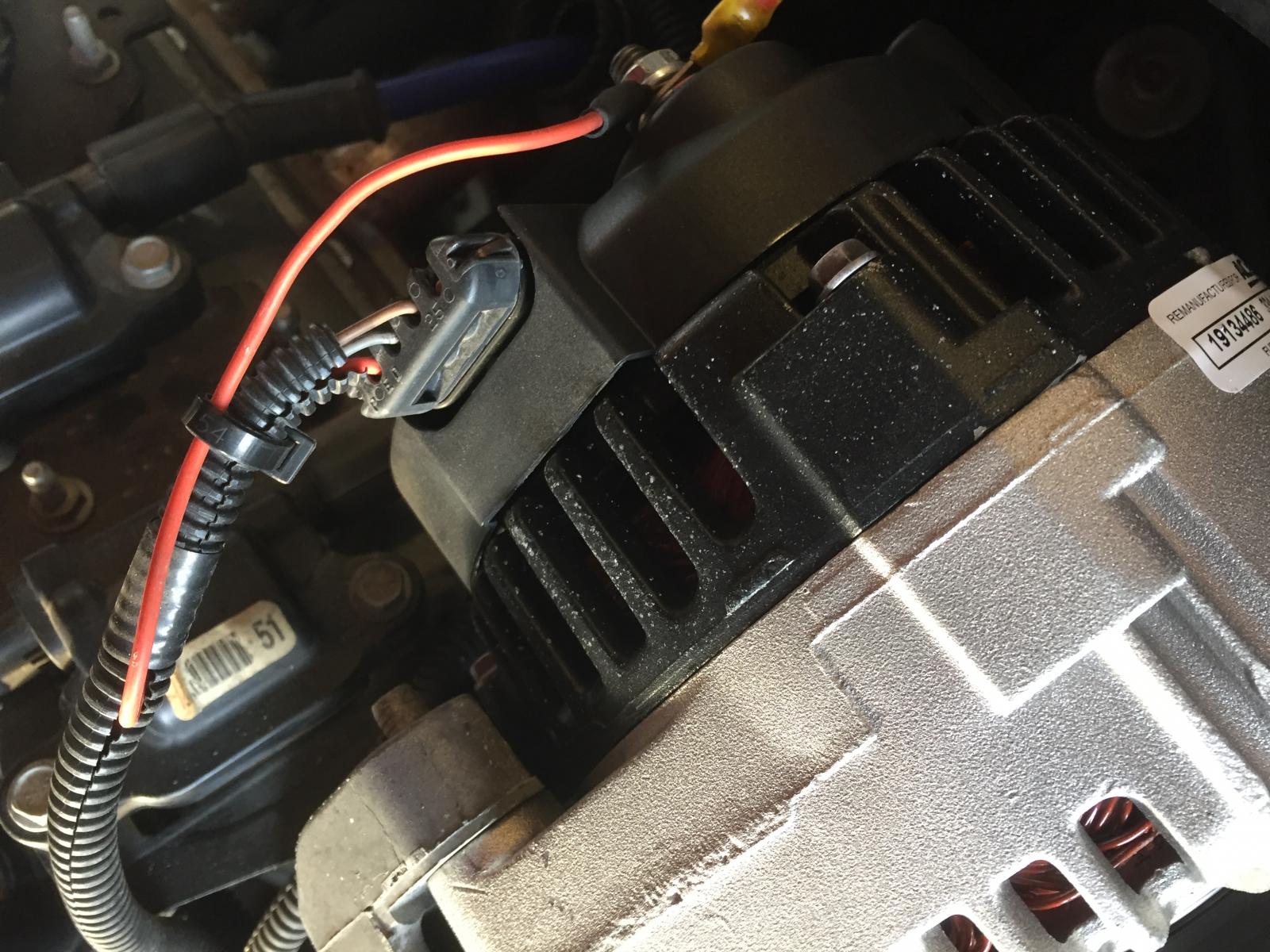

Size:  268.2 KBI will give it a shot. Do you know where the other end of that wire goes? The pic is what I have going now. Since that red wire is turned around from the plug to the stud I don’t know where it was supposed to go just that psi told me to do it.

      The red wire that loops back is probably connected to the S terminal on the alternator. Connecting the S terminal that way will also work but it kind of defeats the purpose of the S terminal which is to sense the voltage at the end of the wire and have the alternator maintain the charging voltage at that point. It's better to maintain the charging voltage at the main distribution point not at the alternator.
      If you have an alternator idiot light then the wire that goes to the exciter terminal on the alternator (which is the I or L terminal) is the wire that goes to this light. The light is on when you first turn on the key but will go out when the alternator starts to turn and generates its own voltage. The fact that your light is going off is a good sign and probably means that the exciter terminal is already connected properly.
      Check the back of the alternator and see if the 4-pin connector has the letters printed on the alternator next to each terminal, I know mine did.
      So it kind of sounds like your alternator is wired correctly and it actually works for a while but then fails. So it could still be a bad alternator or your drawing more power than the alternator can handle and it's going into thermal shutdown. This could happen if there was a partial short somewhere in the electrical system. You might try turning the key on engine off and measuring the current draw from the battery to confirm there is no short. Also check that the alternator is properly grounded to the battery ground. I think it probably is since you were measuring 11.42V at the alternator stud, unless you were using the alternator as your ground point when you took the measurement.
