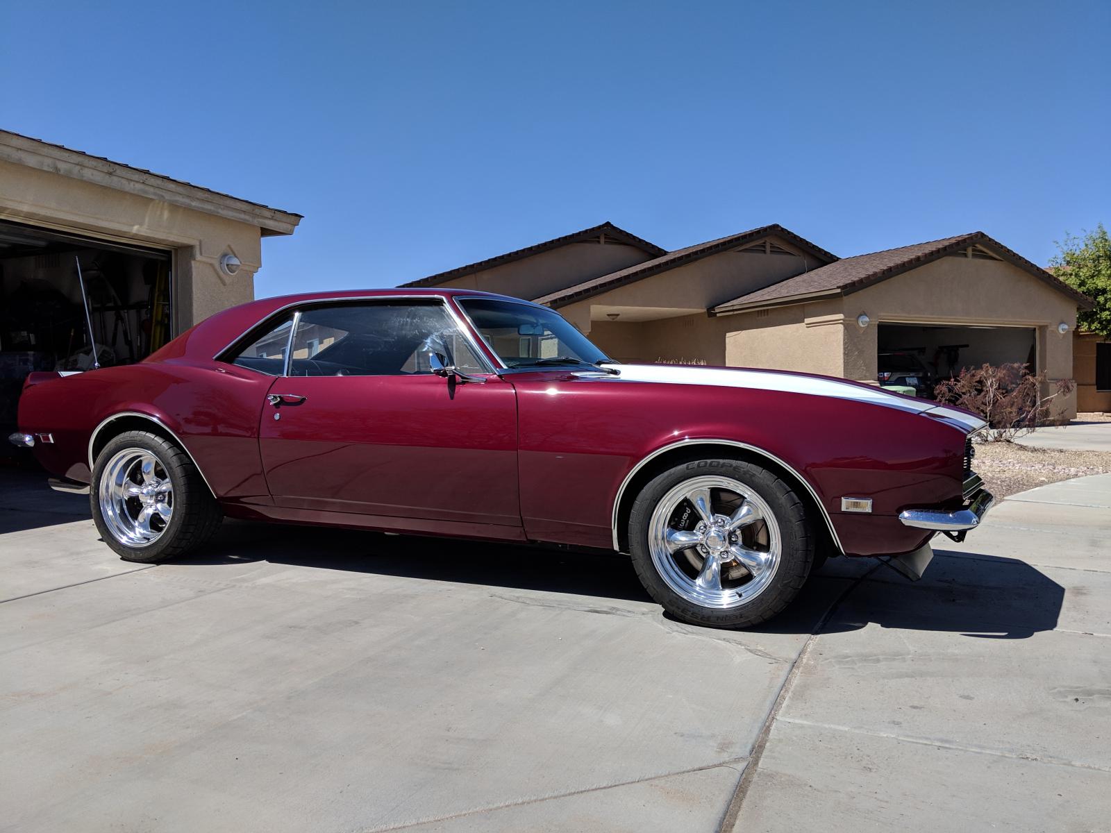

      I have Global West L2 leaf springs with their bushing kit and I'm real happy with them. I also have a remanufactured IROC box and was very impressed with the bang for the buck I got by installing it. So far for the front I have some coil springs recommend by David Pozzi on his website and 2" drop spindles. Works well for a street car, but I definitely need better shocks.Name:  IMG_20190313_124218.jpg
