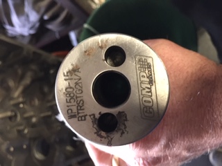

      Name that cam
      Cam in current LS2 w/ 243 heads, cant seem to fing the specs.
      Anyone know what they may be?
      Combo made 460 rwhp and 440 tq before tear down to freshen up.
      Considering swapping in freshly built LS3 with no cam in it, can i use the LS 2 cam?
      Liked the characteristics of this daily driver cam, had plenty of power. Idled at 850 and ran a/c without an issue using early ecu.
      It was in an auto trans, built 4l60, 3.42 gears, 26" tall tire in my 68 Camaro rag top.

      Looks like you have a BTR stage 2 n/a meaning naturally aspirated. BTR = https://www.briantooleyracing.com
      And your cam specs here https://www.briantooleyracing.com/ls...ge-ii-cam.html

      thx,
      you know i did a search and found that manufacturer but wasnt sure due to the "comp cams" logo at the bottom and wasnt pulling up on Comp Cams sight.
      ill have to call them and see if cam will work in my ls3 planning to swap in or better option with same drivability.

      Many of the cam companies either use a comp cams core to grind or comp cams will grind it to their specs.
