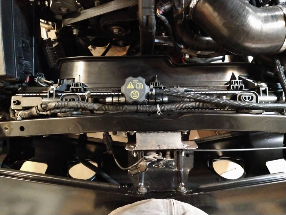

      Yes, I dig TIG weld the heater core lines to extend them so they would reach through the firewall.

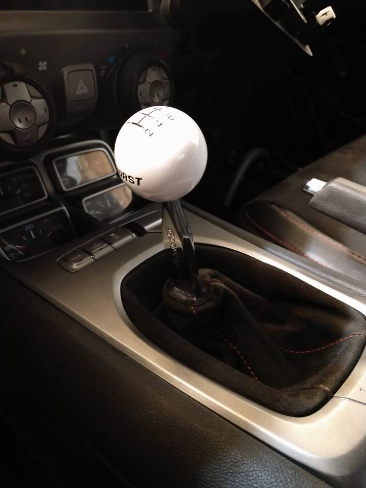

      Thought I would post an update...Added a few more trinkets to the car...Rally sport grille, DSE actuators. And something every 60's muscle car must have...Hurst shifter ;) also hanging the front suspension, tied the steering column to the power rack, added power steering pump and lines. I gave up on trying to use the electric power steering...just couldn't get it to fit right without chopping up my new subframe.Name:  IMG_20200204_051026865.jpeg

      Thanks for the reply, what about the ac lines? You going to extend them too or just make a recess in the firewall?
    5. #45
      Jun 2017
      Idaho
      173
      The AC lines are still a question mark...I have some ideas but haven't executed anything as of yet. I will probably make something to transition from the core to the firewall, or possibly just use a grommet to bring the engine bay lines through. It is on my radar to solve soon though.

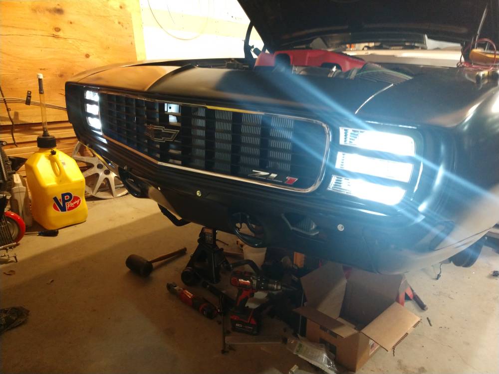

      Love the Halo headlights. Name:  IMG_20200303_045257395.jpeg

      I really like those headlights what, who makes them. Really amazing work all around!

      Thank you! I found those headlights on eBay if memory serves...they have the white Halo just like the 5th gen car had plus the Halo flashes orange and acts as a turn signal as well They are for Jeeps.

      Which brand? Part # did you use?
    20. #60
      Jun 2017
      Idaho
      173
      Headlights:
      https://www.amazon.com/gp/aw/d/B0781...?ie=UTF8&psc=1
      Keep in mind that these are not a direct fit. I had to trim some of the cooling fins off the back and some messaging to fit the buckets. Worth the effort though.
