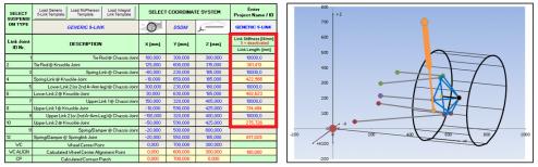

      Oh I agree there is a huge amount of value to their engineering design, I'm not at all thinking I will be getting a result as amazing as the Art Morrision setup, I understand there is a reason its priced as it is and I imagine its worth every penny. I fully plan to at least run things through a dynatune suspension design software (example of what sort of stuff you can do with it below) to compare it to the stock S550 rear suspension, which I'm 100% sure the Art Morrsion setup is probably leagues better than, but im just going for better than solid axle handling in all reality and on a budget I can afford (I have the time to do this luckily, and the time it would take me to earn the $9,000 dollar difference between this build vs. the AME setup at what I make is much more massive).

      I know there is a lot of software out there you can input in your suspension geometry for stuff like wheel load transfers, spring properties, roll calculations, and the forces that will be exerted on your wishbones and springs. I've also found a few links that allow to get a decent idea of changes in handling characteristics for double wishbone and macpherson style strut suspension setups where you are able to adjust the mount criteria for the frame points as well as the control arm lengths and inclination

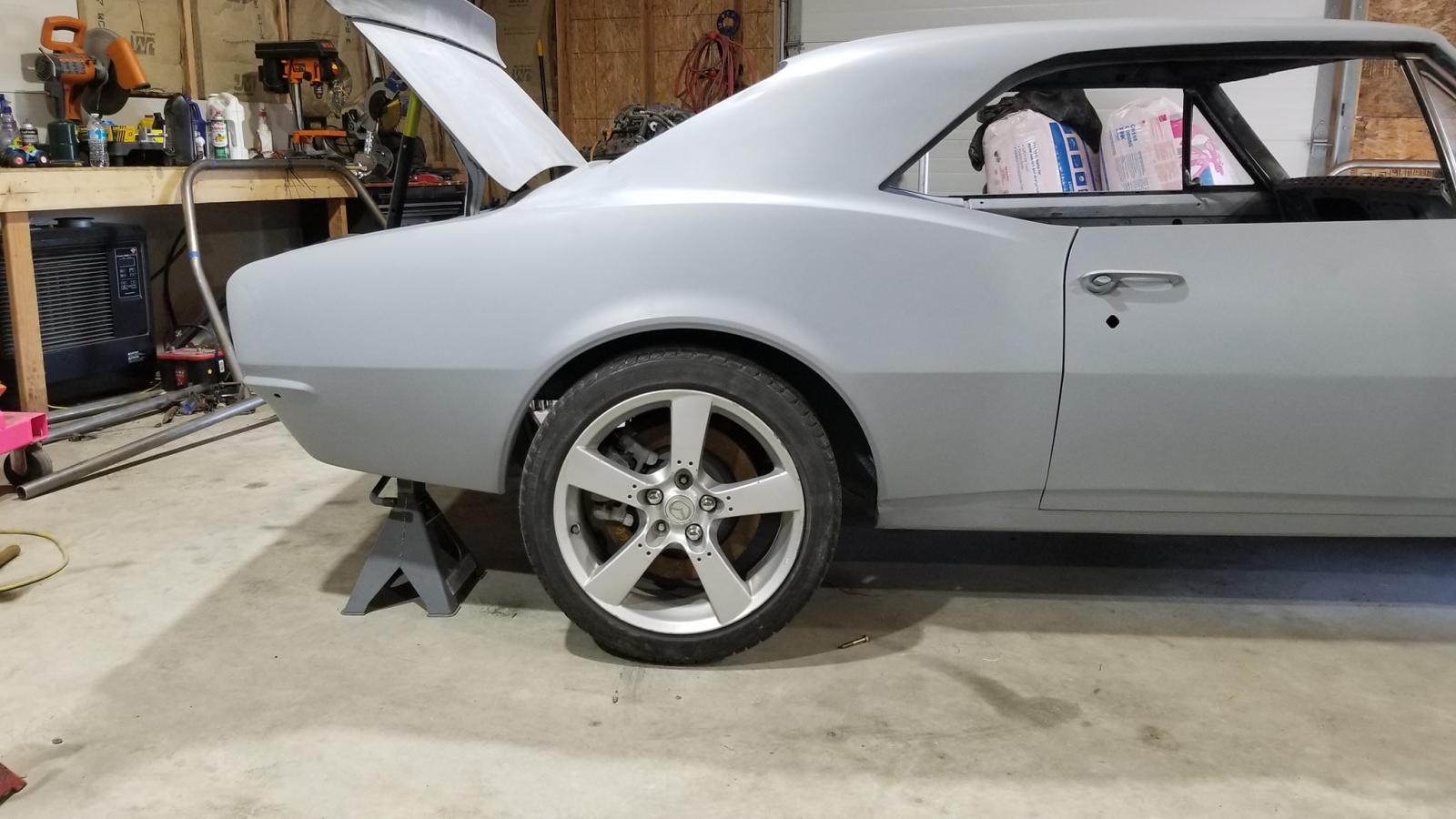

      Also, with the suspension mocked up in the rear (with stock rx8 wheels installed to get a base of measurement and to get a rough check of clearances), it looks like I may be able to run 18x12 +65 wheels on 315s as one option. This gives 30mm of push to the outside and 60mm extra on the inside (have plenty of room with the mini-tubs and a coil over relocation) Fenders will be most likely pulled/rolled to give a little extra clearance. With this in mind, to get it to be flush as the RX8 wheels are, I would only need the 30mm shortening of the rear track width (1.2in or so on each axle).

      I do see it being a possibility to build a subframe that is shorter to accommodate not having to change any control linkage lengths as well, it would though alter a lot where the mount points would be.
