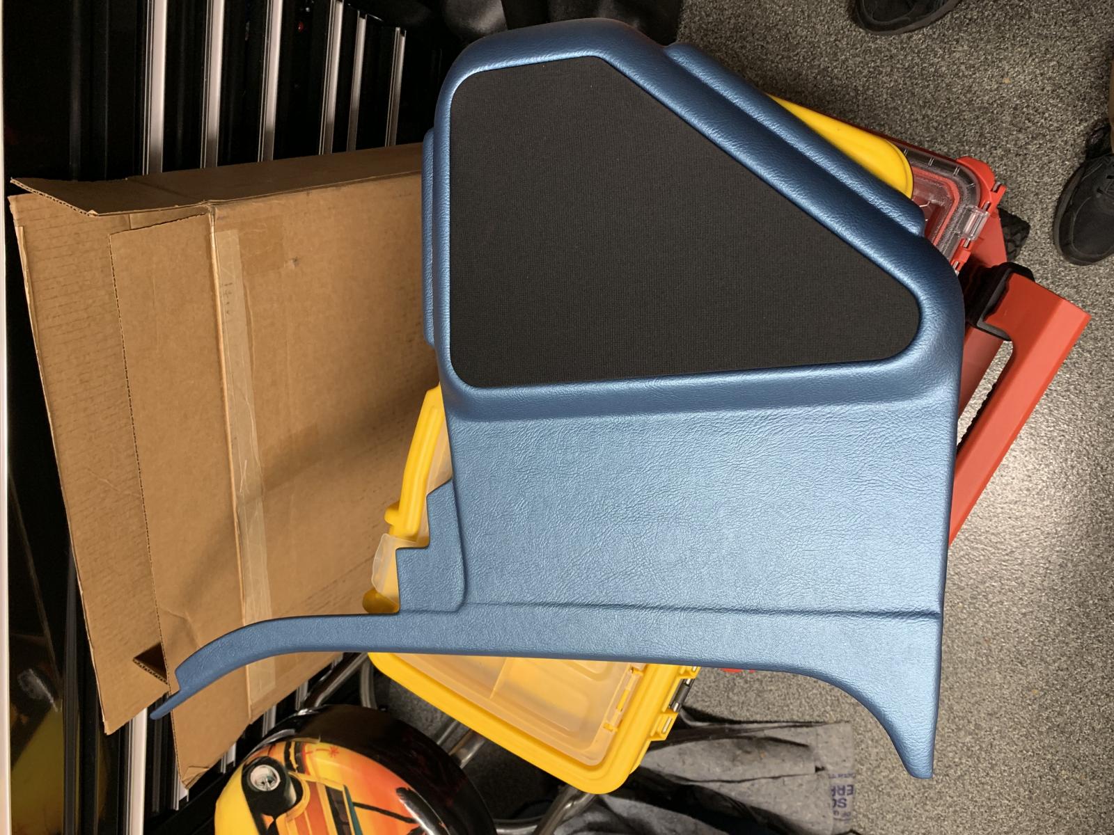

Size:  304.6 KBSome guys leave the stock kickpanel in and you still have “fresh” air option. I originally bought a set of screaming performance kick panels but now I am switching to The Shop, LLC ones. I switched to the aftermarket ones because I wanted a better speaker option. Both of those brands I mentioned come with a “cup” that blocks the fresh air inlet.
