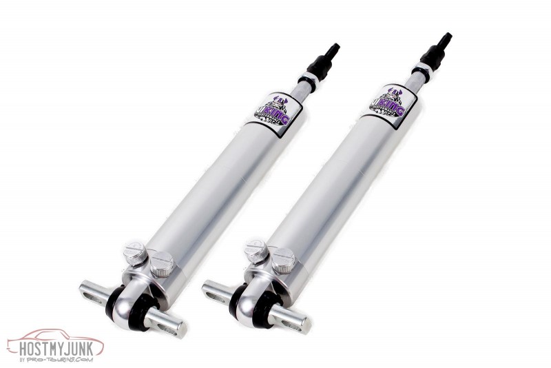

      My question is, will any manufacturers coilovers work with these arms? I would like to run Viking double adjustables if they are compatible. I may call DSE directly but like another thread i read, DSE is going to suggest I run one of the products they sell and not a competitor’s product with their arms.

      So long as they have compatible mounts then you can run anything you want.

      Number One, check with DSE
      Number Two, pictures would help, but if the Lower Arm has the holes for a T-Bracket, then a ViKing should fit

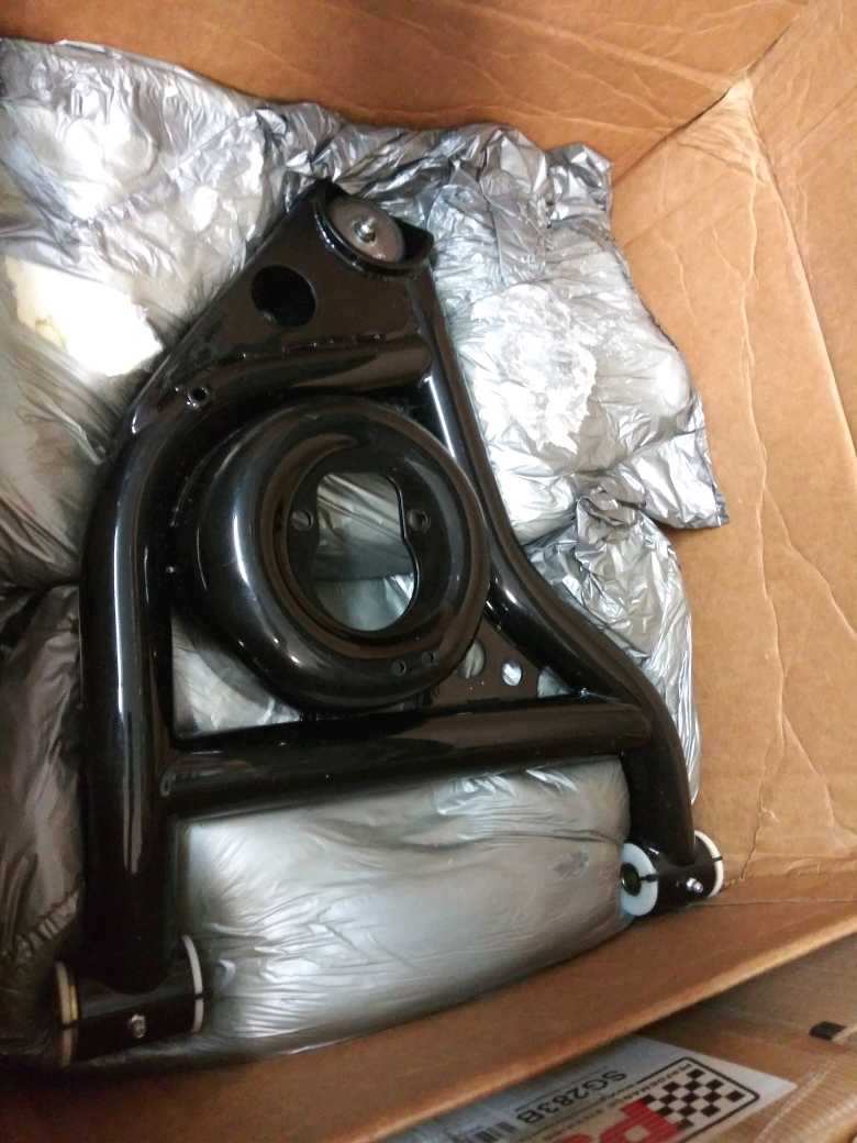

      Thanks for all the replies.
      I emailed Viking and they said the same thing. It should work as long as the lower control arm has a T-Bar mount on the lower shock mount. Attached is a photo of the DSE lower control arm.
      Jim

      Looks like such a mount. Let us know when you get it installed. I have these arms too on my 71 and want to keep track of my options for coil overs down the road.

      the ViKing is going to attach at the Bottom with a T-Bracket, it will work
