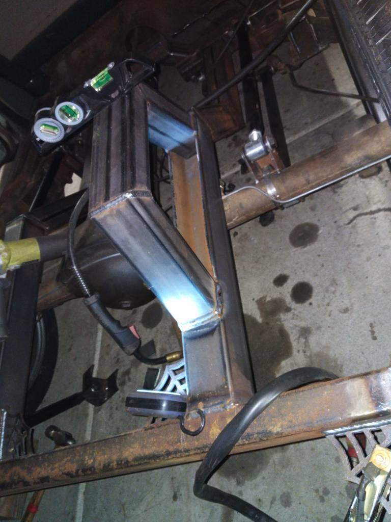

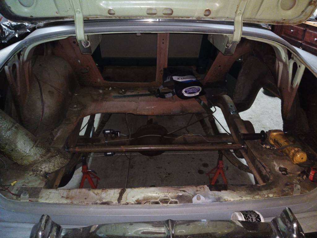

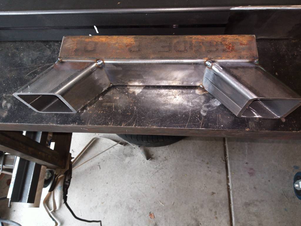

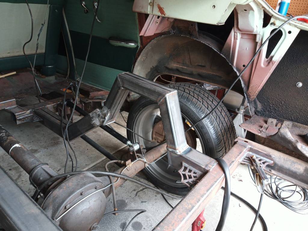

      vallejo,ca
      262

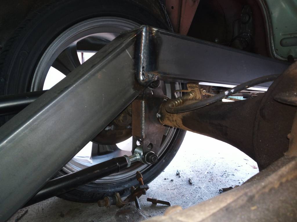

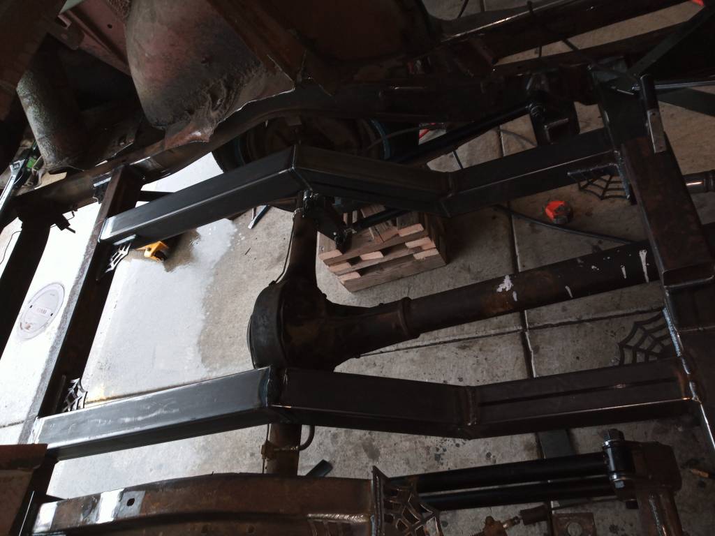

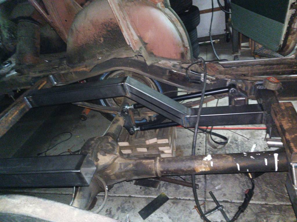

      Then I started making the rear cross member for the new inner frame railsName:  IMG_20190105_120840.jpeg
Size:  137.8 KBName:  IMG_20190105_123258.jpeg
Size:  87.5 KBName:  IMG_20190105_134146.jpeg
Size:  71.6 KBName:  IMG_20190105_142606.jpeg
Size:  109.4 KBName:  IMG_20190105_173500.jpeg
Size:  108.8 KBName:  IMG_20190106_145404.jpeg
Size:  77.1 KBName:  IMG_20190106_145350.jpeg
Size:  113.7 KBName:  IMG_20190113_144421.jpeg
Size:  78.9 KBName:  IMG_20190113_144555.jpeg
Size:  72.4 KBName:  IMG_20190113_144228.jpeg
Size:  49.1 KBName:  IMG_20190113_150705.jpeg

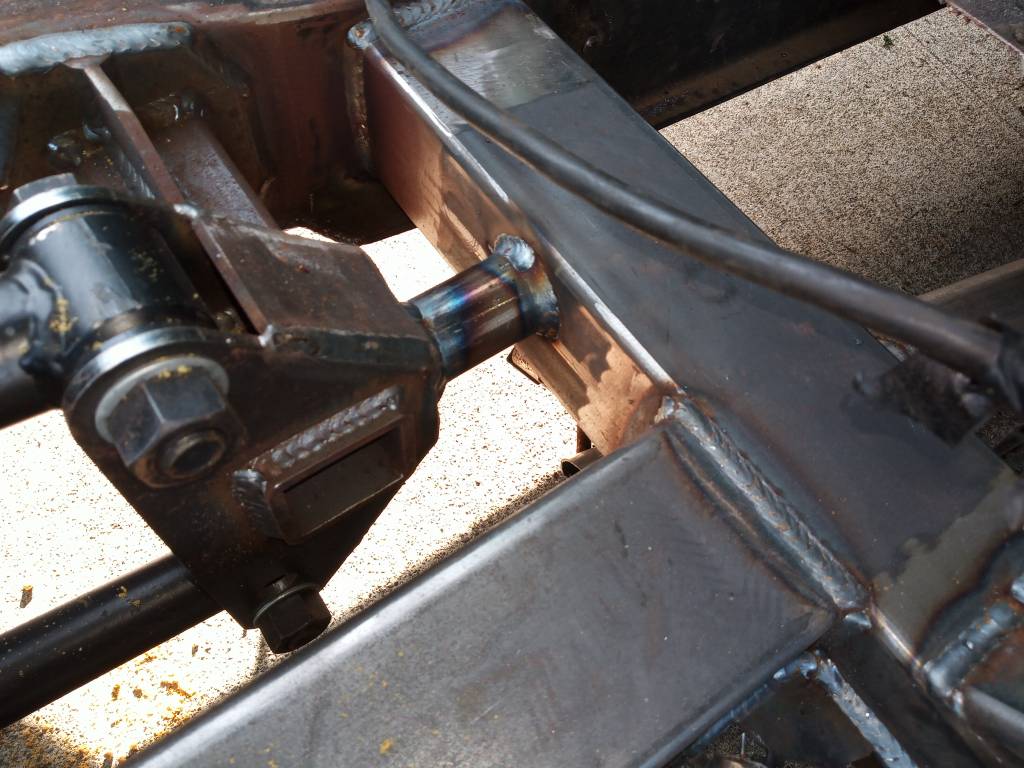

      And though I'm not a chassis builder, that outrigger setup for the front of the 4-link looks very unstable. Might I suggest triangulating it to the chassis?

      I believe I know what ur speaking of. There will be a pan hard bar added an the for link will get ties into the front crossmember also I will make update today.. on it weekends are the only time I work on the car I will post pics later

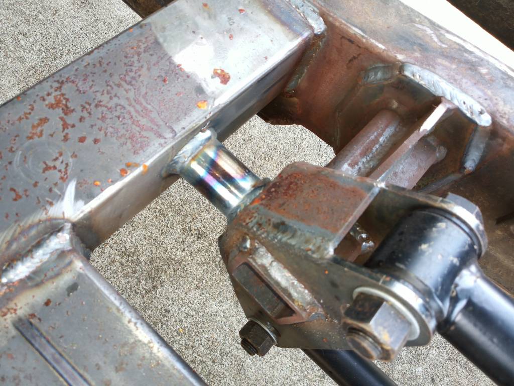

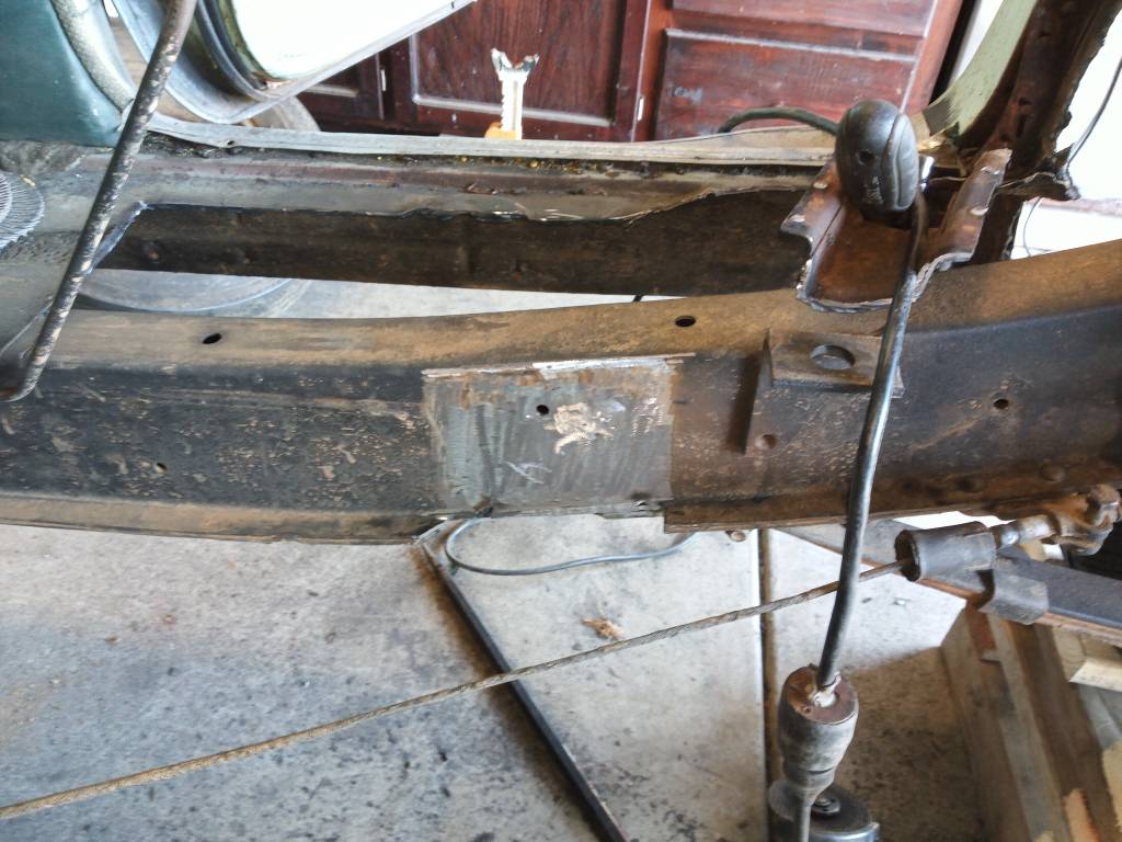

      Small update tying 4link into front crossmemberName:  IMG_20190119_132559.jpeg
Size:  147.0 KBName:  IMG_20190119_141602.jpeg
Size:  126.5 KBName:  IMG_20190119_141610.jpeg

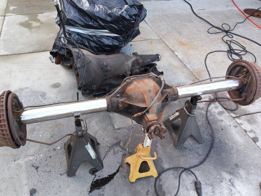

      Cleaning up Camaro rear end for the 1954 210 so I can weld 4 link bracketsName:  IMG_20190119_154621.jpeg

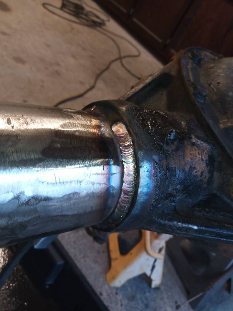

      Welding axle tubes on gm 10boltName:  IMG_20190120_153739.jpeg
Size:  64.9 KBName:  IMG_20190120_153805.jpeg
Size:  52.5 KBName:  IMG_20190120_153815.jpeg

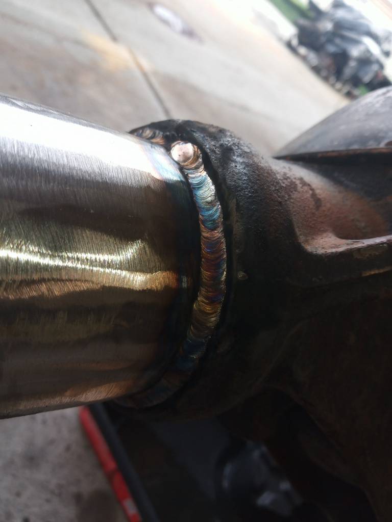

      Last one from yesterdayName:  IMG_20190120_170605.jpeg

      Is that Super Missle Weld rod?
      Follow my Instagram
      And my build on here
      check out Opentracker Racing Products
      vallejo,ca
      262
      Quote Originally Posted by Project Bike Truck View Post
      Er70s6

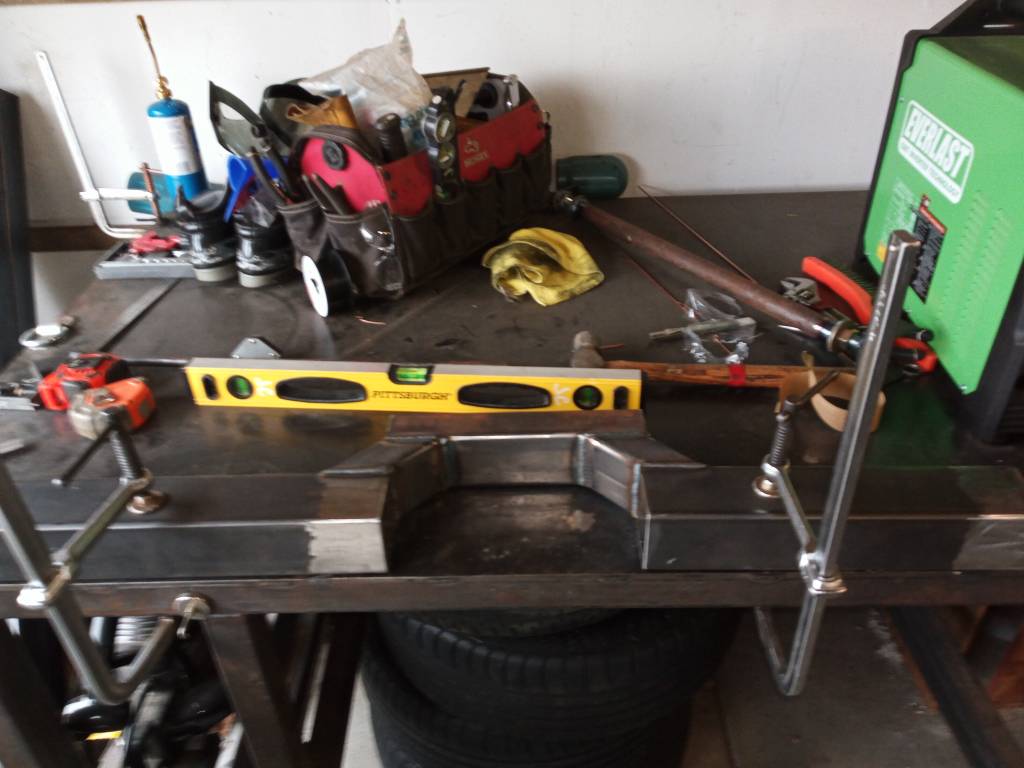

      Started the step notch for the rear. Notch made out of 2x3 3/16 steelName:  IMG_20190201_201628.jpeg
Size:  82.8 KBName:  1549081310353.jpeg

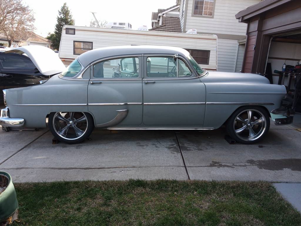

      Set her down on the ground with the notches
Size:  24.3 KBName:  Screenshot_20190202-173920.jpeg
