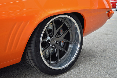

      Can anyone positively identify these wheels with model name? I think they are probably Forgelines but if so I need to know the model and or series. Thank you!

      After searching a few hundred more pics I might have an answer my own question. Possibly Forgeline GA3's?

      That's the VR3P. Looks like Gunmetal center with Polished outer and exposed hardware.
      https://forgeline.com/wheel/vr3p/

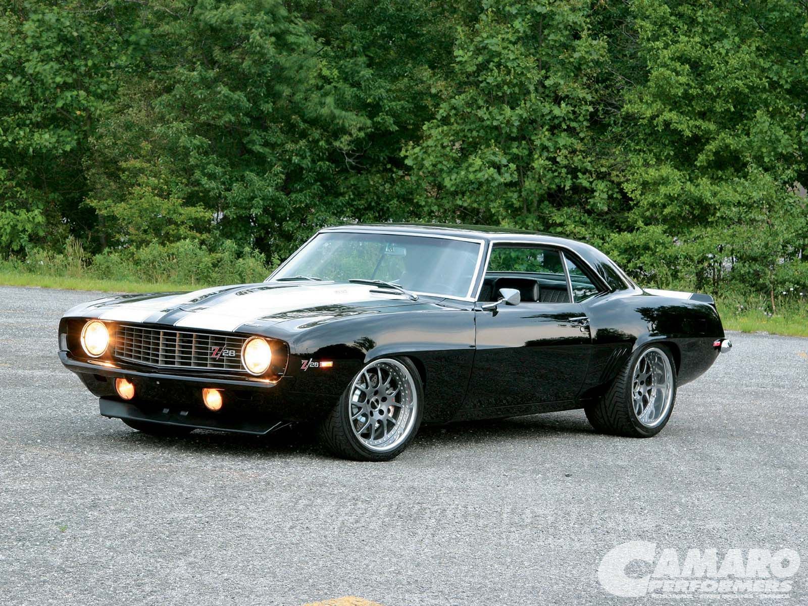

      Can you confirm that these are VX3C? Gunmetal centers, Polished outer and hidden hardware?

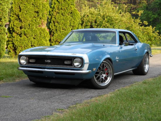

Size:  141.5 KB Mine are GW3's - looks similar.

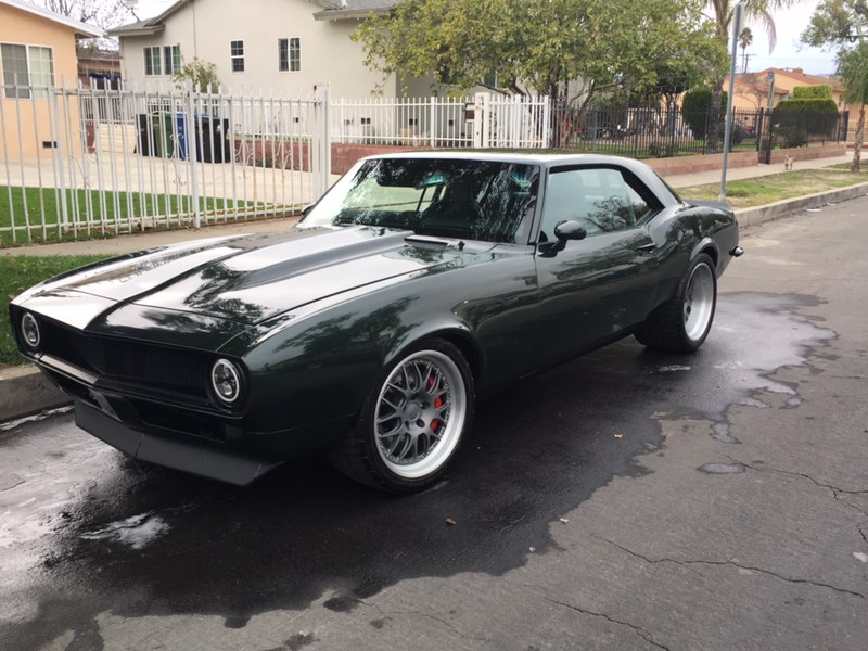

      Yes, yours look great! So many similarities in all these Forgelines. I just need to speak to Forgeline and get an education to be able to order exactly what I want. I need to replace these Fesler's which I like but not what I want long term:

      VX3C yes, Polished outer yes, hidden hardware yes. But I think that is the Graphite finish on the center. See: https://www.pro-touring.com/threads/...ne-VX3C-Wheels

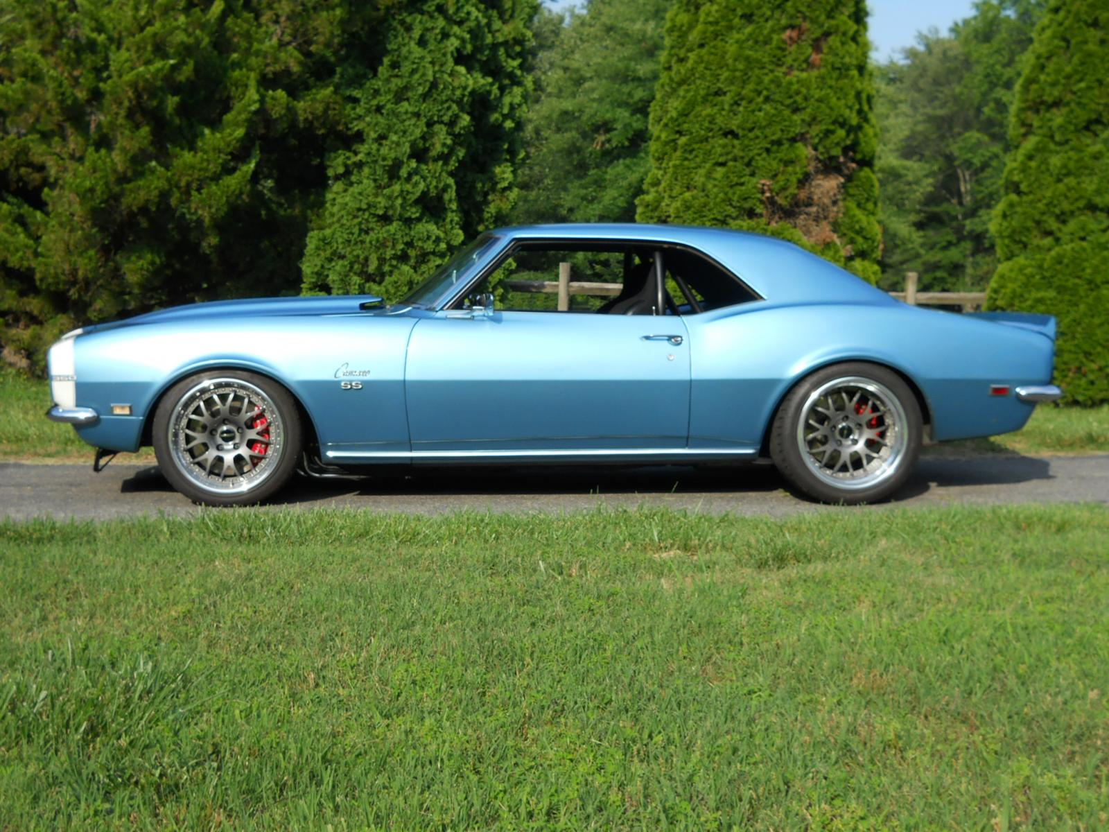

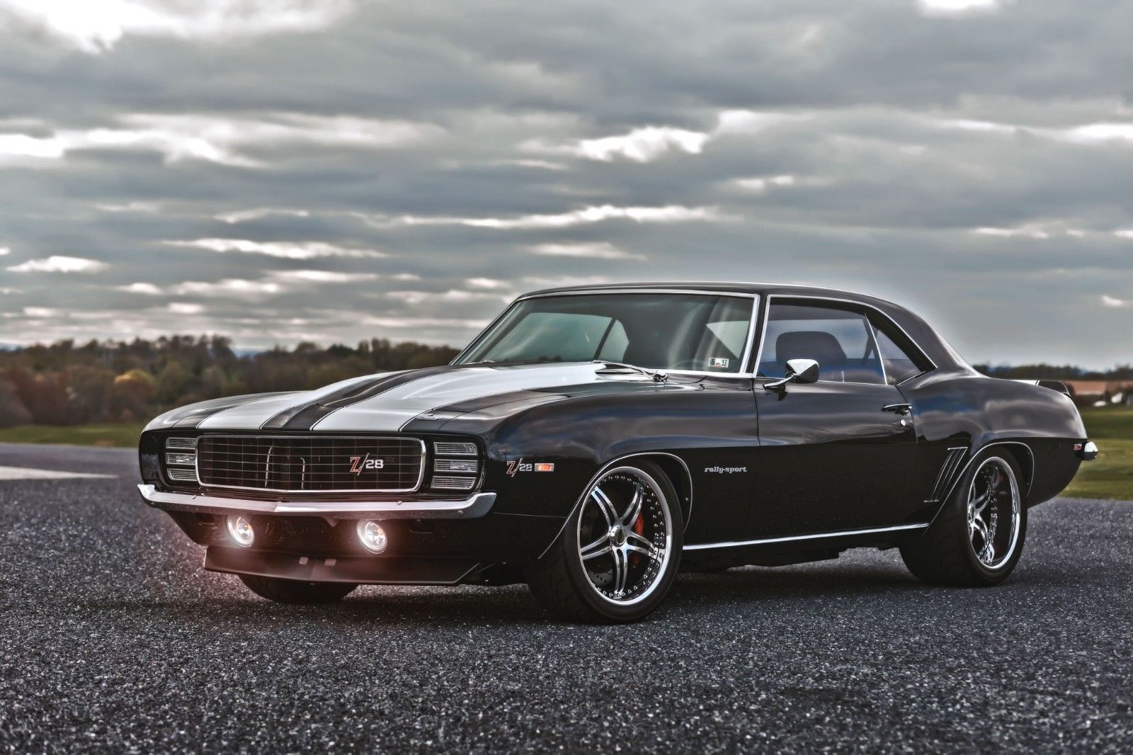

      Those are the Forgeline WC3 Gunmetal center, polished hoops. Like Mark said above, all Forgeline wheels are custom made per order so you need to make sure of your fitment before placing an order.

      The trick is to count the spokes. The WC3 and GW3 are both 8-spoke. The VR3P is a 6-spoke (designed as such so that it could work in 6-lug Dodge Viper applications).
      And then to tell the difference between the WC3 and GW3, the easiest thing to look for is the I-beams along the edges of the GW3 spokes. (The WC3 was designed before we had figured out how to make the I-beams.) There is also a slight difference between how the spokes meet the rim register.

      Not being argumentative here but the WC3 has exposed bolts where the GW3 has hidden bolts. The first pic in the OPs question has exposed bolts making them WC3s same as mine.

      Most of our wheels (including the GW3) can be ordered with either exposed or hidden hardware. The only exceptions are the few wheel models that have a steep chamfer along the face of the rim register. We need a flat surface against which to mount an exposed bolt head, so an angled surface on a chamfered rim register requires a hidden fastener from behind. As long as the register has a flat surface, then we can do either.
      But the WC3 and VR3P are both older designs that correspond with an era when exposed bolts were more common. And the GW3 is a newer design that was created when hidden hardware was becoming more popular. So you're certainly more likely to see WC3s and VR3Ps with exposed hardware and to see GW3s with hidden hardware. But that is a function of changing tastes over time, not design limitation.
