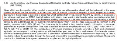

      Hose suppliers are increasingly listing SAE specs, but don't typically explain them. This is a problem as most parts of the US are going to have fuels that have 10% or more of ethanal or other additives and this may increase to 15% with recently announced changes by the president. If you look up the SAE standard you will find hose like Carl pointed to will outgas with 5% additive even though its meets the criteria. The utility of the hose will rapidly degrades at 10% or higher additives -- see below. There is a LOT going on with respect to modern fuels and their effects on vintage cars. I'll be writing about this on the II MUCH Blog.
      "Hose which may be supplied either coupled or uncoupled for use with gasoline, diesel fuel, lubrication oil, or the vapor
      present in either the fuel system or in the crankcase of internal combustion engines in small engine applications. Exposure of these hoses to gasoline or diesel fuel which contain high levels, greater than 5% by volume, of oxygenates, i.e., ethanol, methanol, or MTBE (methyl tertiary butyl ether), may result in significantly higher permeation rates than those listed for 30R14. "
      Attachment 160391

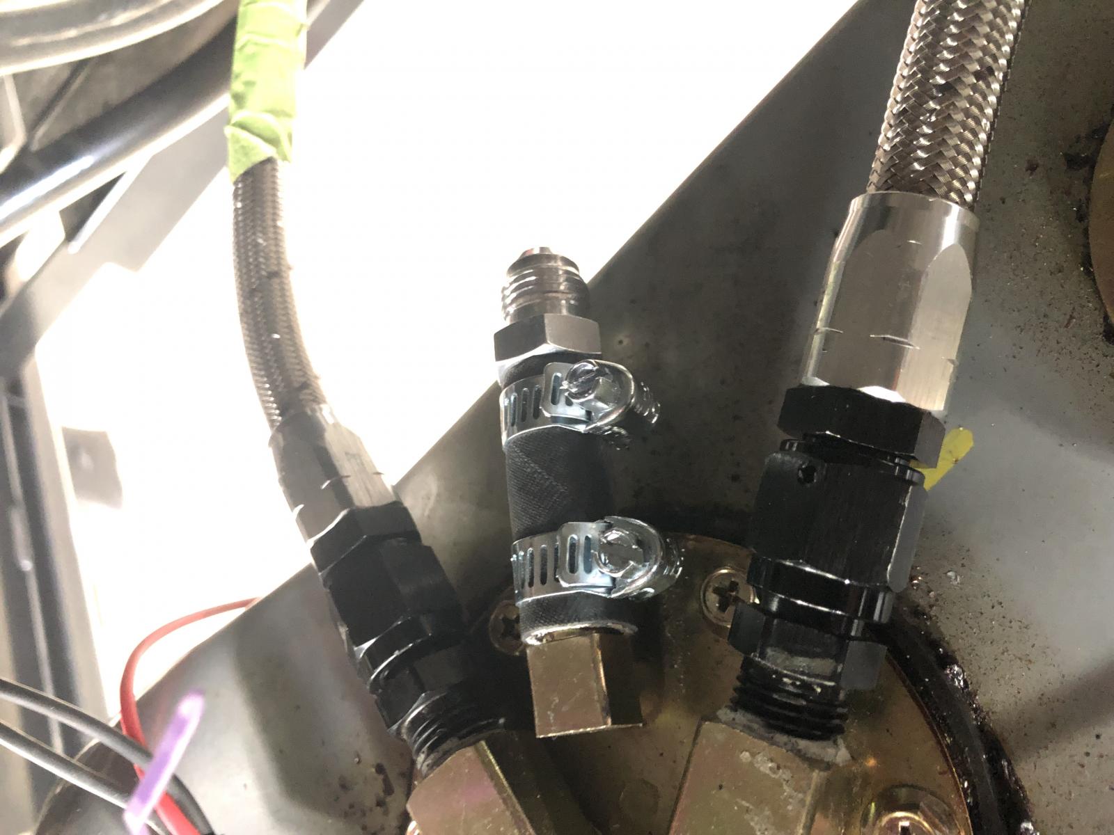

Size:  163.2 KBLike others stated here was my solution....
