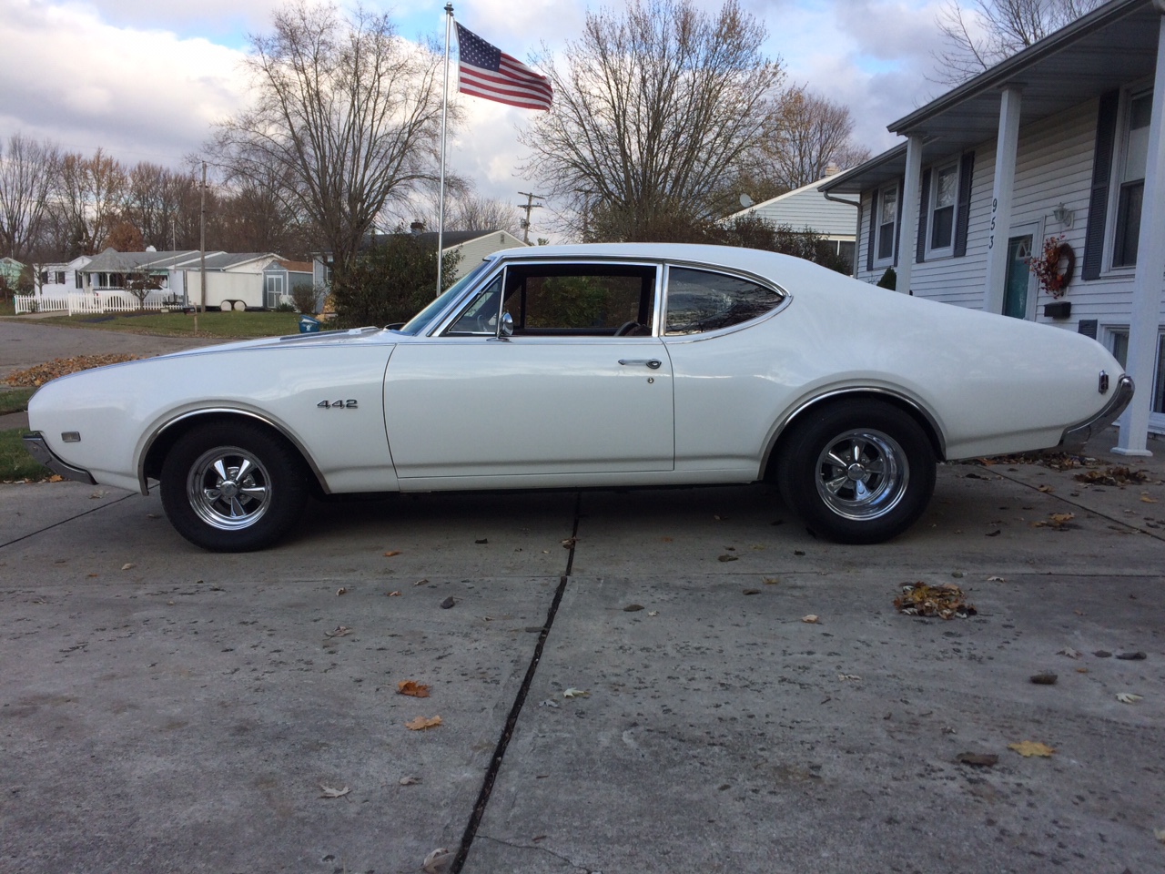

      Hey guys, new to the forum. Looking for advice on wheel and tire size for my 68 442. Wondering if this will work without any rubbing. All new stock height suspension.
      Front: 17x8 zero offset with 245/45/17
      Rear: 18x9 zero offset with 275/40/18 or 275/45/18
      Will 285 fit on 9” rim and zero offset?
      Any ideas or advice appreciated. Thanks.

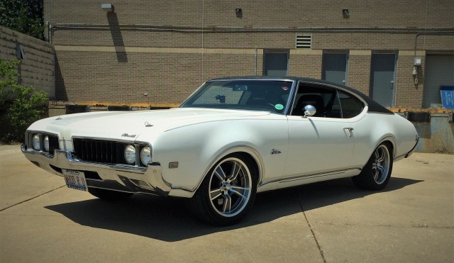

      On my 1969 Cutlass, I have 18x9 front and rear with 255/40 and 285/40, lowered a good 2-3 inches as well. Only slight rubbing at full lock going over curbs. For these Olds you can't listen to any advice about what fits from in the back from guys with 70-72 cars, as those years have more room in the rear wheel well opening.

      A 285 could fit, but a 275 is just easier.
