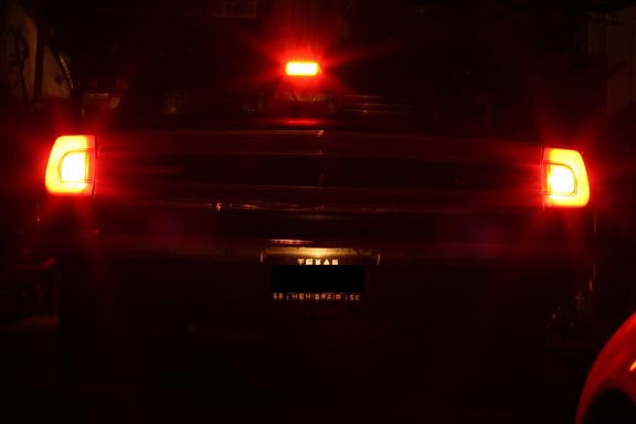

      I'm having a hard time getting something that doesn't take away from the classic aesthetics at the same time. I agree some improvements are needed, and they are safer, but I want to retain my classic car look.
      I've thought about adding a flasher setup to my tail lights to pulse them 3x quickly before going solid. Not uncommon on motorcycles.

      It only flashes 2 or 3 times till it goes full. RED.
