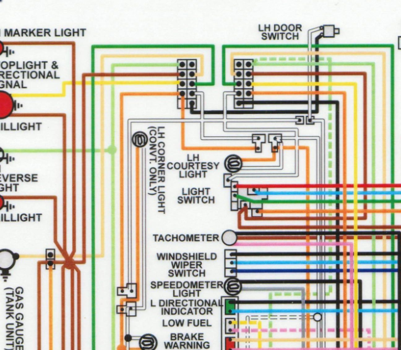

      Old post, new question:
      My 69 camaro came to me with new headliner and dome lamp that appears to have the orange/white wires going from it to somewhere.
      The rocker switches do not have any wires.
      Schematic mentions trunk harness connection point.
      Fuseblock/harness was replaced at some point.
      Any idea how I should wire the rocker switches in (understand they ground to complete circuit when doors open). Where do I find power, and where does it go?
      Thanks and sorry not a more exiting question...
      Oct 2015
      Western Mass
      227
      This schematic might help. Looks like the DS (Left) door switch should have a black and a white wire, the PS (Right) door has a white wire coming in from the other side, the other lead goes to the courtesy light.
