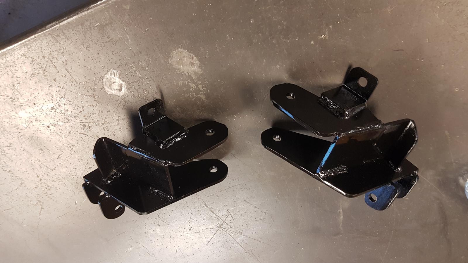

      Well was finally able to make up some prototype brackets they turned out ok but may still add another bolt tab but wanna see how this setup will work than spend time building a nice set. Have the car set to the ride height I want tires are tucked nicely in the wheel wells hopefully won't have too much body sway as I think there's about 1/2 inch clearance inside and out of the tires. Thanks for everyone's input I like being able to put my tools to use! Here's a couple pics before putting on car, I'll try getting some on car pics if anyone's interested Name:  20200107_154435.jpg
Size:  159.8 KBName:  20200107_154420.jpg

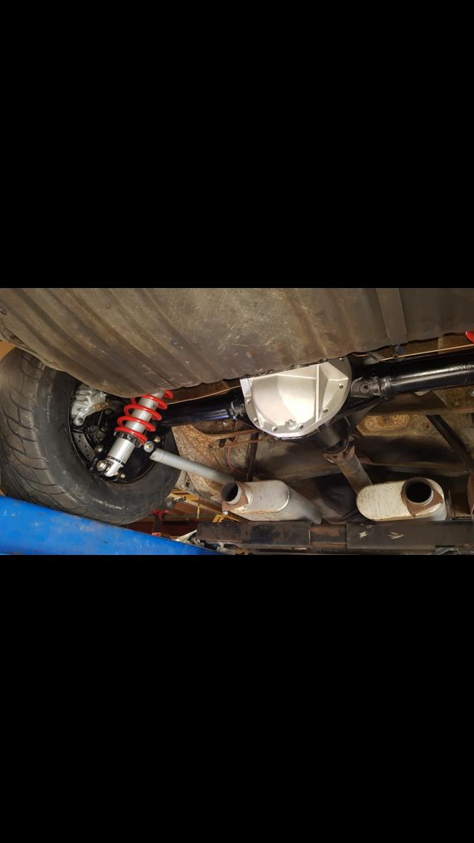

      Rear suspension is all done and back together probably lowered it a good 3" from where it sat with the old ladder bars. So far driving is night and day from what I started with and am very happy, brackets worked out good so I'll probably just leave as is
      Still can't figure out why some pics are upside down lol
