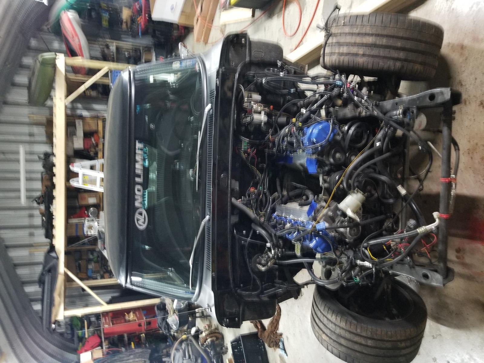

      The last picture is the engine before I took it all apart.

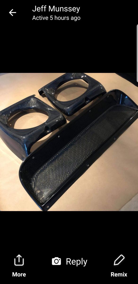

      These are the headlight bezels and gauge cluster from Munssey Speed and Design going on my truck.
      I've got 2 grills. One is a almost new reproduction grill and the other is decent.
      I can't decide if I should hydrodip a grill in Carbon fiber to match the carbon fiber bezels or just paint it black or leave the polished grill in to accent the bezels?

      Personally I'd go option 1 and hydro dip. My 69 had a brushed original grill and it looked amazing, but yours would stick out like a sore thumb without any other real polished items. Plus everyone loves murdered out hot rods.

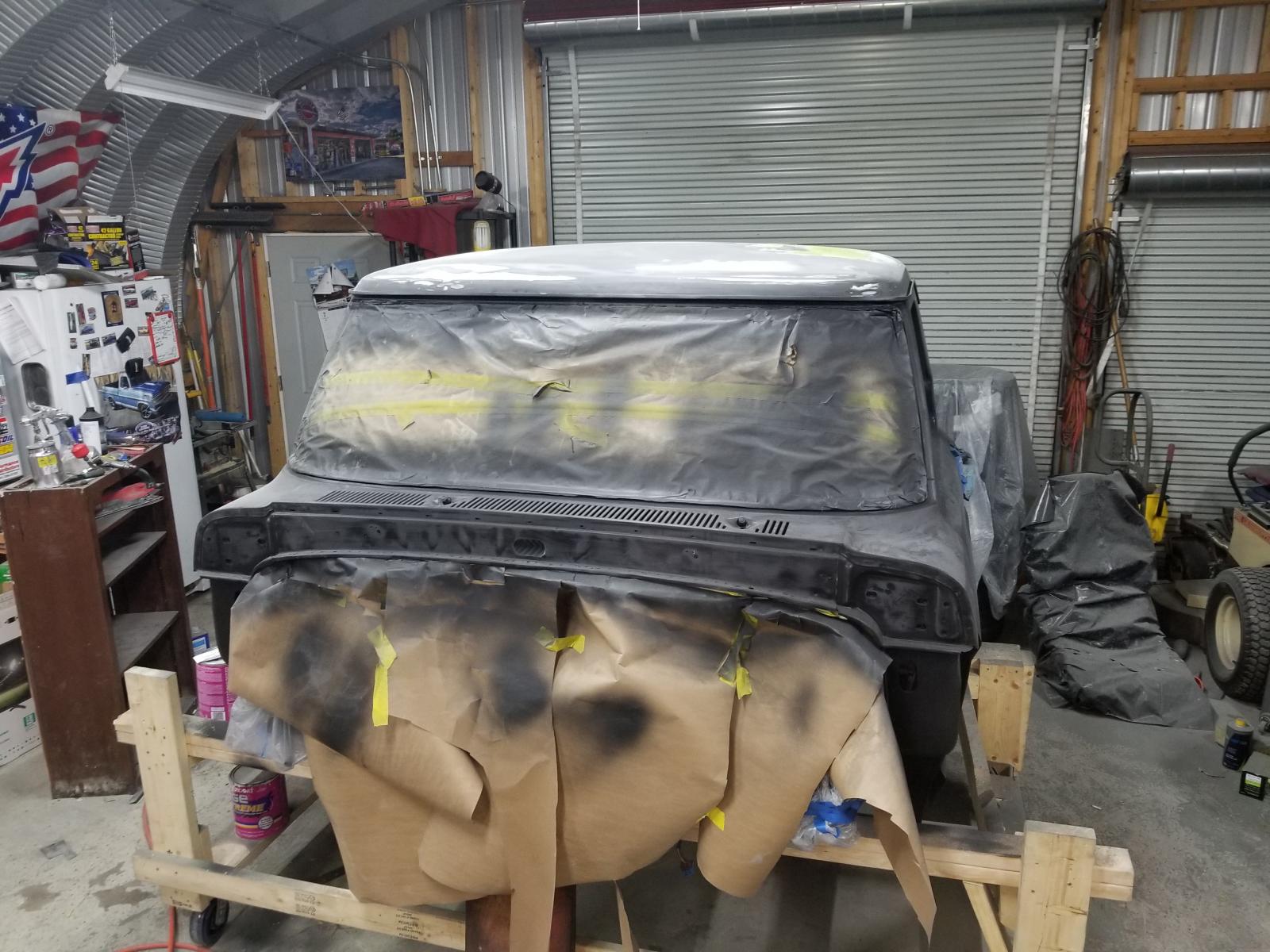

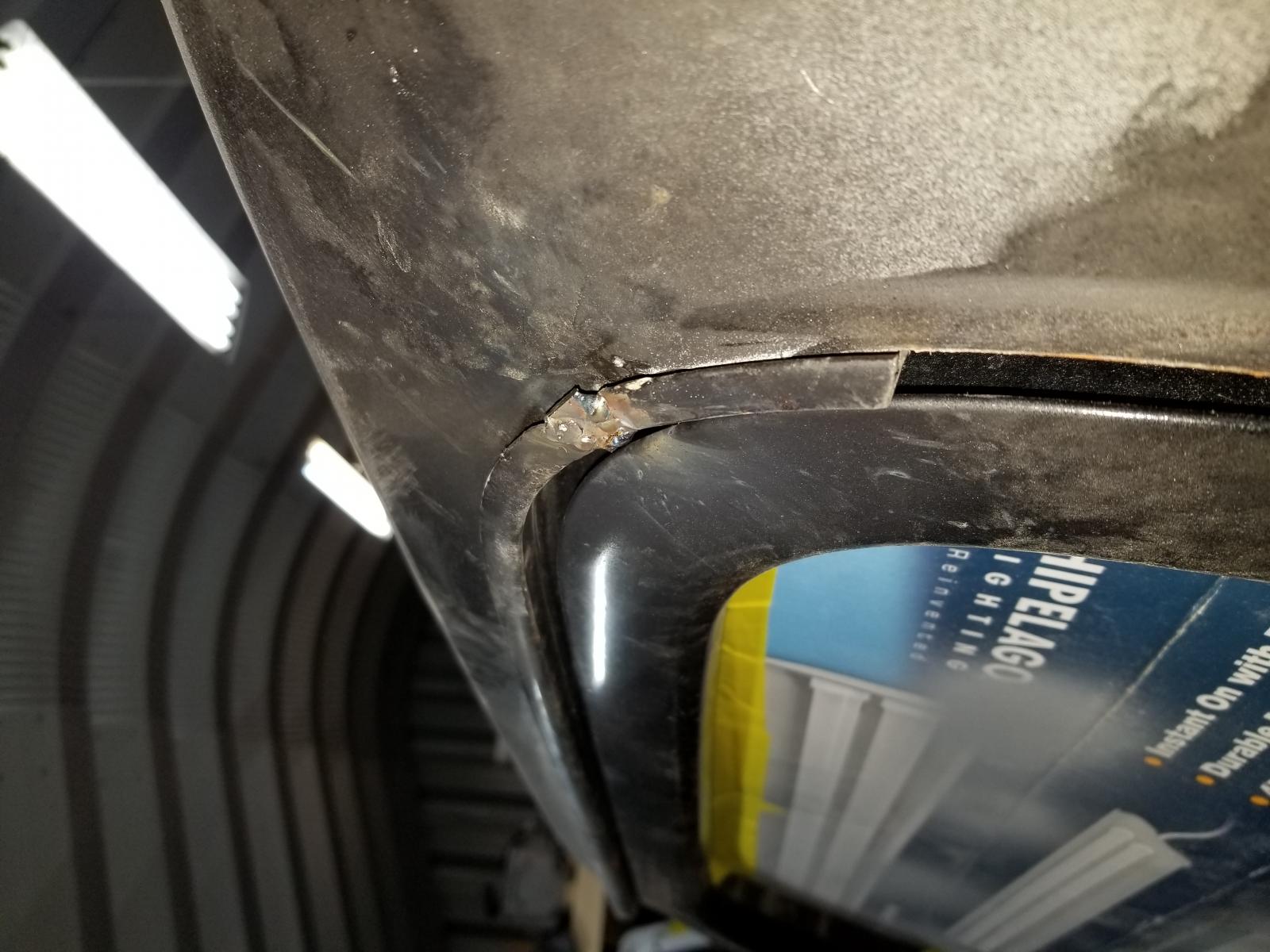

      Paint was very thin on the cab. I sprayed epoxy primer on the bare metal spots. I hate sanding this stuff.
      I welded the cab seams so that created more filling.
      Hopefully I'll get it to the 2k primer in the next day or 2.
      I still have a little filler left after all this welding metal.

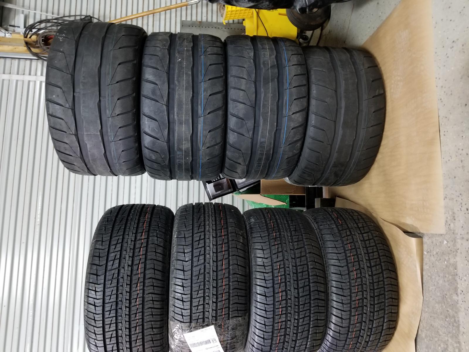

      Tires came today. 335/30 compared to 295/50.

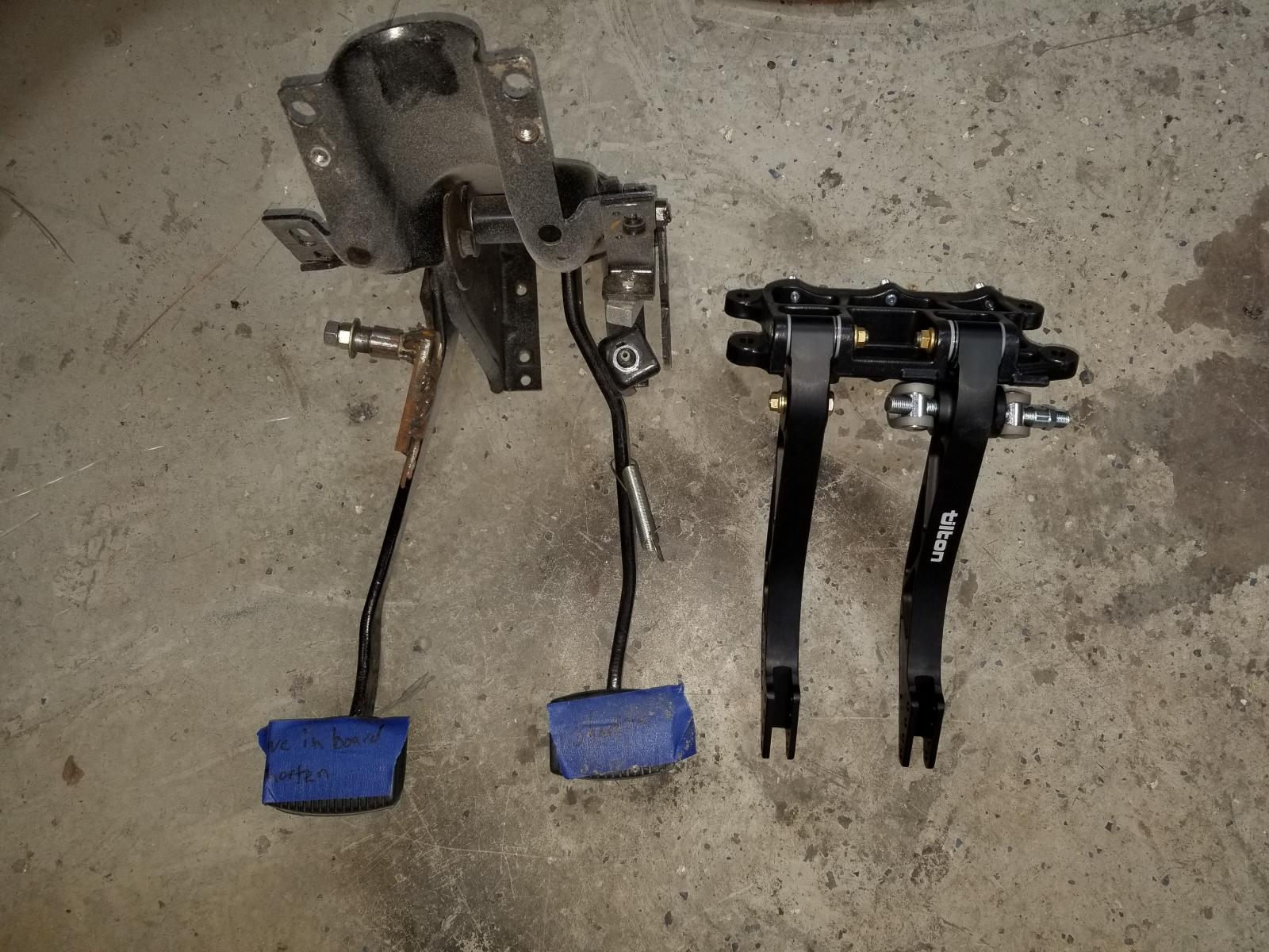

      I finally got the Tilton pedals and there everything I expected. Atleast 15lbs lighter than the factory pedals and there closer together.

      My cab is ready to block sand but before I paint the cab I'm going to mock the Tilton pedals.
      The firewall is weak from the factory. I had a piece of 3/16 steel behind the dash supporting the factory pedals. This time I'm cutting a section of firewall out and welding a thicker piece of sheet metal and a doubler with some bracing. My spot weld cutter broke. I cant believe the factory put this many spot welds in.

      I have the pedals mocked up and A doubler on the firewall tacked in. I decided against cutting the old firewall for 2 reasons. 1 it a template to drill existing holes that will have to be drilled out and 2 it has a tiny bit of support.
      I think I'm going to make another doubler but smaller for inside and a 3/16 plate for the under hood part of the firewall. Then I have to come up with a way to support the pedals to the steel lower part of the dash.

      The new pedals are 3 inches shorter just like I wanted.
