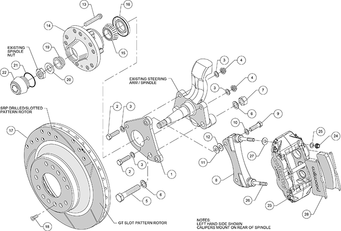

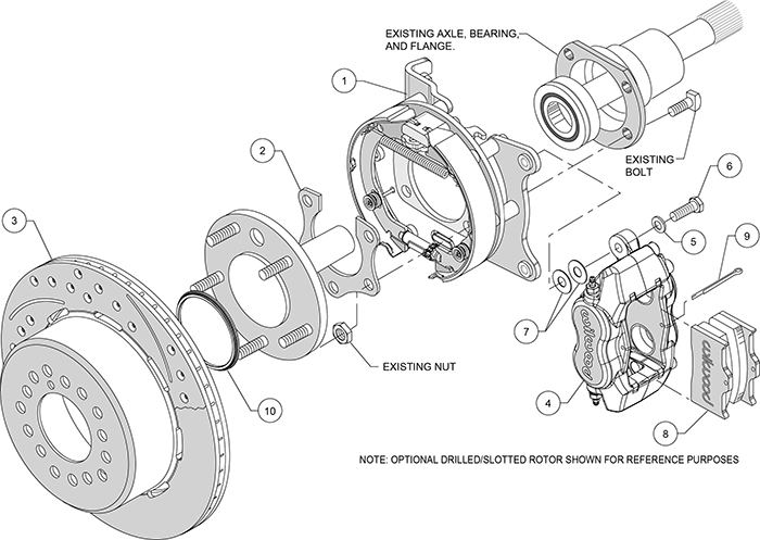

      I've been avoiding diving into my pad knockback condition with my Wilwood brake setup. The car stops great, but after any mentionable cornering I have to check-up the brakes. This wouldn't be so bad on a purpose build road course car or something, but I would like to improve it on my street car.
      I've not seen a robust way to cure this without dragging the brakes constantly [springs, check valve]. So I'll ask, has anyone seen a reasonable conversion to float these Dynalite calipers? I have limited access to a mill and lathe, if needed.

      Adding some more color:
      As I have read, most situations tend to step from overly loose bearings of some sort. I should likely first isolate which axle is the most problematic by side loading the car and coasting to a stop. I suspect the rear is more of the problem, but I am not certain. The retainer plates (2) are not very robust and just have a small notch in them for the bearing to push against. From what I recall, there was some axial slop upon assembly. The only real remedy I can think of for that is to machine/sand down the retainer step, in order to force a tighter rear bearing pre-load.
