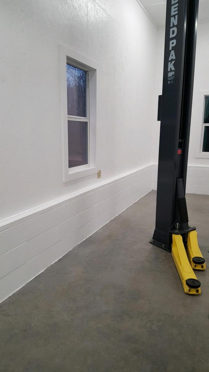

      Building an extra bay for the lift.
      - - - Updated - - -
      Bendpak 10AS delivered
      - - - Updated - - -
      Extra depth concrete to approximately 18-20" in depth. Rebar and wire was also used here
      - - - Updated - - -
      Slab poured
      Nov 2018
      Winston Salem, NC
      94
      Used 10" 304 stainless dowels epoxied in, instead of the 4" that came with the lift. We also braced it off at the top to the trusses in the ceiling.
      - - - Updated - - -
      Setting it all up
      Nov 2018
      Winston Salem, NC
      94
      Almost done
      Nov 2018
      Winston Salem, NC
      94

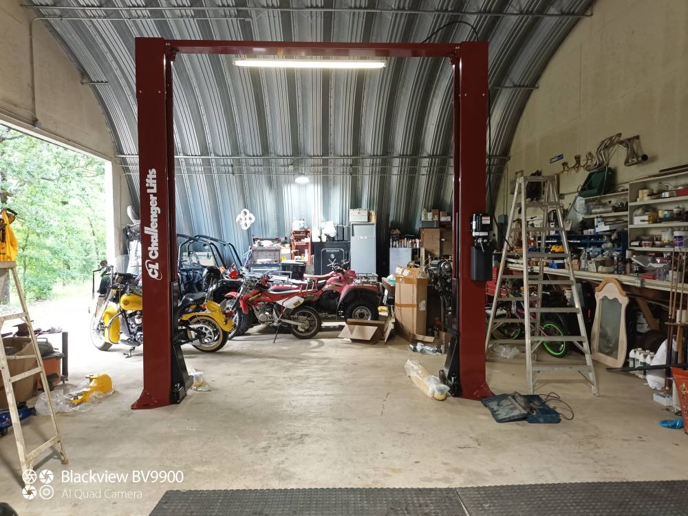

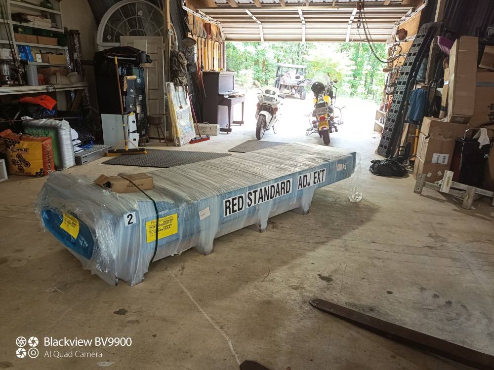

      Sep 2017
      839
      My new Challenger CL10V3.
      Just got to wire it up.
      Man I'm glad my car is parked in it LOLName:  IMG_20210523_143958.jpeg
