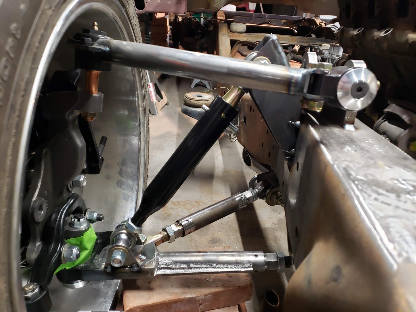

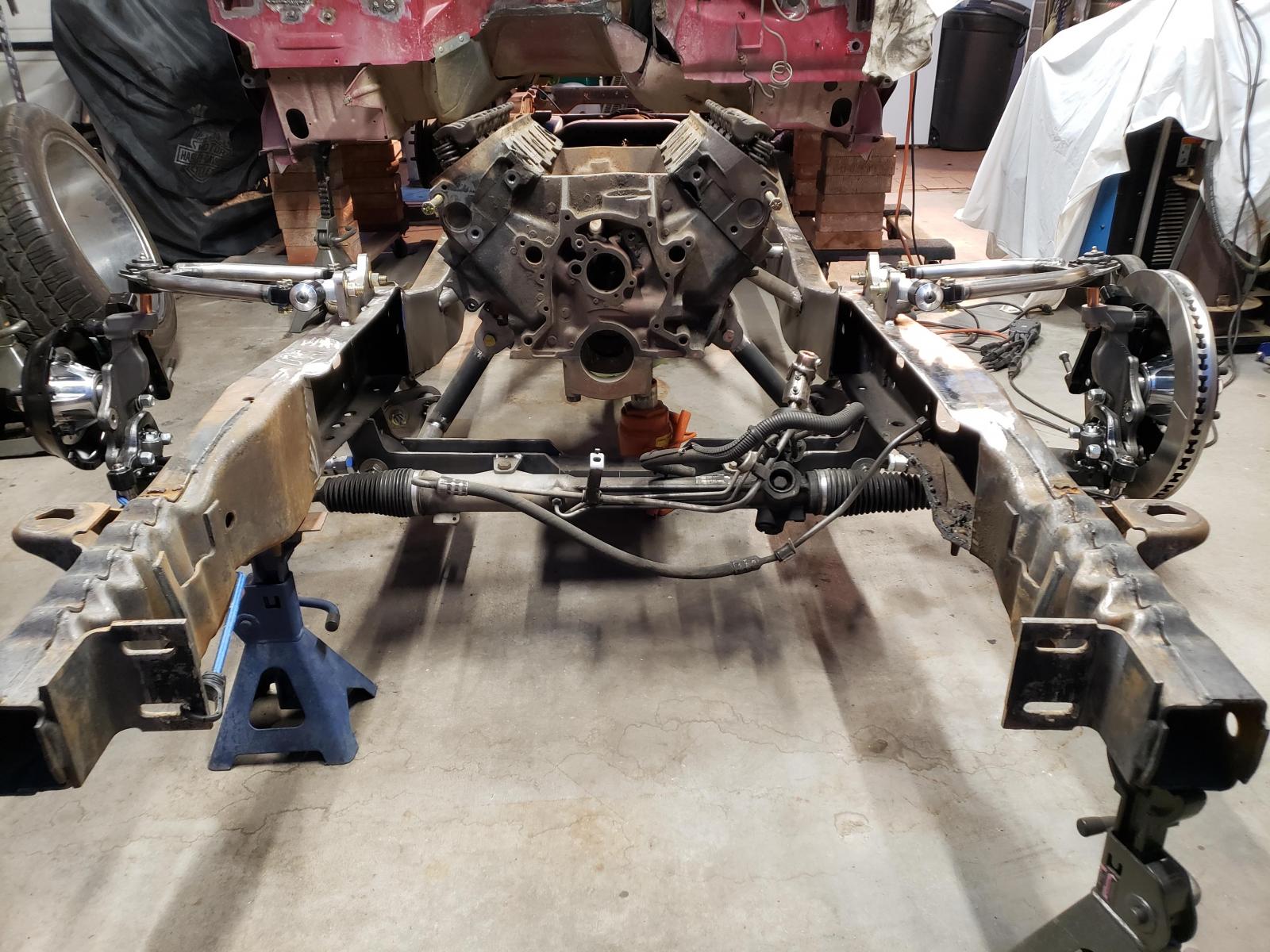

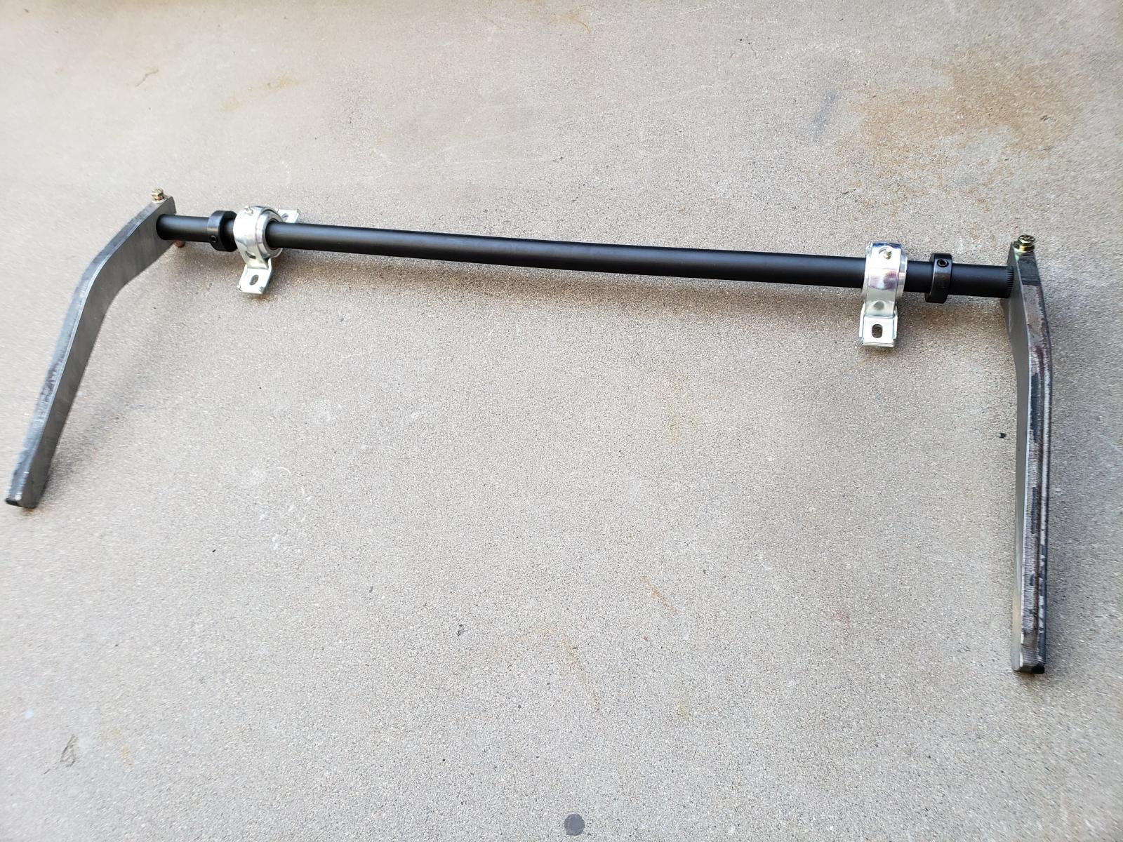

      Alright we are finally back to where we were a couple month ago! Just kidding....we are way better off than the last setup. I LOVE the new arm arrangement and feel much more confident in it's functionality.
      Lower arms are missing one weld, the shock mount, and paint before they are 100% complete. Upper arms just need paint and I will have to final weld the A-plates that they mount to. I breathed a big sigh of relief last night as I locked up knowing that this is finally going to be done.

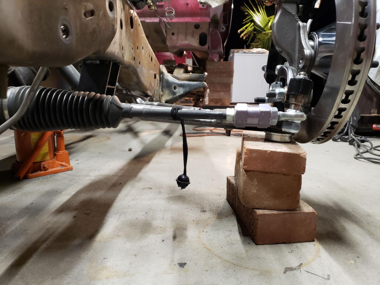

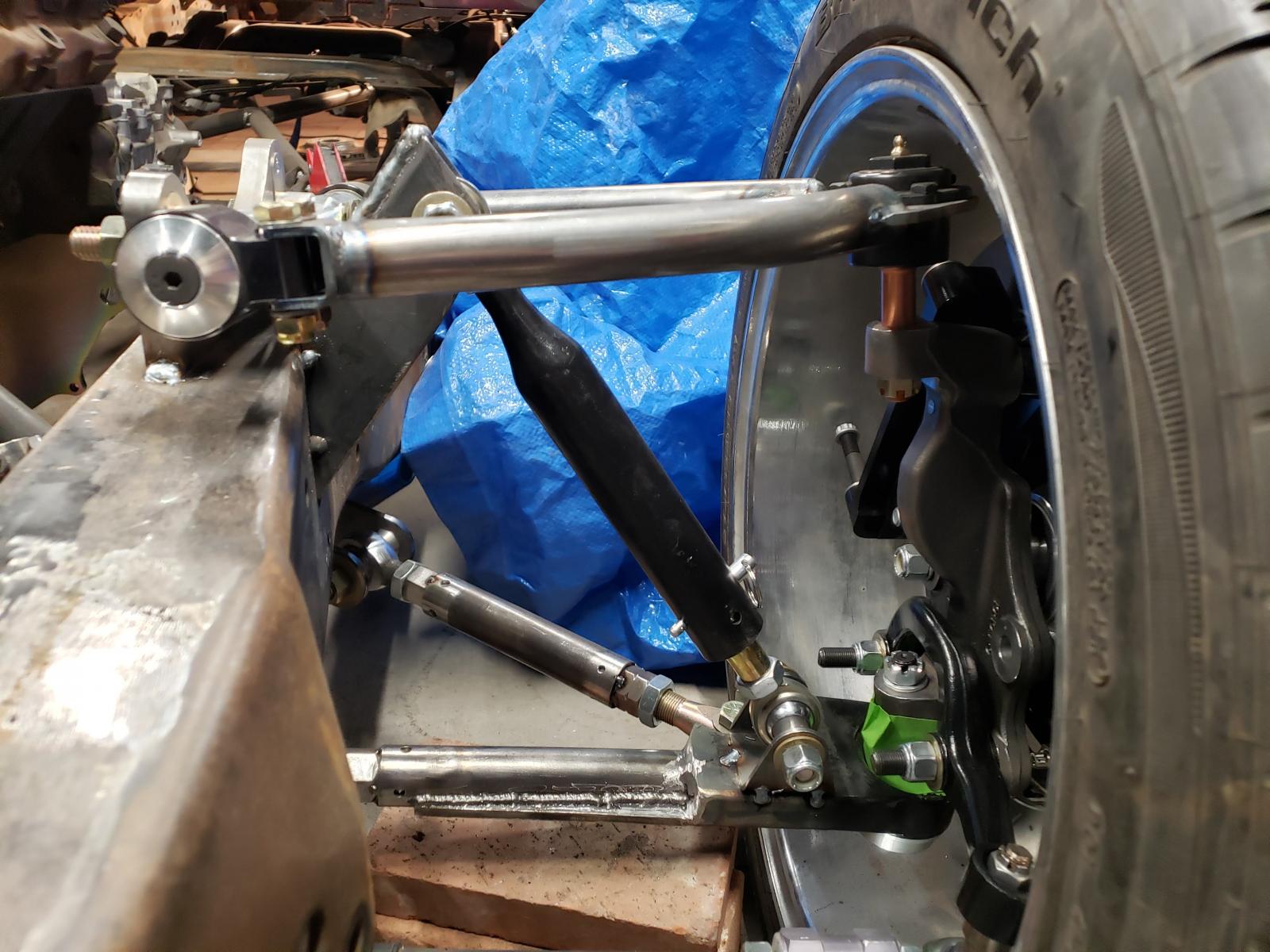

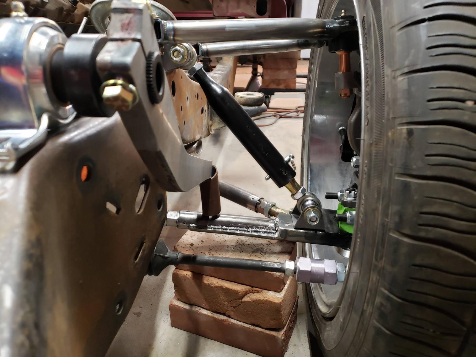

      Final specs as it sits are: 0 degrees of static camber, 7 degrees of caster, and 8.5 degrees of anti-dive. I can add a ton more camber and caster should I choose. In 3 inches of wheel travel it gains 1.2 degrees of camber. This only requires 2 inches of shock stroke as best I can measure right now.

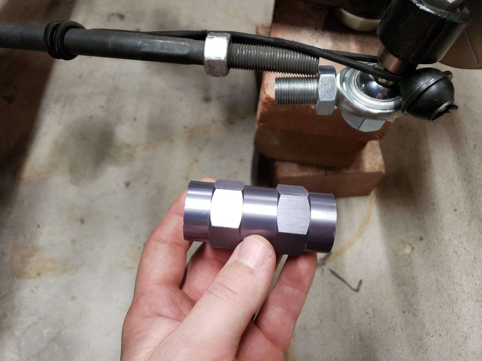

      As I mentioned in my previous post I have been trying to figure out how to address the tie rods since these GM based spindles were never supposed to work with this S197 front steer rack. I believe I figured it out! First I had to test with parts on hand.
      Little trimming here and there and I ended up better off...
      But you can all see the gross amount of bump steer. Fear not, I am on it! There is actually 2 issues with this right there. 1, I have no adjustment range left and I'm fairly sure it has some toe out (going to try and check later). 2, the tie rod angle has to be fixed asap. I just got off the phone with Flaming River (love those guys) and they offer an inner tie rod for this rack that has double the length of threads. So I'll just cut them down and I will then have adjustment to fix the toe. Those will be ordered right after I post this. To fix the other issue will require me to make a new rack mount that moves it higher because I don't have room inside the wheel for a longer stud on the steering arm. Hopefully I left enough room around the oil pan to be able to move the rack. Fingers crossed.
      What do you all think? Did I miss anything or do you have any suggestions here?

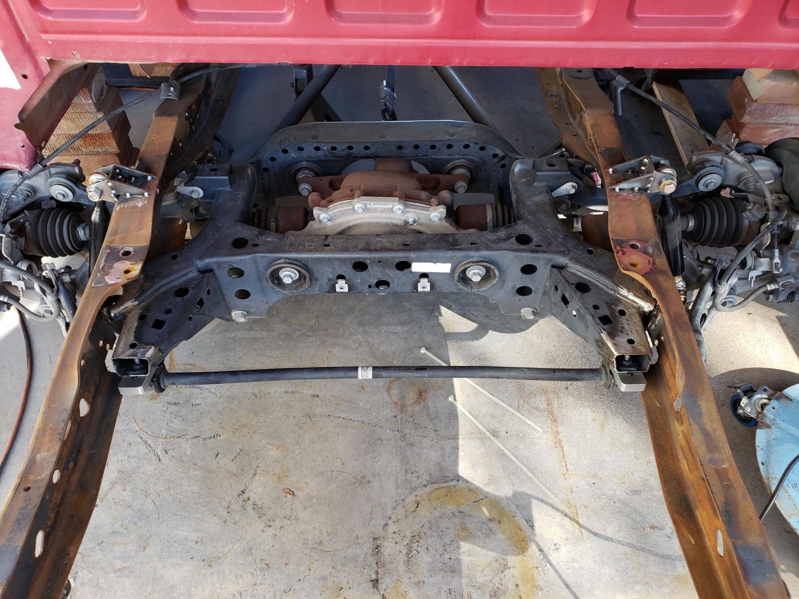

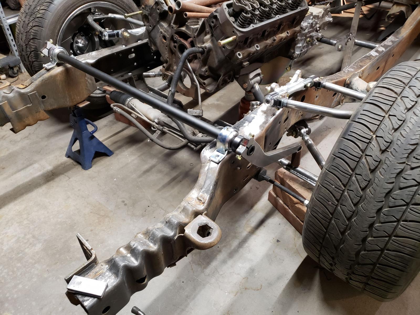

      Installed some little parts on the rear suspension to start prepping to do all my shock mounts. Pretty exciting to think it can support itself soon. It's been a while. I didn't get any photos of that so you will all just have to wait.

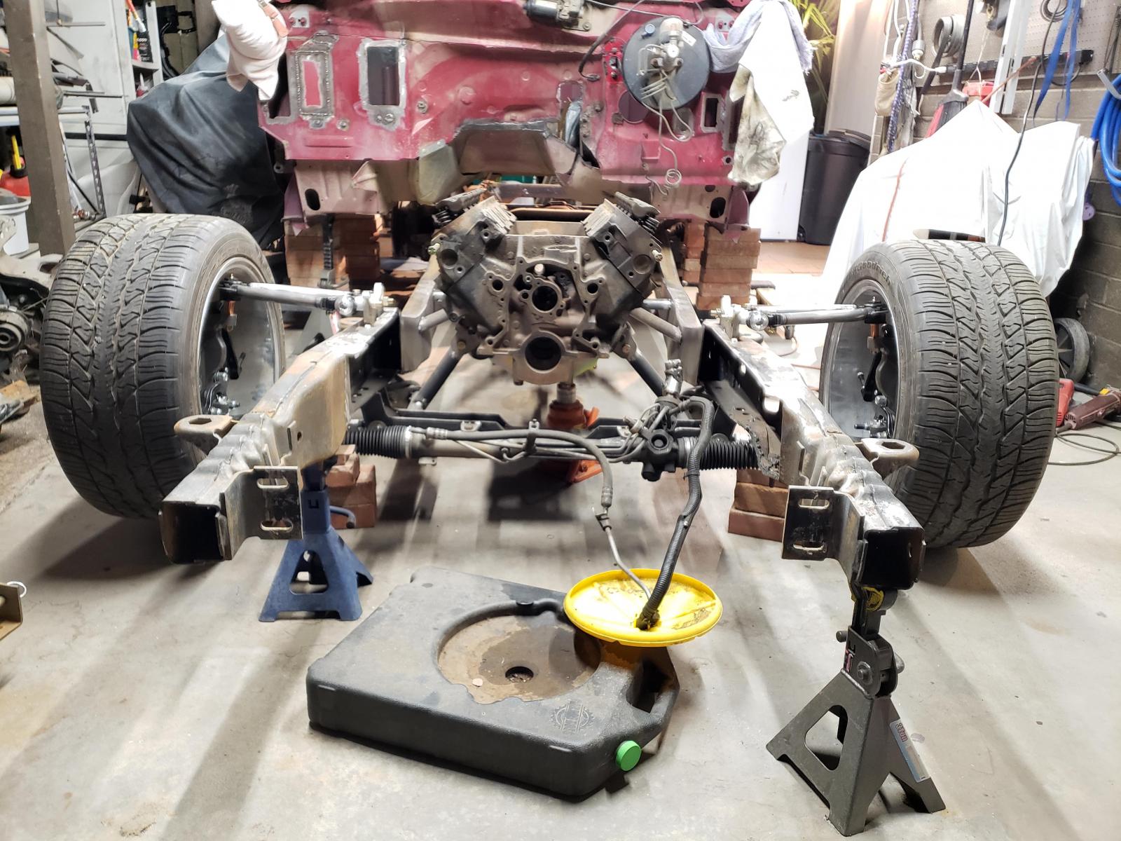

      Something else I did was check tire clearance from lock to lock. Dang I've got some angle!

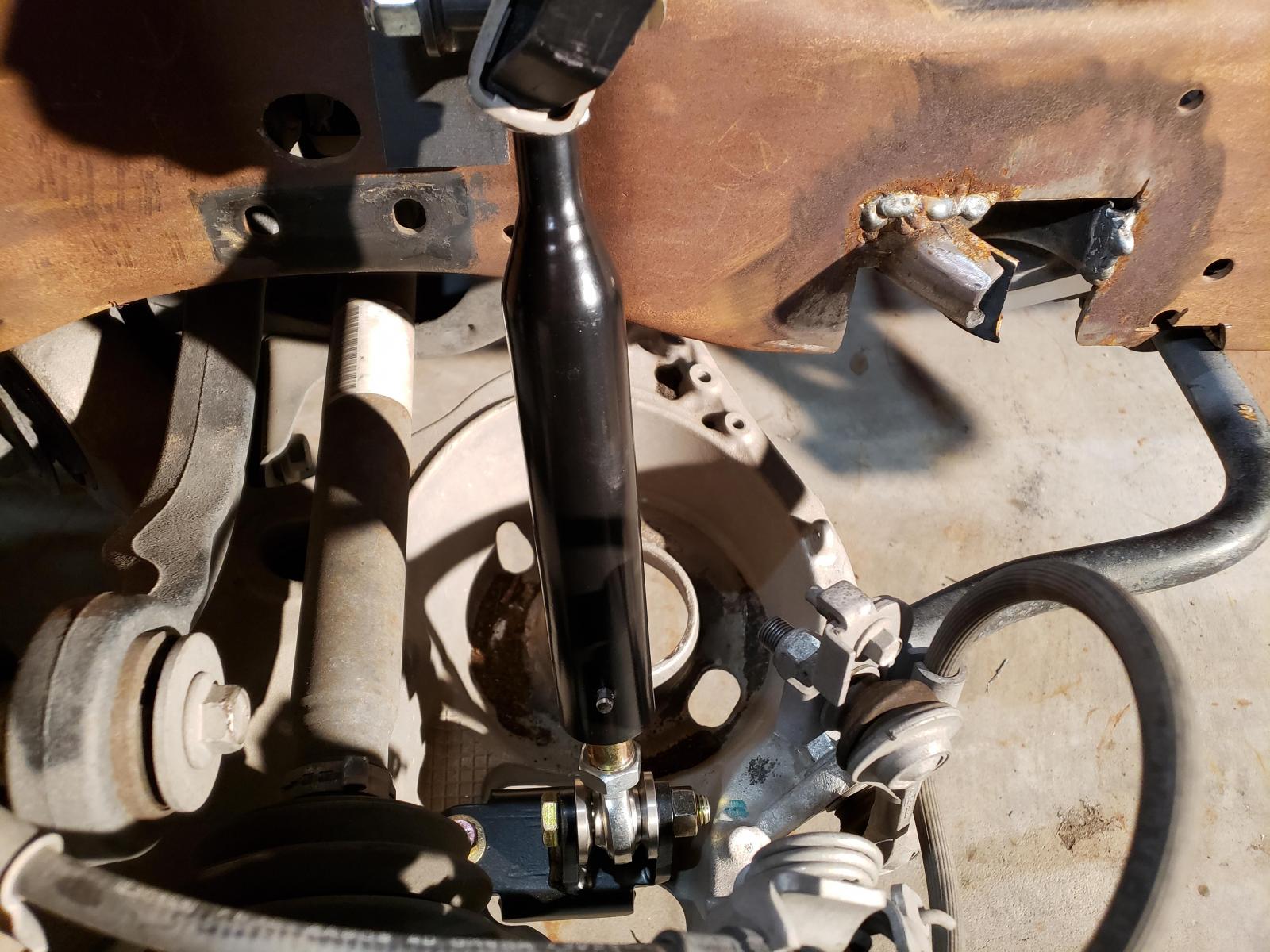

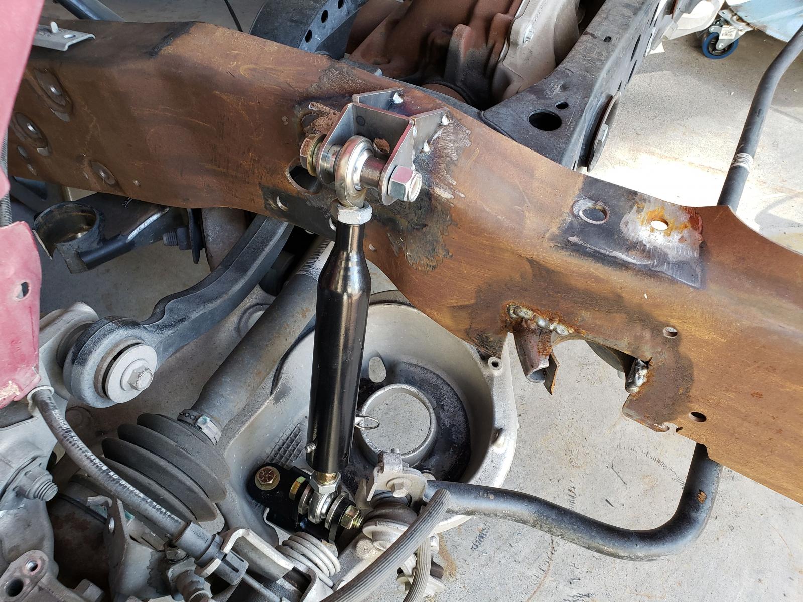

      Little more work on the truck and a new part to finish up front suspension fab. Yes...I know I keep saying that, but I do need a sway bar. Shoutout to Speedway Engineering for this one. They aren't a sponsor, but I chatted with them back at Goodguys Scottsdale and just got around to calling to see what we could do. They are incredibly nice and knowledgeable plus their prices are VERY fair. I looked at a ton of options and they ended up being the cheapest and best fitting somehow. This bar with this length of arms is 375lbs of resistance (I think). I can go up to like 425ish if I recall correctly. Right now it's purely guessing on my part so I left room to go up or down in stiffness.
      Not sure where to mount it yet. I'll probably be better off mounting it under the frame rails. Also, should I bend the arms out toward the lower shock mount? My brain is telling me that it won't be very effective this far toward the pivot point on the control arm. I can ask the neighbor to bring his torch and try to bend it out somehow.
