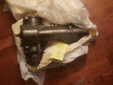

      Christmas! Well, one of the many good things that come out of being born into a car family, you get parts for Christmas, birthdays, etc. This year I was lucky enough to get some pretty cool stuff for the beater: Got a Detroit Truetrac, Champion 3 core radiator, and a Tuff Stuff high flow aluminum water pump.....still waiting on my Fuel Command Center to show up, but I'll probably end up tackling all the projects at once now. The FiTech has a control for electric fans, so I'll be ordering a full set up with shrouds after the 1st of the year.

      Nice! You're 100% right about car families being great at Christmas. I have a similar champion radiator for my project. I bought the set with shroud and 2 electric fans for my 4 row. I bet they make one for yours too. Seems like these are pretty well made. Looks like you have plenty of work to do. Fun!

      Thanks! Yes, pretty lucky as far as family goes. I've got Champion radiators in all my stuff, they're top notch. Fit like stock. I was going to get their fan kit, but they only have duals and I'm going to try to find a single 16" first instead of running two smaller ones. I'm a little afraid of voltage draw between running my FiTech, Command Center, stereo, headlights, etc. with dual fans. We'll see what I end up doing, because it'd be nice just to buy the kit Champion sells for shrouds and fans and just bolt it in.
