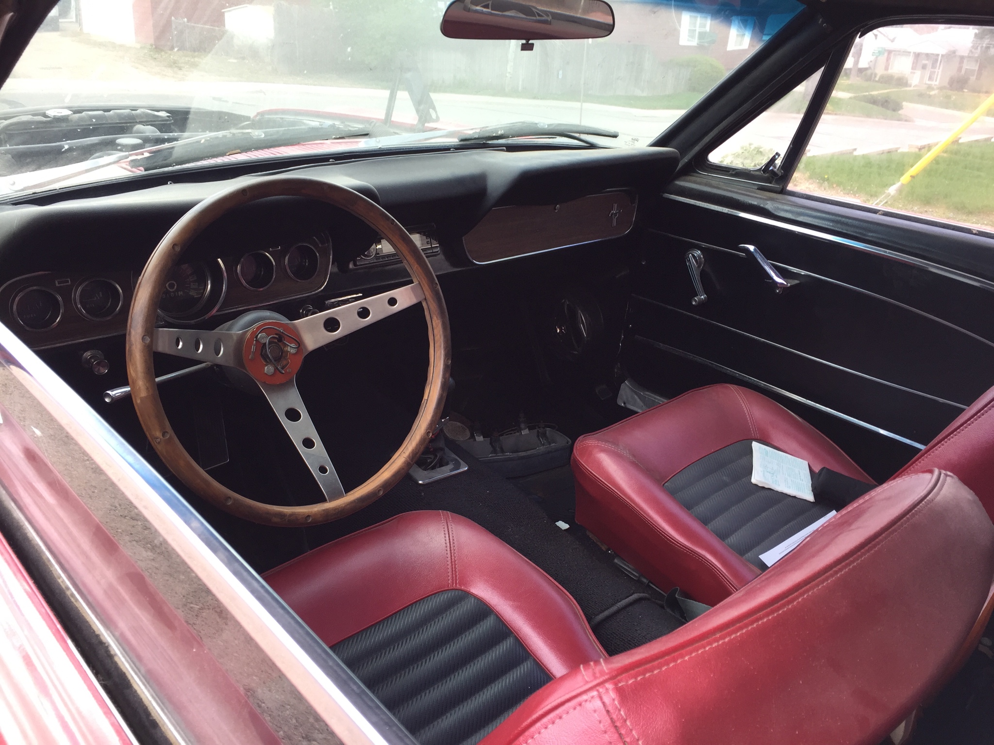

      Here's one of the earliest photos I can find of the car, still in my parents garage.
