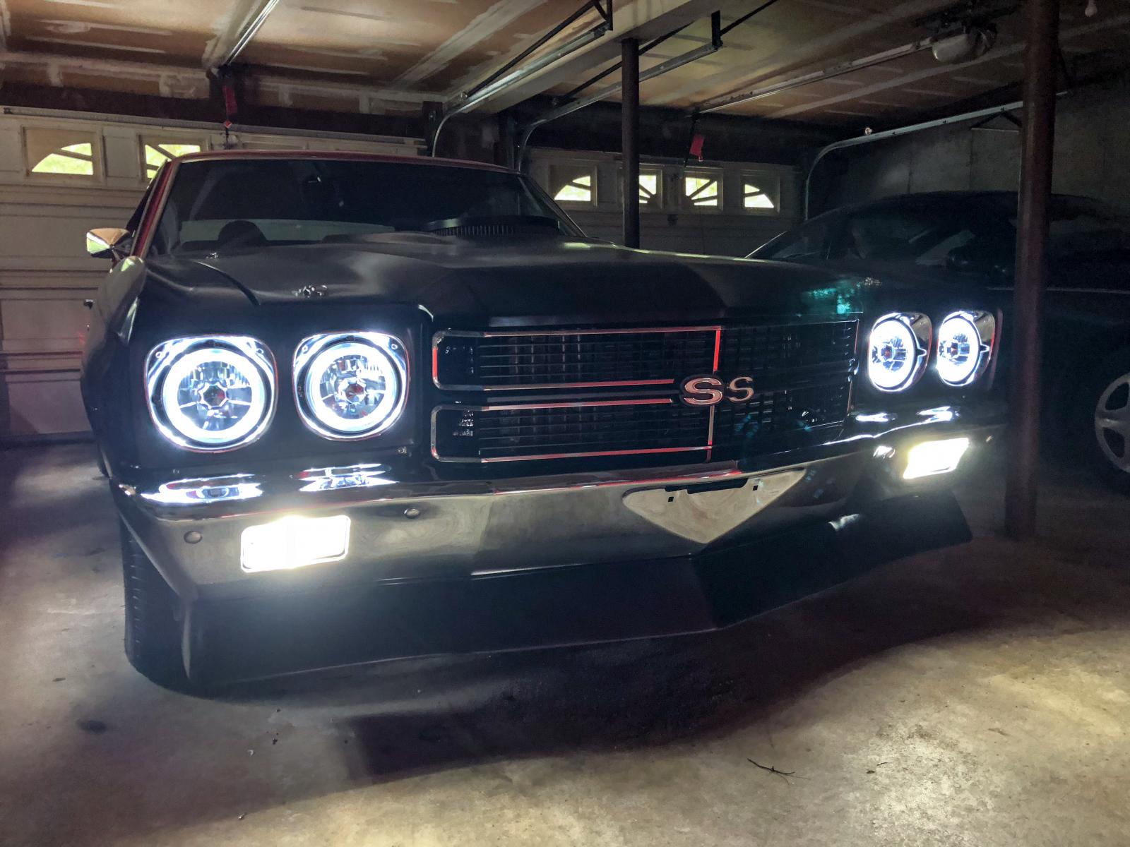

      I just finished upgrading my headlights last week. I’m running octane lighting’s led halo headlights with led conversion kits for both high and low beam. I also changed the parking lights to switchback leds. This pic is just with the rings and parking lights on.

      I like those obnoxiousSS. I like the white halos. Do you know the part numbers?
      My current lights are terrible and when I turn on the brights they lights flicker.

      Yup, if you go on octane lighting’s website the product ID is 11678. I drove my car at night for the first time and realized how bad the stock ones were. I wish I upgraded the headlights a long time ago. At least now there are tons of LED conversion kits out there to chose from. I got my kits off of Amazon and everything was plug and play.
