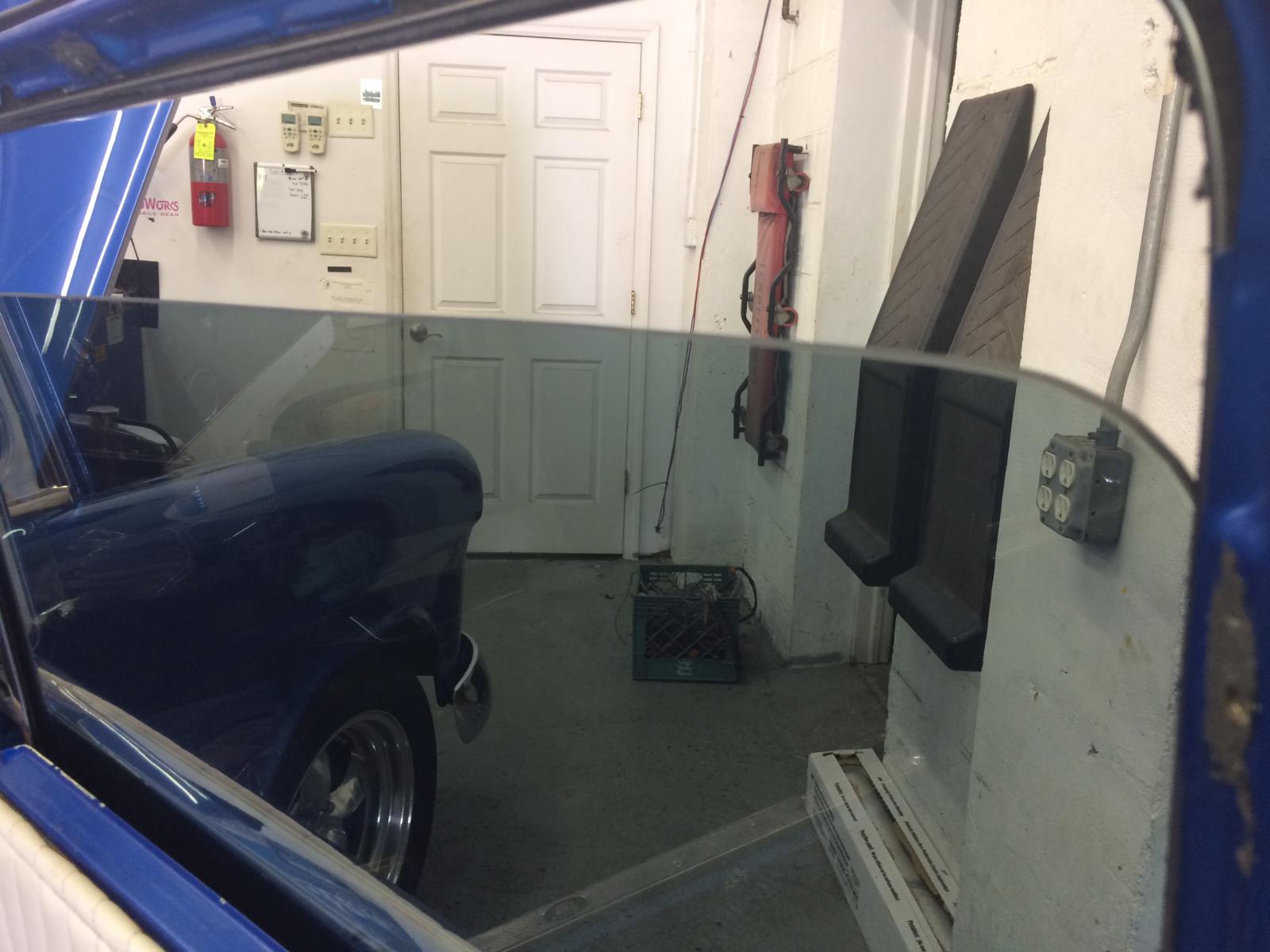

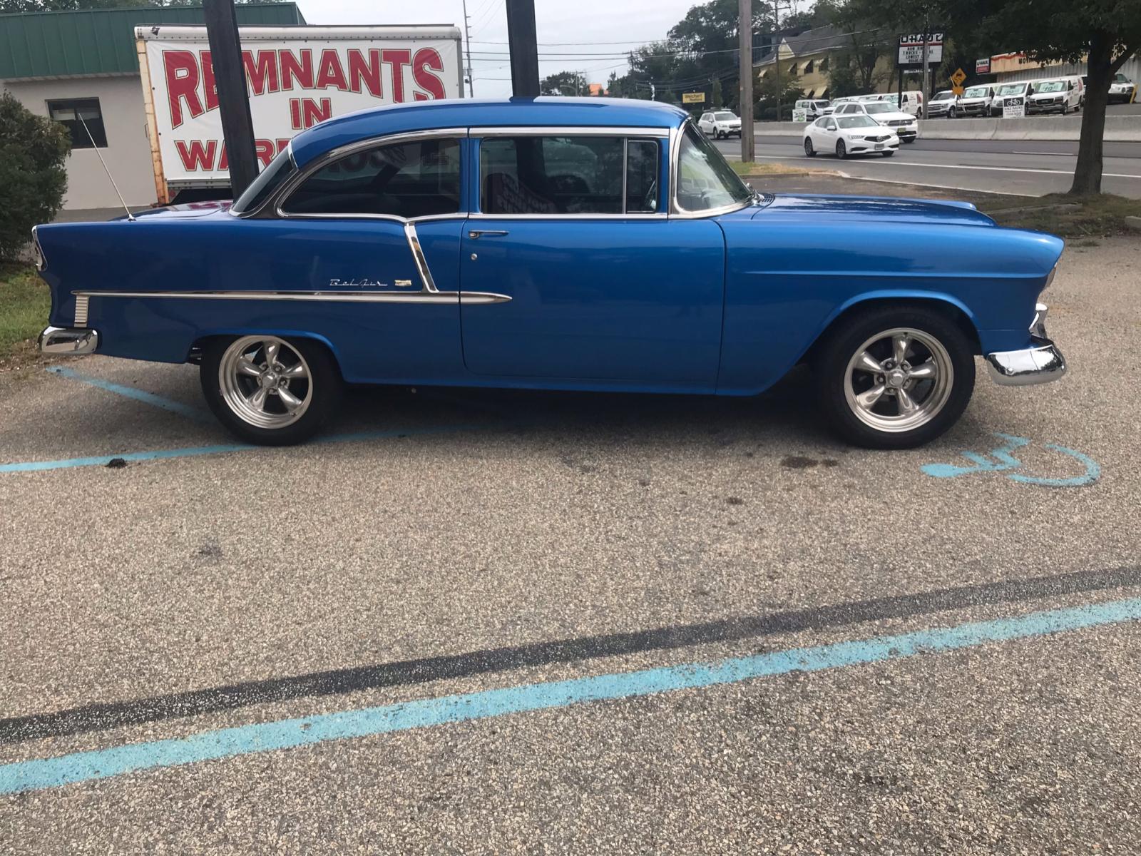

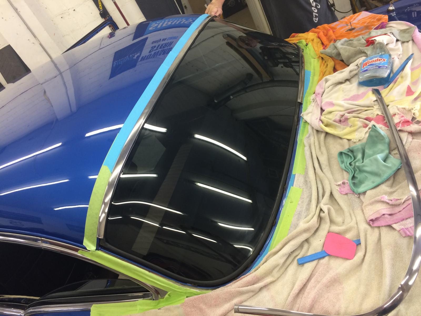

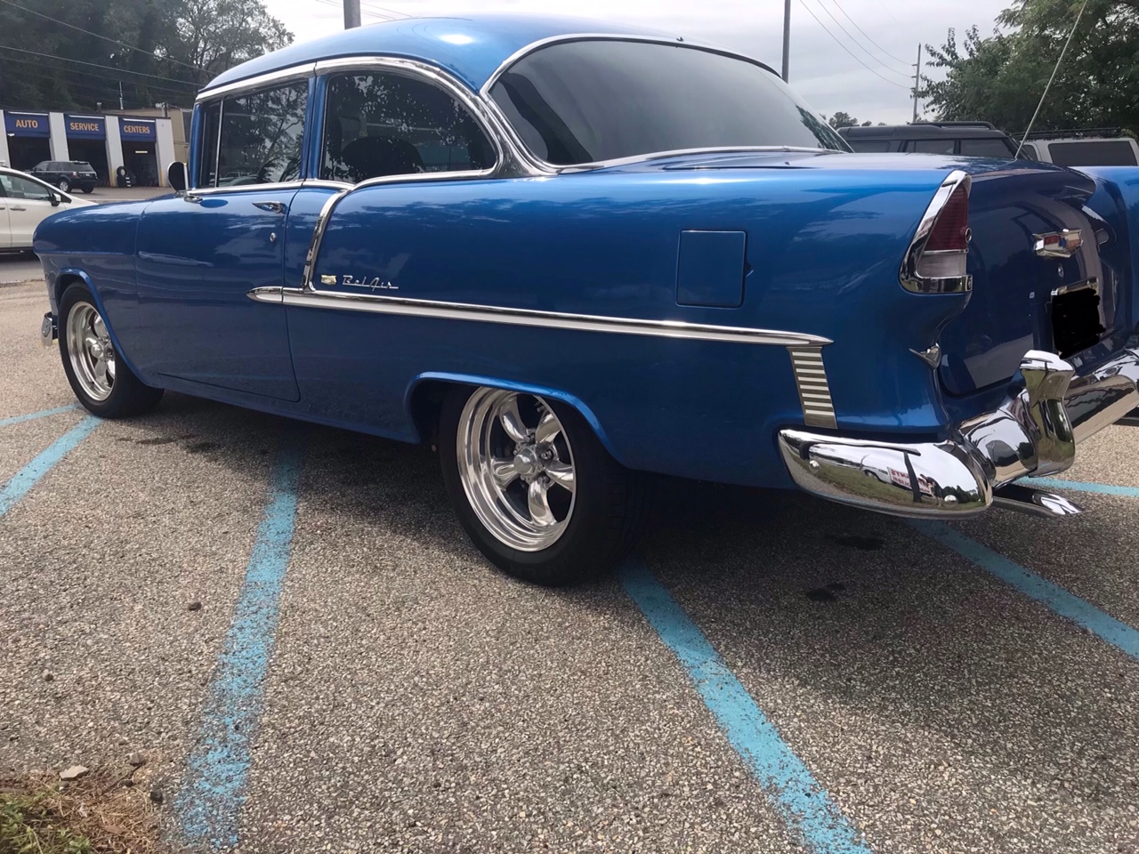

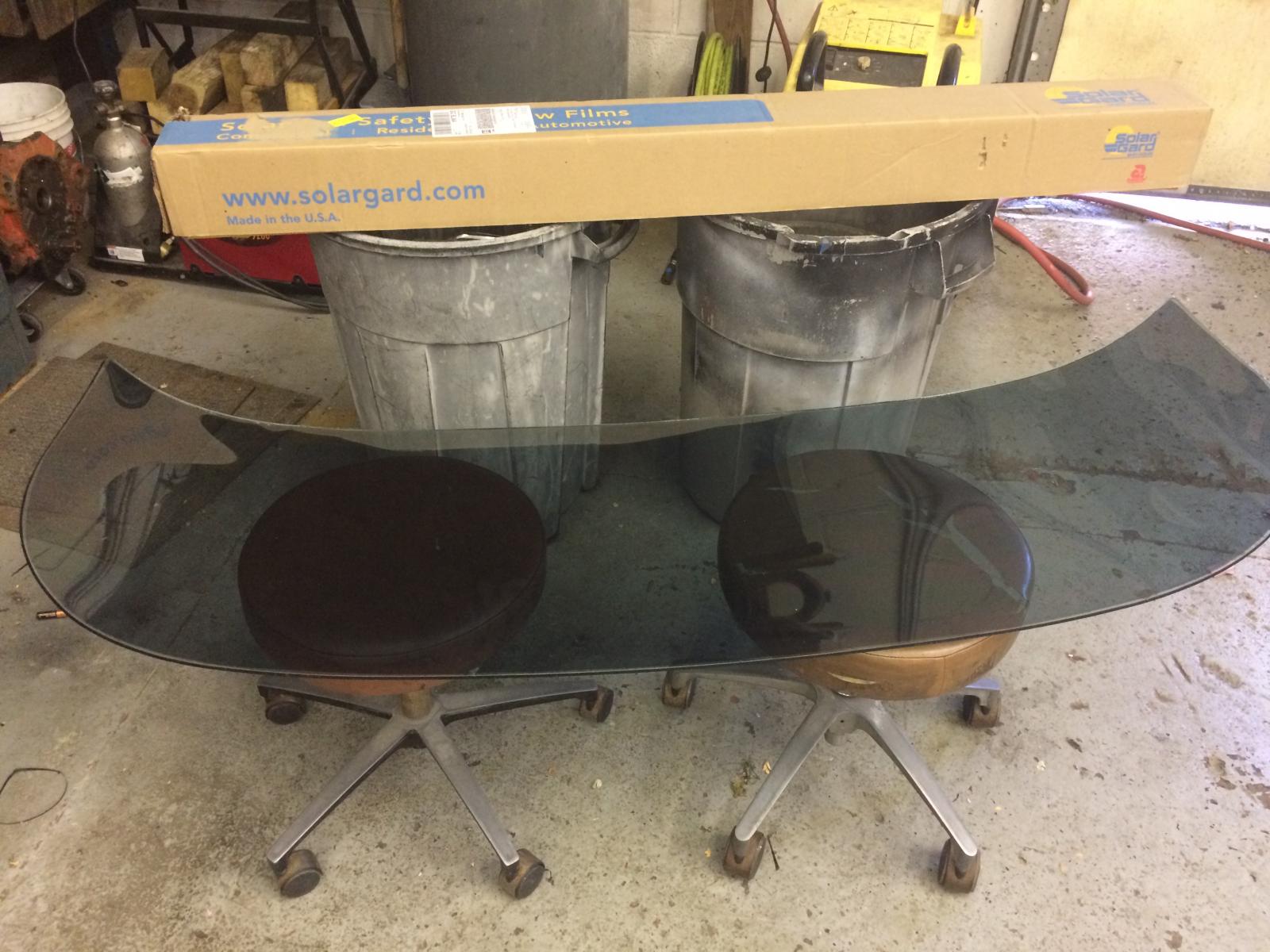

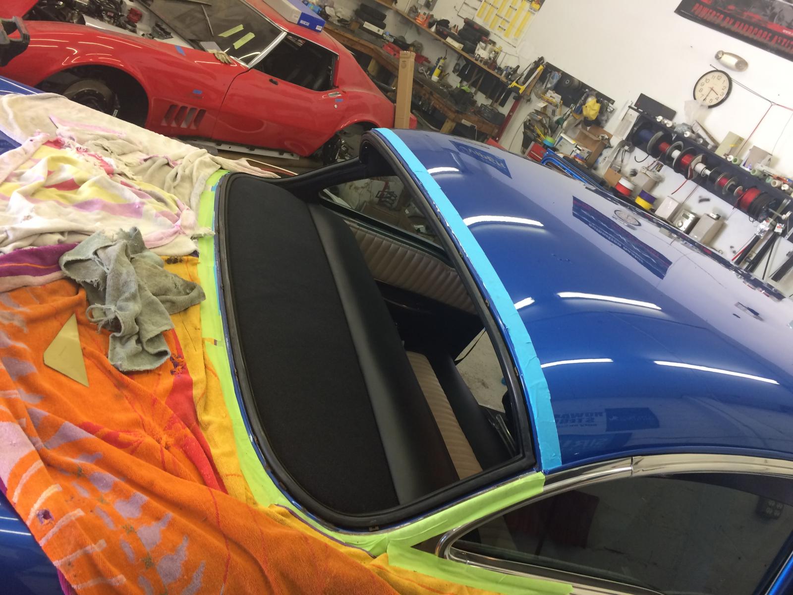

      I figured Id add some info here for those of you that are going to take your cars to get tinted, since I just did a '55 Chevy and took some photos long the way. Tinting a classic car is a bit different than the average newer car, so its a plus if the shop is familiar with classic cars.
      My biggest pet peeve is being able to see the edge of the film on windows. Especially stationary windows (ie: front/rear windshield) Its very difficult to tint gasketed windows cleanly and have the film edge be minimal or hidden. I recommended to the customer here to remove the rear window and tint it out of the car. This way the tint can be brought past the gasket edge and wont be seen. This method also greatly reduces the amount of dirt and dust that contaminates the film, and allows the glass to be inspected for chips along the edge that were previously hidden which can lead to cracks when a heat gun is used.
      To cut the side windows, I happened to have tri-five chevy glass for another project we are working on, and I was able to cut my tint patterns on the raw glass. This allows me to get the tint as close to the edges as possible, but know that it wont hang over (on the vertical edges) The top edge varies so wildly from glass mfg to mfg that its not feasible to expect a perfect top edge from another piece of glass; even though its for the same car. The interior trim was also removed to make installing the film a bit easier, which makes the end result cleaner with less contamination.
      Film on the side windows installed, and the top edge filed to fit for a perfect edge:
      This car was here for two days (although most of that was waiting for film to dry before re-assembly) but doing so ensured that the car would not have to be taken apart again for touch-ups or a re-do. All tint looks great right after its applied, but imperfections will show up hours later (especially on ceramic or thicker films). And on the topic of imperfections, take a very close look at your glass before you bring it to be tinted. Scratches and scuffs that are hardly visible on clear glass are FAR more obvious with a layer of tint underneath it. Sometimes it is worth it to replace the glass before spending the money to have it tinted.
      This car was done in SolarGard Nano-Ceramic 40%. We charged $950 to do all glass except the windshield on this car.
      Hopefully this will give some insight on how you can help your tint shop to give the best end result!
