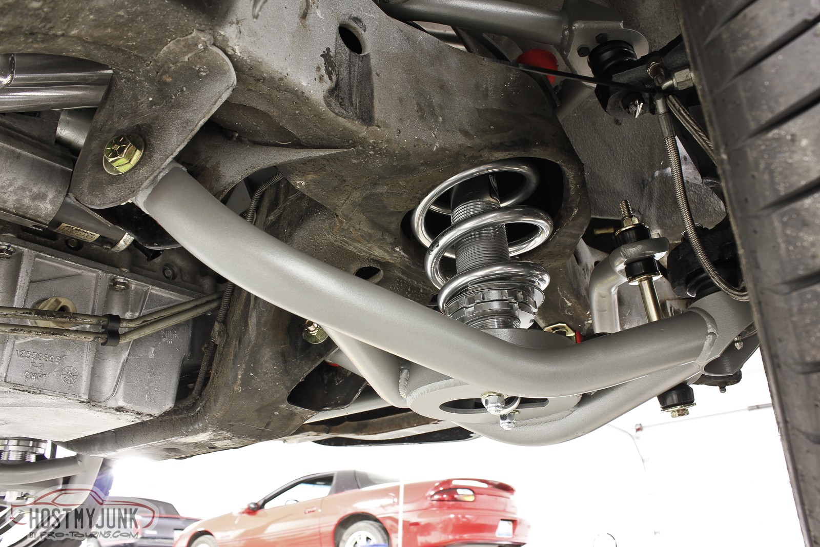

      You can get about two inches of ride height adjustability from most Vikings.
      different car ('73 Camaro) but you can see how much Thread you have on the Body of a Viking Coilover
