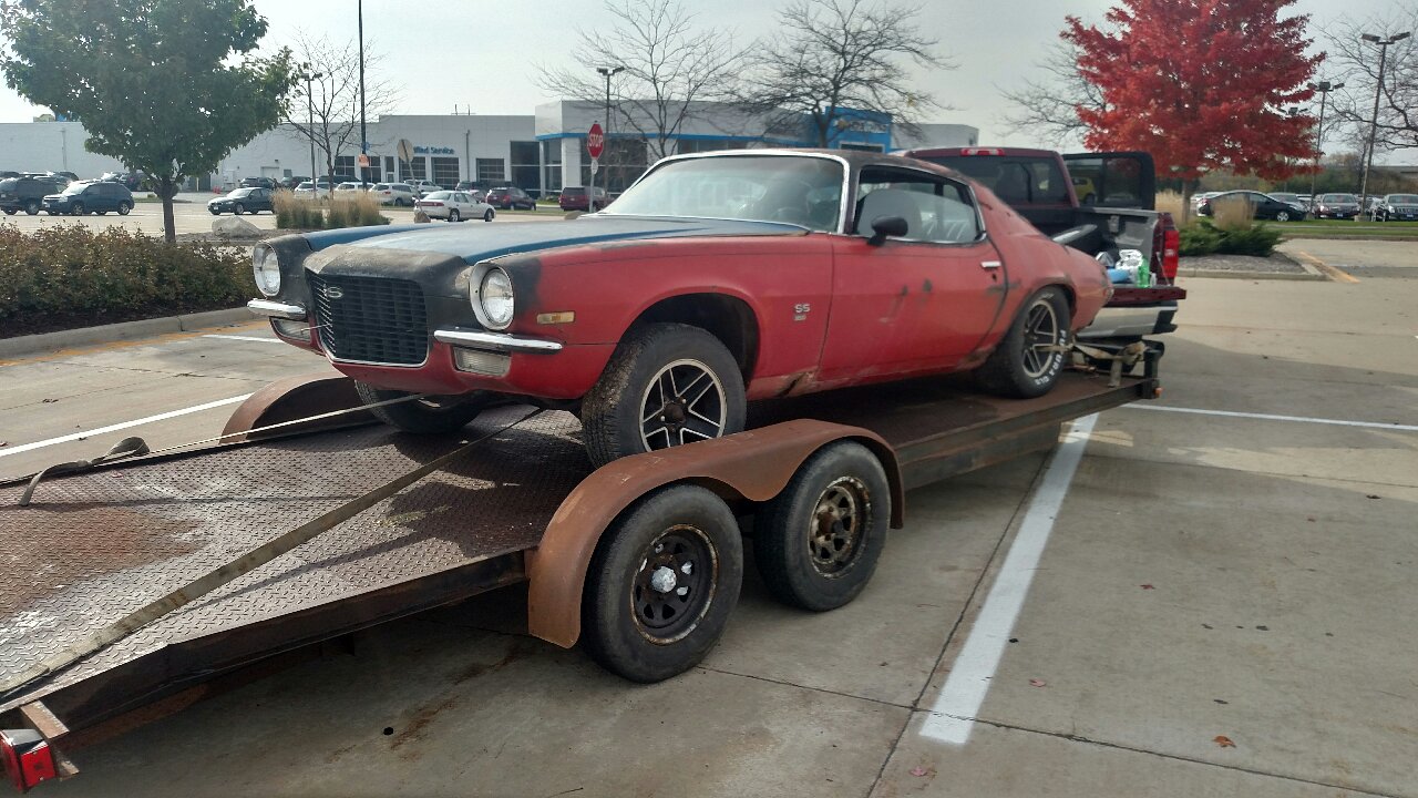

      I ended up finding a 1971 Camaro SS. complete but in super rough shape which is fine with me, i am not afraid of a project. (hoping the photos come out normal, if not i will repost)

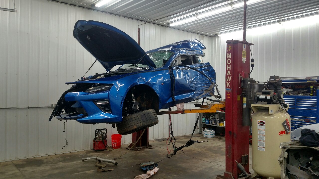

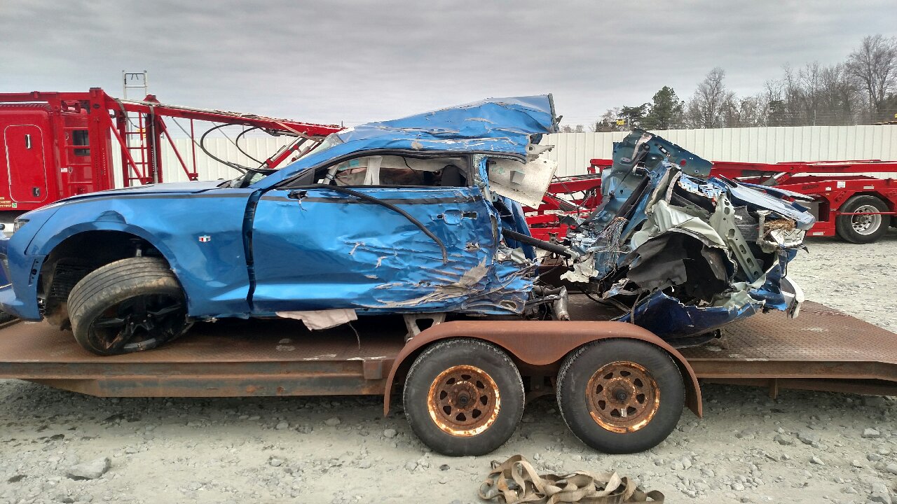

      The carnage was amazing but almost everything i needed was untouched. The poor thing only lasted for about 2-3 months on the road when this happened. A quick trip to North Carolina and she was coming home. Getting it off the trailer was a challenge of its own.
      Click image for larger version.
Name:	16 camaro.jpg
      So a good amount of the pieces were in place but it would be almost another year before the project would start. The shop was busy and i needed to pay for all the new parts i needed so that took priority. when i had time i would tinker and strip the 2016 camaro.
Name:	16 camaro 3.jpg

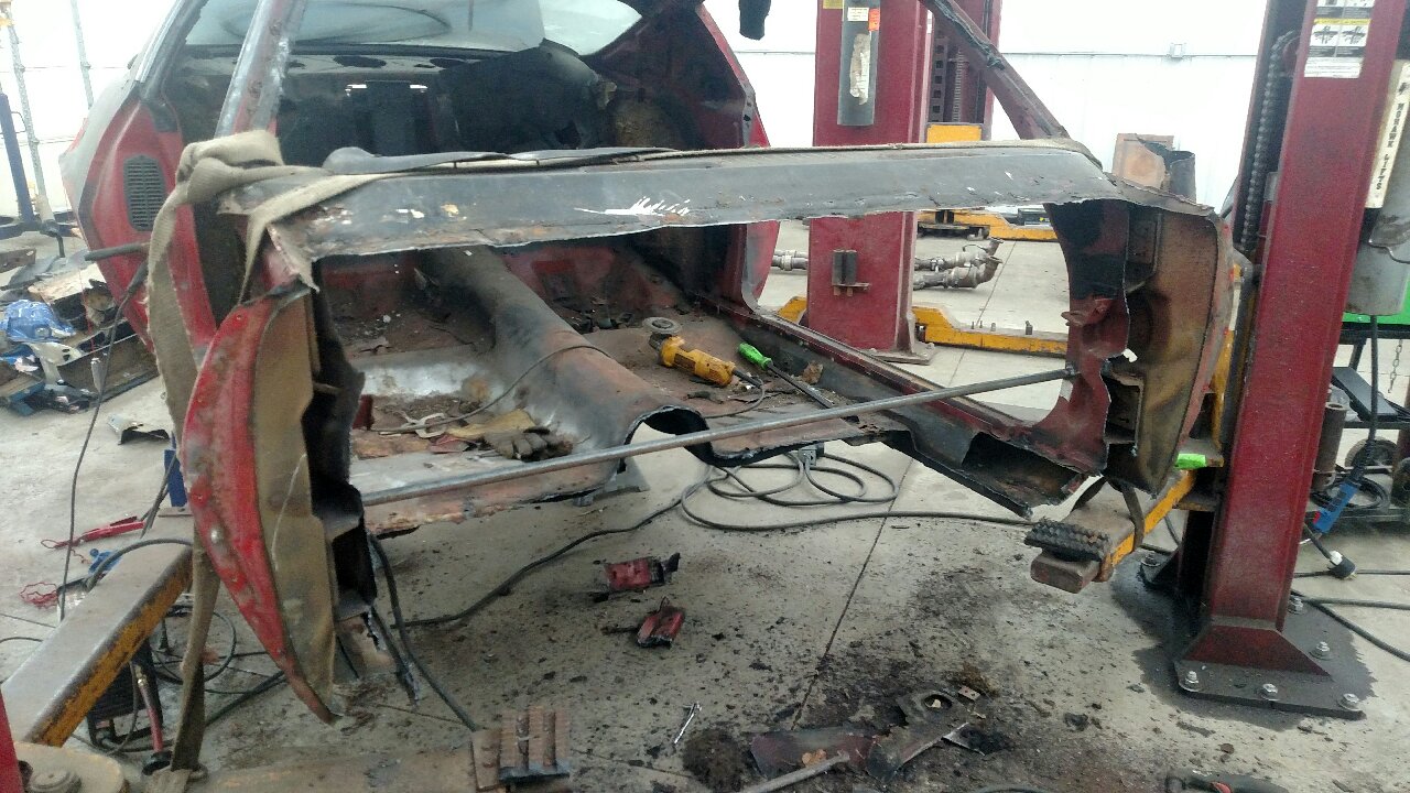

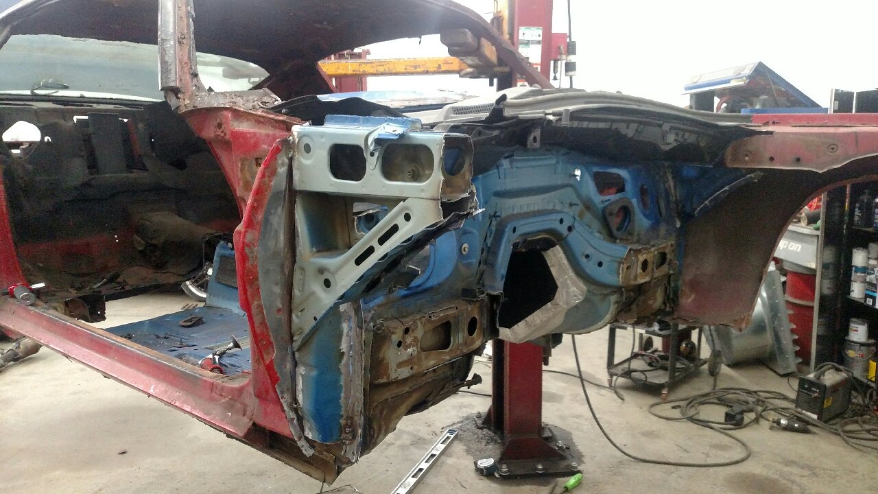

      My plan was to use as much of the 2016 as possible to make the newer pieces transition into the 71 as easy as possible. After doing a lot of measuring and planning i realized that if i was to utilize the firewall from the newer car i could easily bolt up the dash and other interior components as well as some of the engine bay stuff i wanted to use. This also cleared a lot of space for the engine to go back thus helping balance the vehicle.

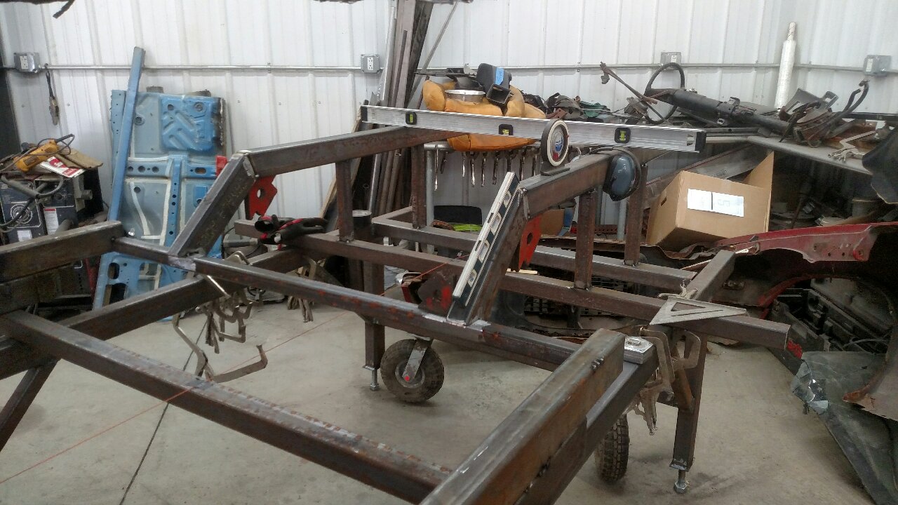

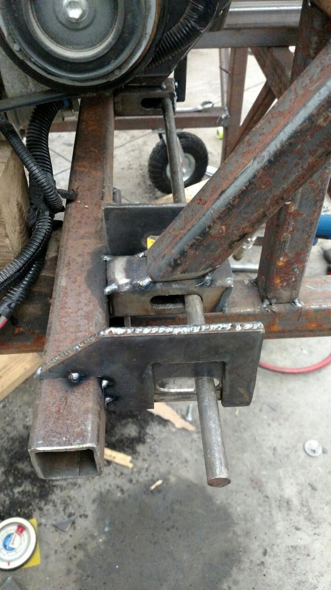

      With the firewall and everything removed and the newer one fitted and tack welded in place i decided the original front frame was not going to work. The easiest solution to this was to go custom Chassis. I spent a good amount of time building them to go in circles so i figured this shouldn't be any harder. It was time to roll out the chassis table and start building. I started by building and squaring the center section
      and started constructing the front rails. The steel had been sitting around the shop so its not as clean as it should be but everything will get media blasted before it gets painted and starts going back together.

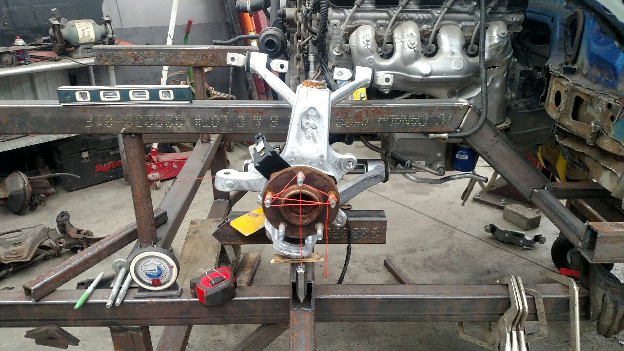

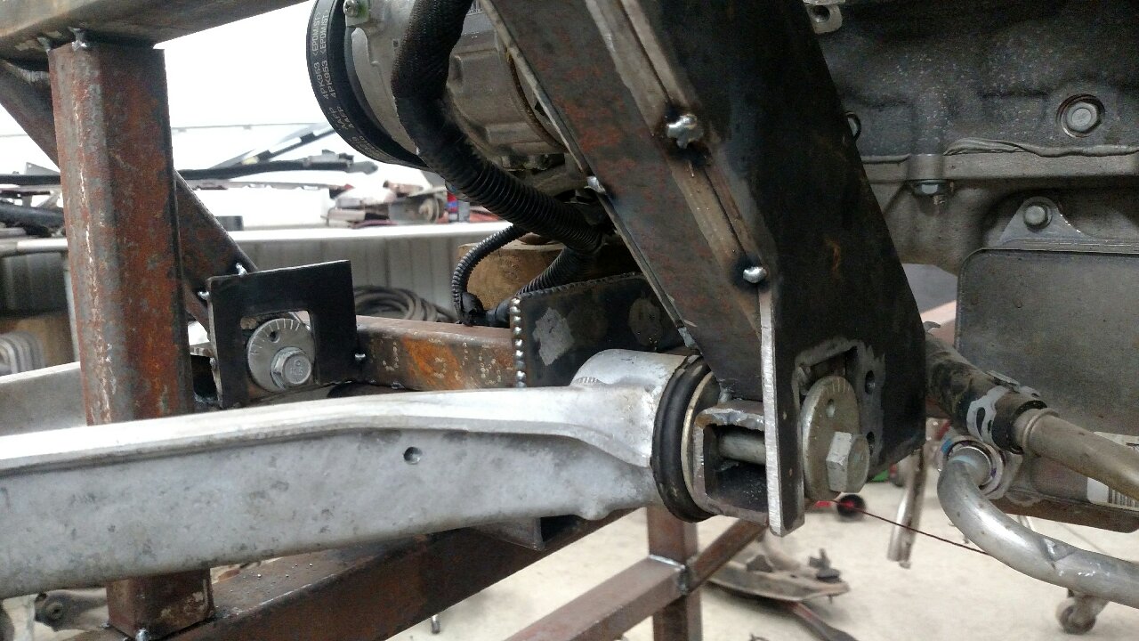

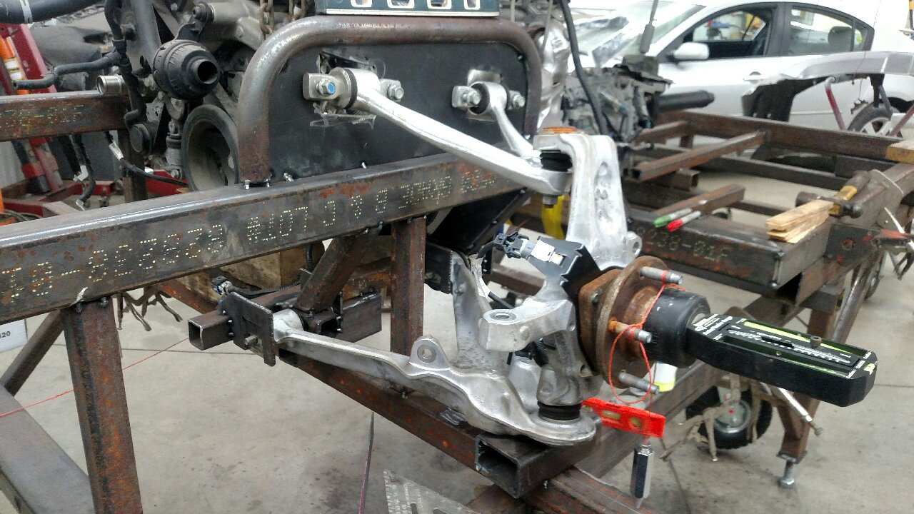

      with this kind of build you are not going to go with a stock suspension so i ordered up a complete front assembly out of a C6 Corvette. My plan was to make the suspension with as much adjustment as i could get. So the lower control arm mounts were made to use the camber adjustment bolts that a C6 has. Took a while to figure out how everything should mount but my full time job exposes me to thousands of cars a week and we happened to have a Z06 show up. after a few measurements from that i knew i was in good shape.
