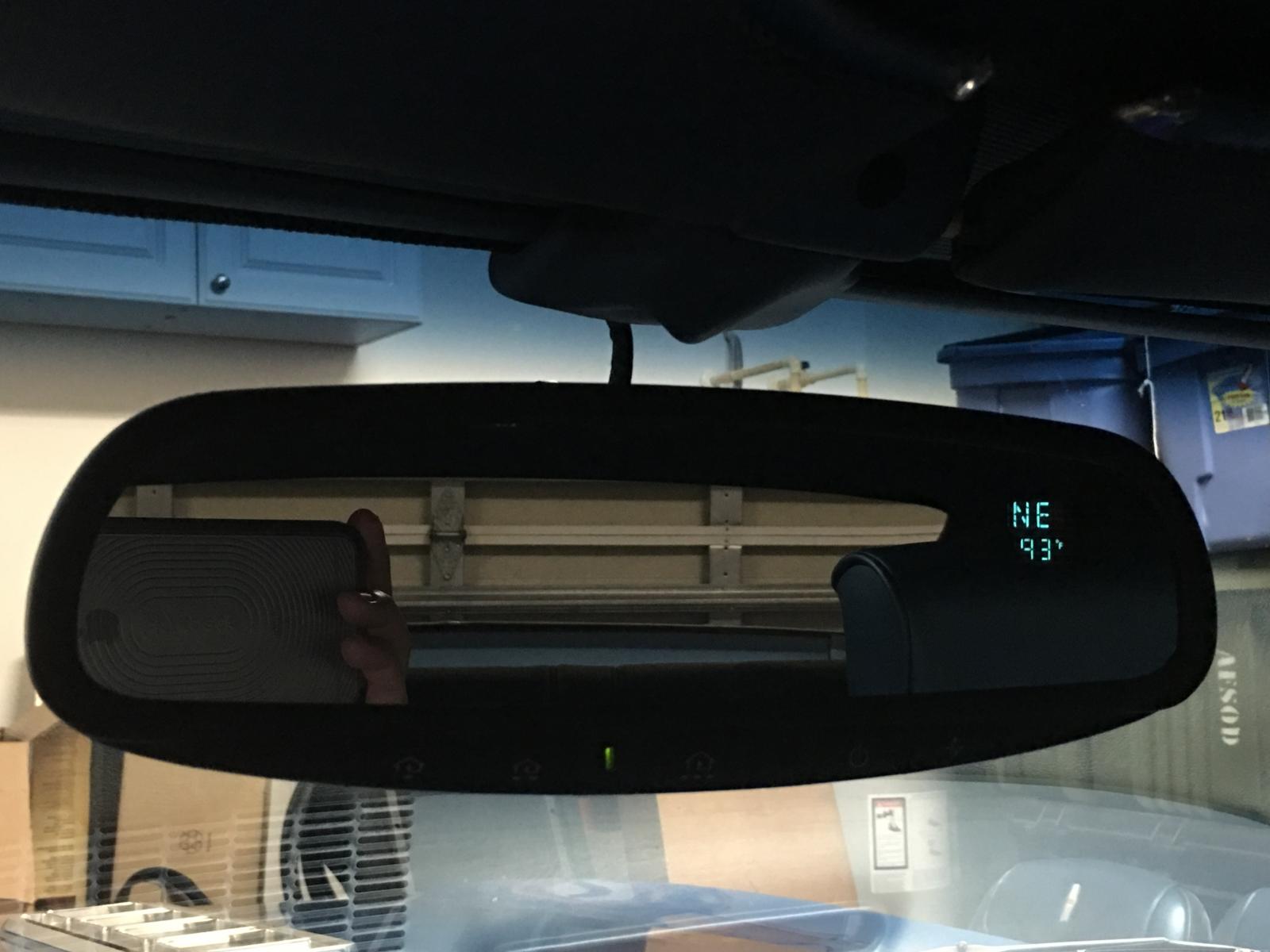

Size:  116.0 KBI installed a newer Gentex one with garage door opener, compass, temp and auto dim (best feature). Easy to mount and install. You can buy them off of EBay. Buy a “button” from you local auto parts store, glue it on the windshield and install the mirror. Wiring is simple- battery, ground , ignition and this one has the two wires for the temp sensor. I mounted the temp sensor on the front of the core support behind the drivers headlight.

      I've been looking for something also. What dimensions does that have as compared to a stock one?

      The mirror face is about the same size but it is “thicker”, around a 1/2-3/4” thick. I really like the auto dim feature. No more blinding lights from behind.
