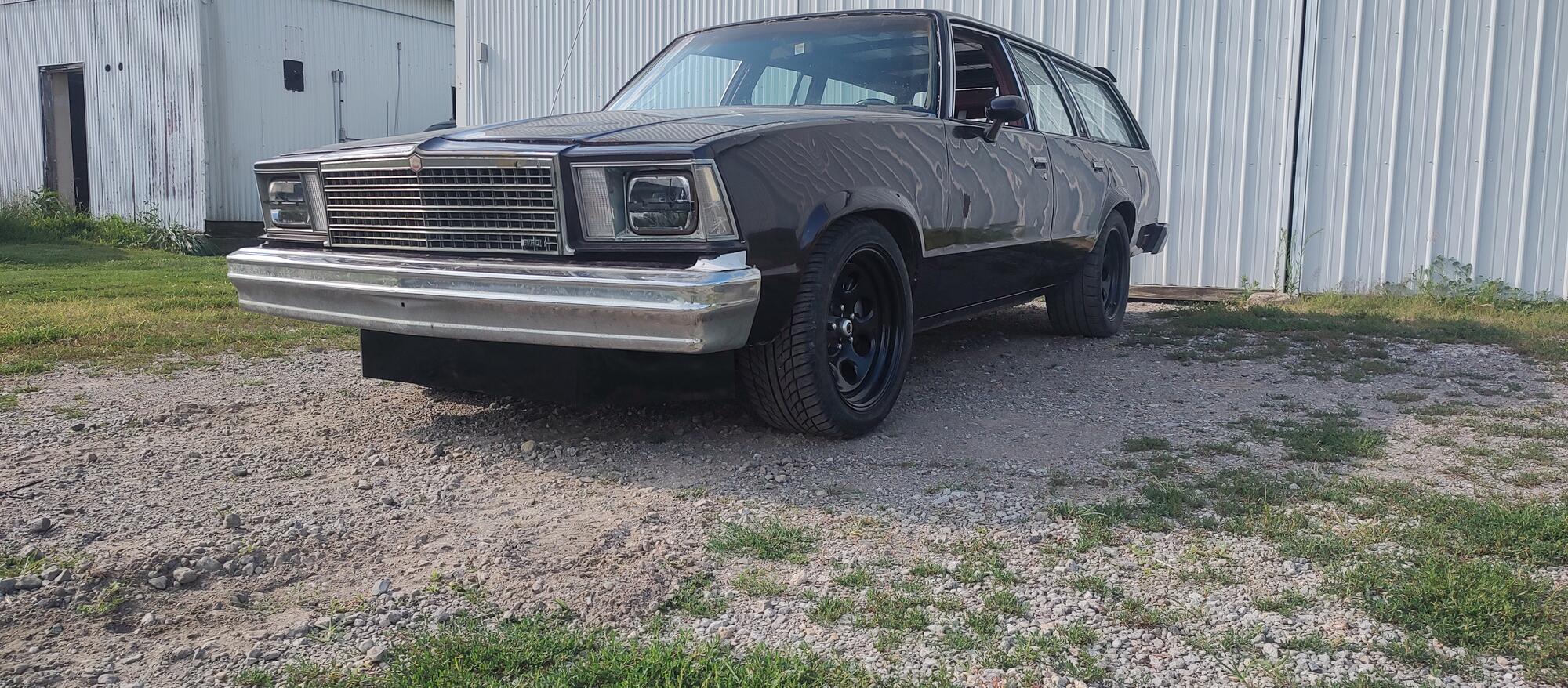

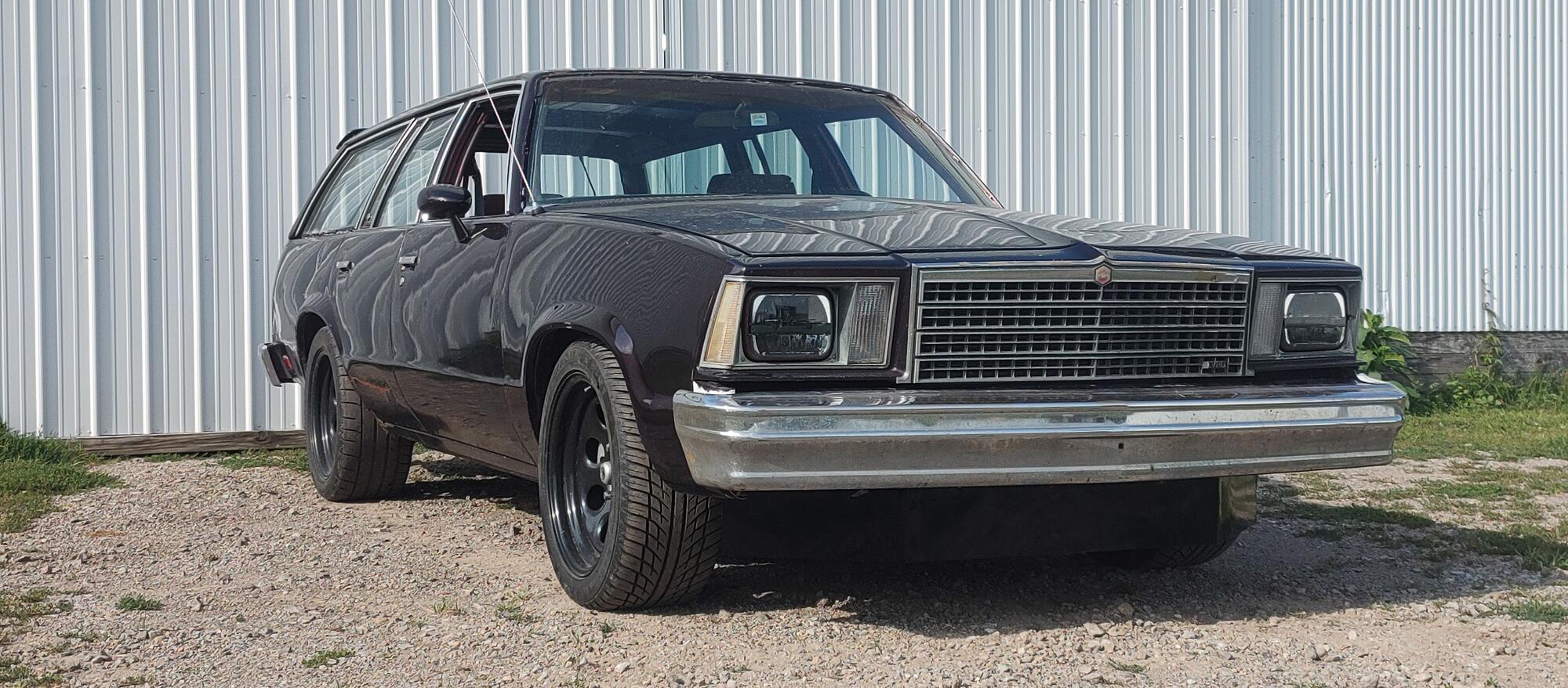

      Totally expected to find this locked
      It has a new 482 BBC, UMI front A arms, C5 13" brakes 4th gen F-body 12" brakes out back and assorted bolt on frame braces, had it put auto x couple weeks ago for a shake done, old hard 300TW tires, ****ty shocks and rusty driver, nailed 76 or 77 cars. Did shave almost 10 seconds off my slowest time after 8 runs. Coil over with DA shocks and some fresh 200tw tires on the list, should allowed to hang out upper middle of the field
