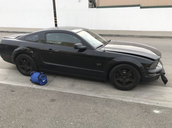

      before i start tearing it back down to the frame i wanted to see if i could get some help here! i want to purchase a 05 mustang gt prefebly totaled and do a complete drivetrain swap. the idea is to have a good daily driver with ac since i live in the desert in california(palm springs) and since i can get the car for what astand alone harness from ford costs it seems like a good idea in my head but im sure im missing something or am thinking this is easier then it realy is.
      first question is- will i need to modify the harness if i have a complete doner? or can i just swap everything from the car to the truck and modify things to fit as i go?
      iv worked on a few of these mustangs and im somewhat familiar having swapped trannys, removed engines, and fixed issues here and there, but definatly not a professional. i know i will potentialy run into an issue with the pats system i do want to keep my original steering column but if i cam the truck i need to tune it and i can hopefully have the pats disabled my the tuner.

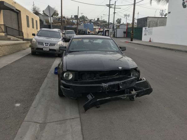

      picked up a parts car, iv been spending all week tearing the parts car apart. pulled the drivetrain, gutted the interior, just need to get the rear end and fuel tank and then off to the wrecking yard, the idea is to modify the original harness while keeping some things like air conditioning, guages, and all power in the interior.
      now im not sure if i can use the stock gas tank or not i figured if i can get it mounted i can later make some fuel lines this will save some money on the build.

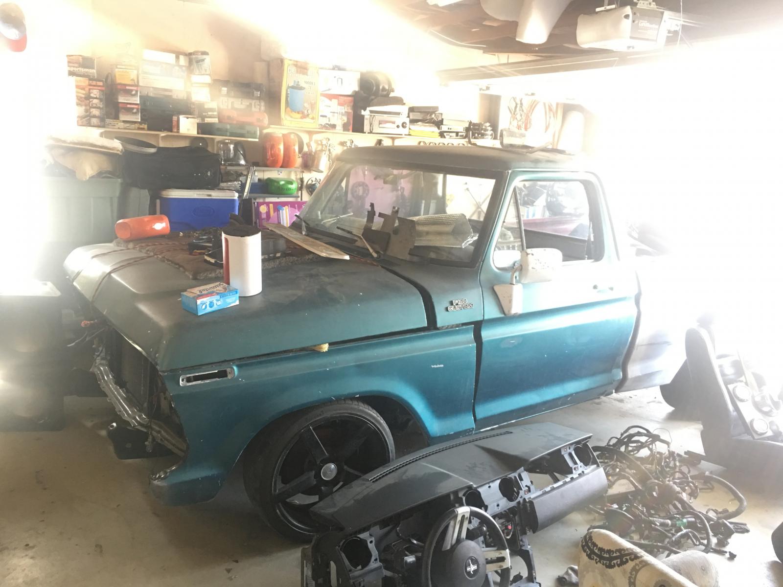

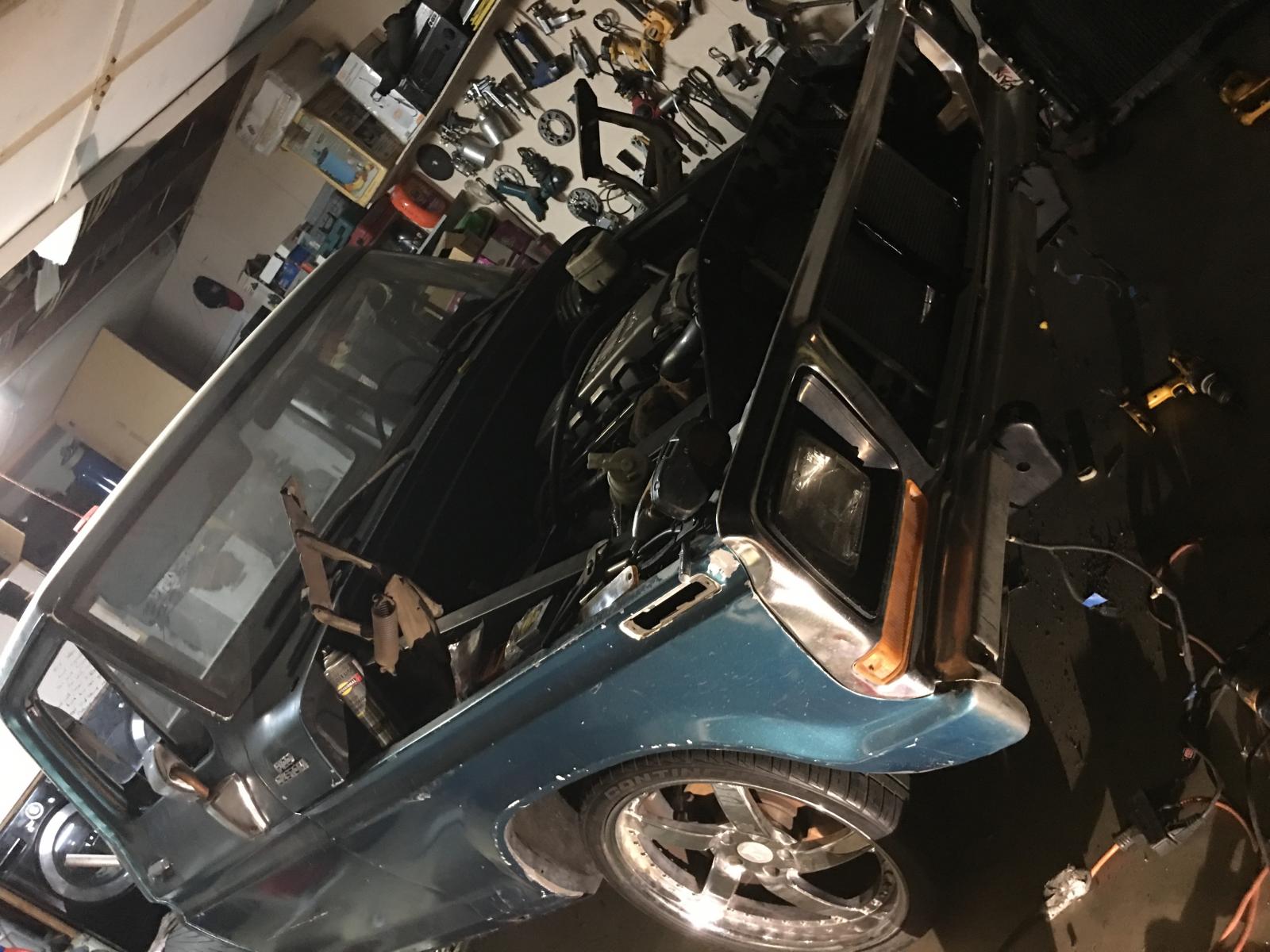

      finally got rid of the shell and had a few hrs to work on the truck. went ahead and removed the front end, properly drained fluids all over my driveway, pulled the engine and trans and a few things i wasn't going to re-use. swapped the 06 mustang motor mounts for 05 crown vic mounts and slid right in perfect fit only thing im going to modify is the transmission crossmember has to me pushed forward about 1/2" itll work where it is but id feel alot better if i bolt the tranny down in the middle of the crossmember. also gutted the interior down to the dash and wiring i realized that if i want to keep the A/C i have to cut the notch in the middle of the cab/firewall where the trans tunnel starts and make it flat with the rest of the firewall and hope the dash wont hit it when i bolt it back in!
      also the rod that connects the steering column to the rack rubs on the manifold when i try to steer it so i need to figure that out!

      back on the project, so just to make it clear i DONT have any experience welding so dont make fun of my crappy welds! theyre strong i started mig welding them with no gas which was a disaster but once i bought a tank full of a25 it made it a whole lot easier. the welds arnt clean but theyre strong im going to be undercoating floor inside and under the cab and possibly the firewall so i wont even bother grinding it down, moving on i started cutting the firewall out so i could make it flat so the AC box out of the mustang will bolt on and fit without it protruding into the footwell area on the passenger side. i did have to cut a small area on the dash right in the lower middle that the center console will cover.

      the issues im facing are a few now, since i had already set up my steering connection from the column to the power steering assembly which was perfect with the old 351 that was in it now that i installed the 3v engine the driver exhaust manifold prevents the bar from spinning so i went ahead and bought a set of shortie headers and the issue is still there. it needs at least 1/2" of clearance i have 3 options, 1.smach the header tube till i have enough clearence, 2. make a half inch spacer for each engine mount and lift the engine enough so it clears, or 3. somehow slide the column down an inch and cut the bar shorter which is easier to do but i have no idea if i can just slide it down an inch or if its set where it is! another issue is the front shockwaves i have wont work for the front where they were intended to go so is it possible to use them in the rear and buy a aero universal bag for the front strut and go that route since buying new shockwaves isnt an option because of the budget.
      on a good note i struck out on a set of wheels that i was drooling over a few years ago and after a trip to LA last week and a search on craigs got me for dirt cheap which is gona help the budget out a bunch! anyway ill try and post more pics looks like there will me more progress made this week!

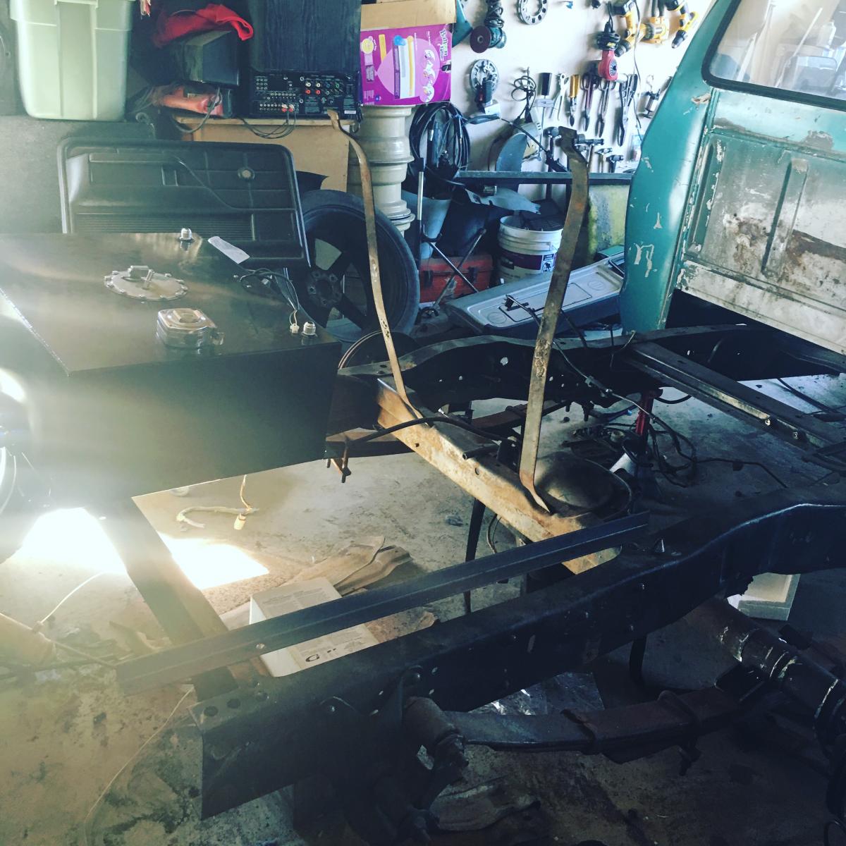

      anyway, installed a new clutch, built a tranny crossmember, moved the firewall 2" forward so the mustang A/C box fit inside the cab, ran most of the wiring and now im installing a fuel cell and the rear axle, lots of work done

      Iv been working alot on the truck im one month away from the wedding and starting to feel all the pressure with funds, wedding stuff and my fiance constantly reminding me i should have finished the truck already lol and to add to it my cousin asked if id do a gender reveal burbout with it in 4 weeks so no pressure!
      Anyway, wraping it up so i can start it for the first time (in the truck at least) i still have to figure out the plumbing for the lower radiator hose, for the rack/power steering fluid reservoir, was going to skip air ride all together because of the issue i had with the shockwaves but went on a buying spree online and ended up purchasing everything i was missing so more work for me! Decided against painting the interior and im using some brown mustang seats i traded my fiancé for my boss302 recaros since shes keeping my car since its now auto and she said she felt safer in those because of the huge bolsters, just need to go buy door panels, headliner board and a dash pad and instal everything, hoping i finish in 2-3 weeks!
