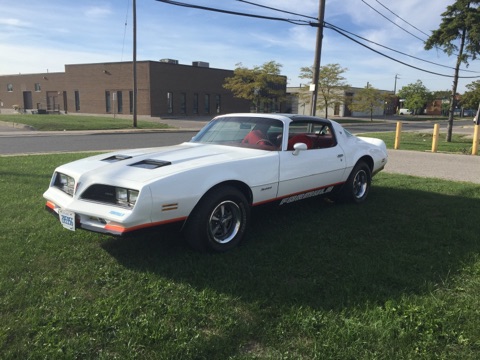

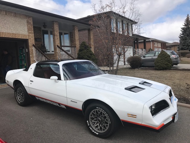

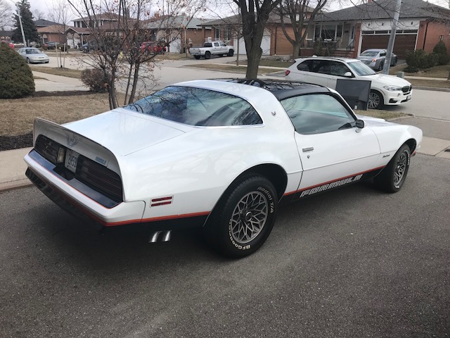

      I have recently sold my C5 vert and purchased a 77 Firebird Formula with 50,000 miles from the second owner. See car pictures below
      Its a very clean car.
