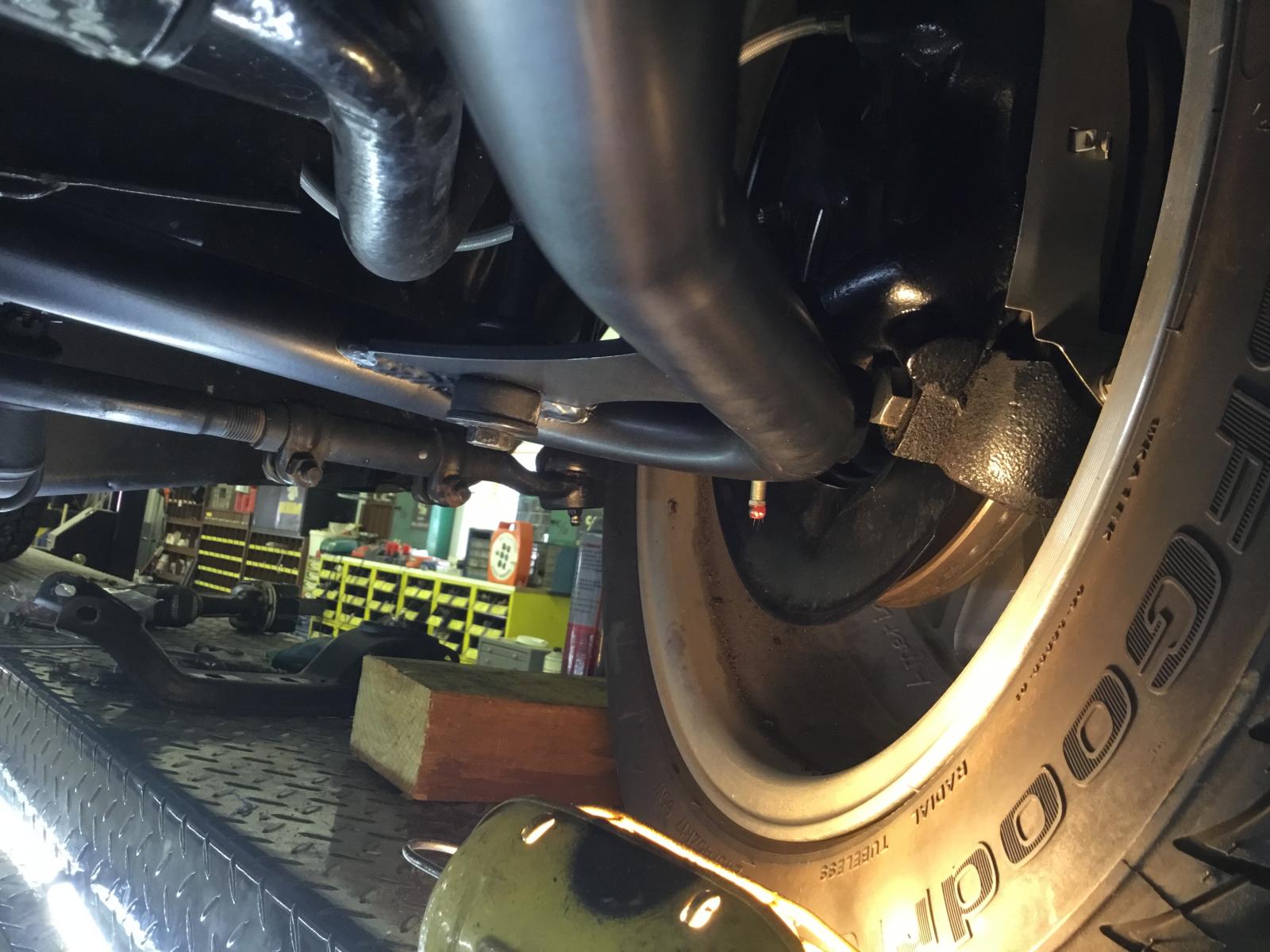

      Attached is a picture of the driver's side. I'm planning on putting some plates under it tomorrow and measuring the radius at current lock against the caliper. I'll post up the results tomorrow afternoon/evening. Not sure what stock radius is/was, but I'm sure someone has that data.

      Simple way might be to unbolt the caliper temporarily and see how much further you can turn the wheel. If it's another 1/8", a simple steering stop will fix it...the turn radius loss is nearly none. Its it's another 1.5" then we'll have to figure something else out.

      Got the toe set to about 0 and measured the spindle distance from the LCA vertical stop. It's about 3/4-7/8" on each side. Not sure what that equates to in degrees, but it definitely has hindered the turning radius. I looked at the possibility of flipping the calipers to the back side of the rotor, but the bracket won't work and it would interfere with the knuckle.
      Any advice on how we resolve this is appreciated.

      No, mainly because I just did this swap last year to the KH-style, so they are brand-new. I'm thinking my best option right now is to find/make a bracket for these KH calipers that will clock them to about the 10 o'clock position. Problem is i'm not that familiar with brake design, and i'm unsure whether or not these calipers can be positioned there in the first place, and then what material the bracket would need to be made from.
      Attached are some pictures of the gap. Easiest I found to measure it was to mark a scrap piece of metal and then measure the mark.
