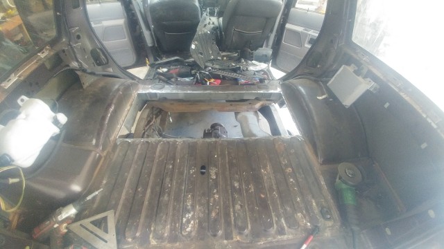

      Man I miss having a truck. 4 x 4 sheet of 14g. Did a little famage to the center console and weather strips on the door.

      Well I got the driver side partially done. I don't have a mig welder and tig welding way out of position with 20g sheet metal is Damn near impossible. I caved and pulled out my old fluxcore and did tacked it all around from the inside and I will finish it fully when I buy a mig later next year.
