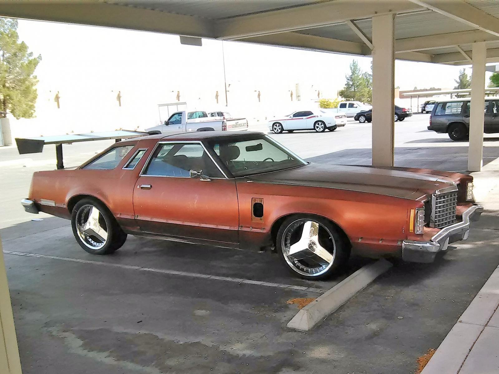

      Also, it is always best to keep as much weight inside the wheelbase. Got pictures of any of this?

      78 Thunderbird electric car
      This is the car with the solar wing on back . I was and in the middle of my 71 Thunderbird engine , so I have no new photos .
