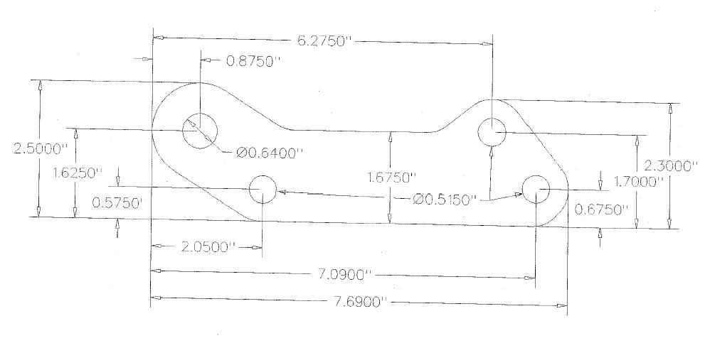

      I put cts v front brakes on my 70 skylark. I have stock drum spindles. I used the ls1 brakes bracket. I found the template online with all the measurements. I used 2010 camaro ss rotors I just had to open the center up a bit. With some minor tweaking I got it all lined up pretty well.
      I believe this is the cad drawing I used

      Thanks
