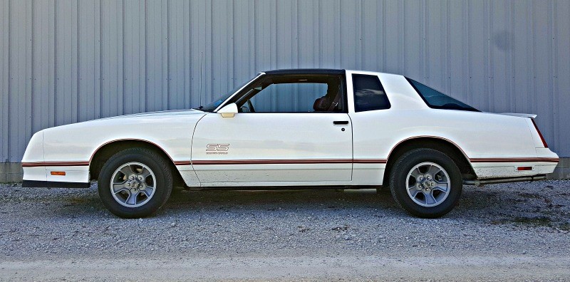

      As you can tell, factory ride height was a bit high. Although this height was acceptable in 1987 and did provide a decent ride, it lacked in the performance that was associated with the "Super Sport" branding.

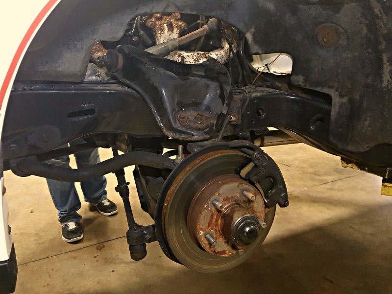

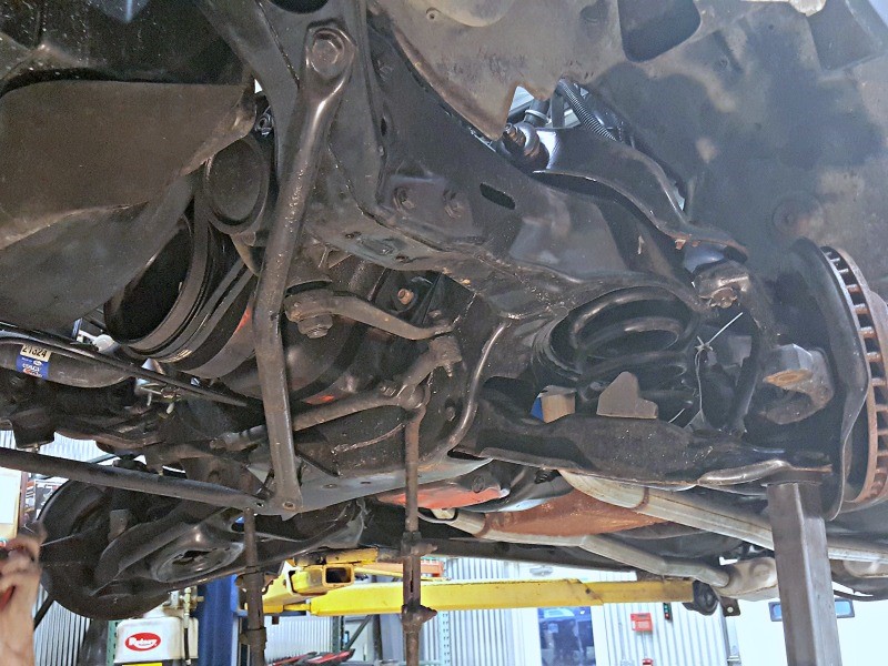

      When we got the car on the lift, you could tell it had been well maintained. Luckily for us, the components were clean and someone had paid attention to detail when performing routine maintenance. A lot of the factory components had been detailed or touched up when taken off the car. As we began disassembly, we were fortunate that everything came apart fairly easily.
      TIP: When removing your upper control arms, be sure to document where your shim stacks were located. Putting the shims back in their original location will make setting your initial alignment a little easier.

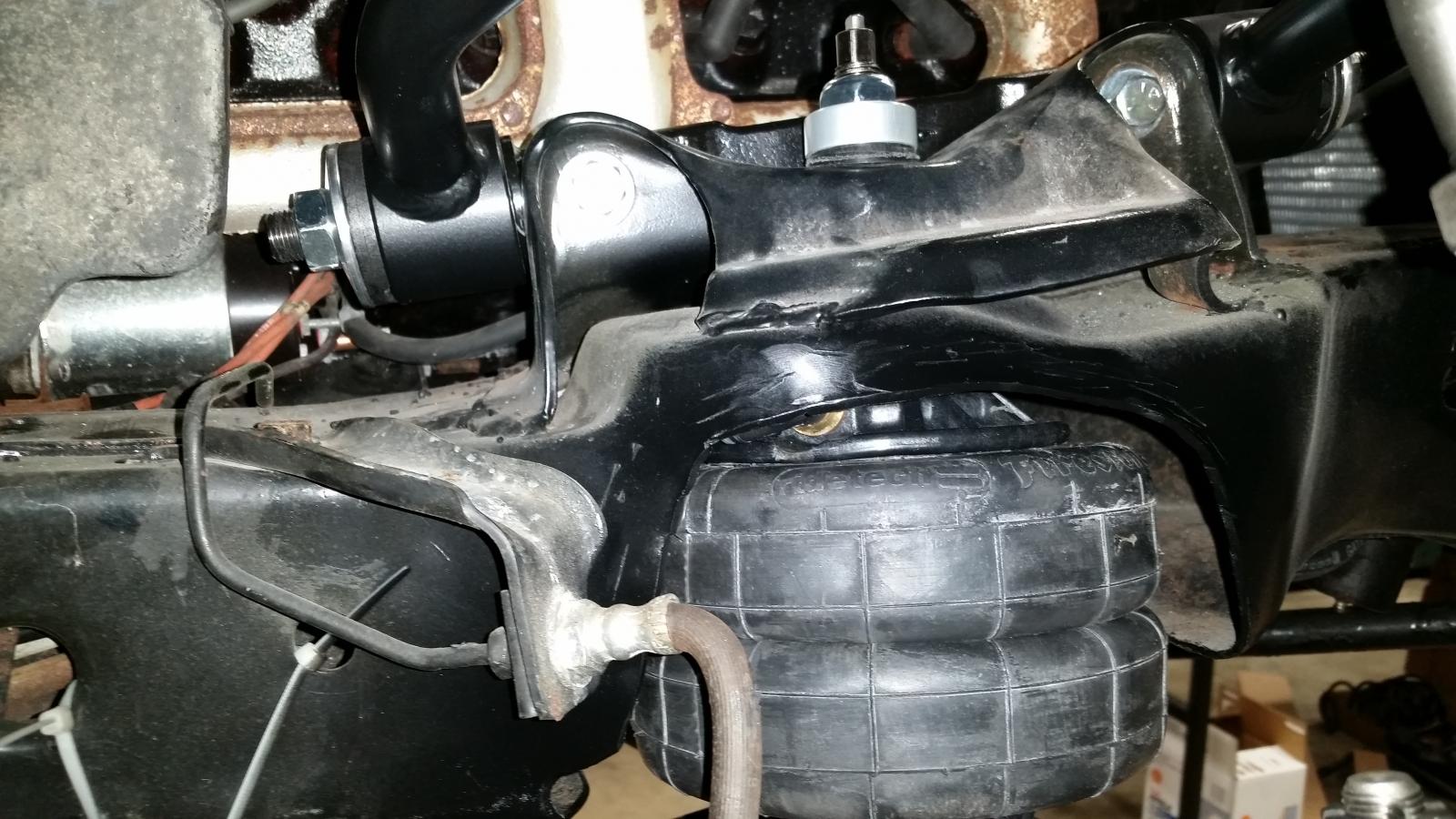

      Once the front end was completely disassembled, we cleaned up the frame rails and other components a bit and test fitted the lower control arm and Shockwave.
      Test fitment of the Shockwave bellow is an important step before final installation. This will give you a chance to inspect for clearance issues and interference throughout the components range of motion. Instructions included in the kit will give you detailed pictures on where material will need to be removed. Make sure that there aren't any places where the inner frame rail or spring bucket will rub the air spring.
      This is a picture of the Shockwave mocked up to check for interference.

      With our clearances established, we took a white paint marker and established the lines we would need to cut.
      While there are multiple ways to remove material from the bucket, use caution on the passenger side as the fuel likes are routed through there. For this particular install, we found it best to use an air saw, followed up by a small grinder to de-bur and remove and sharp edges.

      With the paint touched up and dry, we went ahead and re-installed the components back on the car.
      Again, before everything is tightened down, we checked clearance around the air spring. Although the ridetech Shockwaves do come standard with a Million and One Mile Warranty, this warranty will not cover an air spring with abrasions due to installation error.

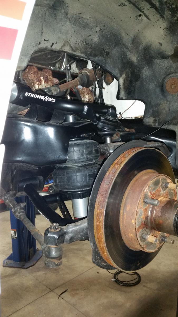

      When installing the upper StrongArms, pay attention to the direction in which the Logo is facing. When the arm is installed correctly, the Logo will be facing out towards the tire with the stamped arrow pointing towards the front of the car. Re-install the alignment shims back into the location where you removed them during disassembly.
      Keep in mind that we always recommend a professional alignment once the installation is complete. Re-installing the shims in their original location will help get you closer to that point.
      When having your vehicle aligned, we recommend the following specifications for street driven vehicles. Feel free to adjust to your own specs depending on your driving style or intended use.

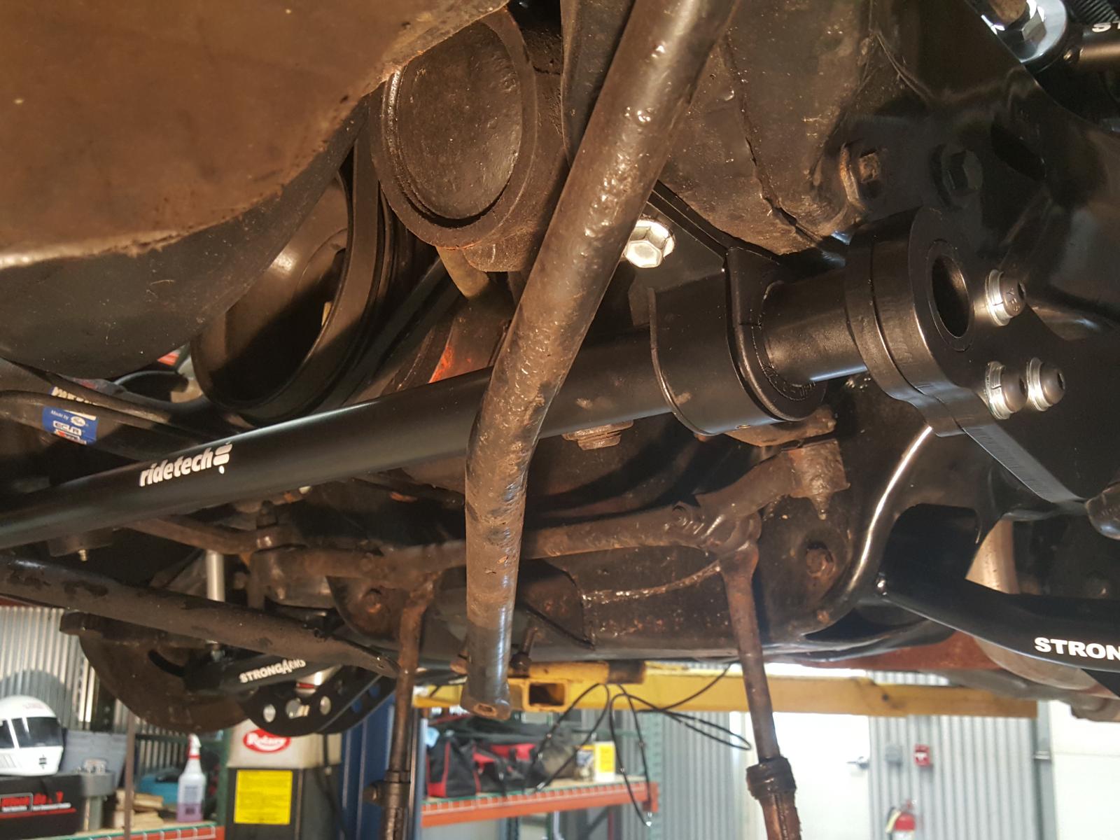

      Once you have the front arms and Shockwaves installed, you can bolt up the front MuscleBar and Posi-links.
      After the sway bar is installed, you can go ahead and hook up your steering components.

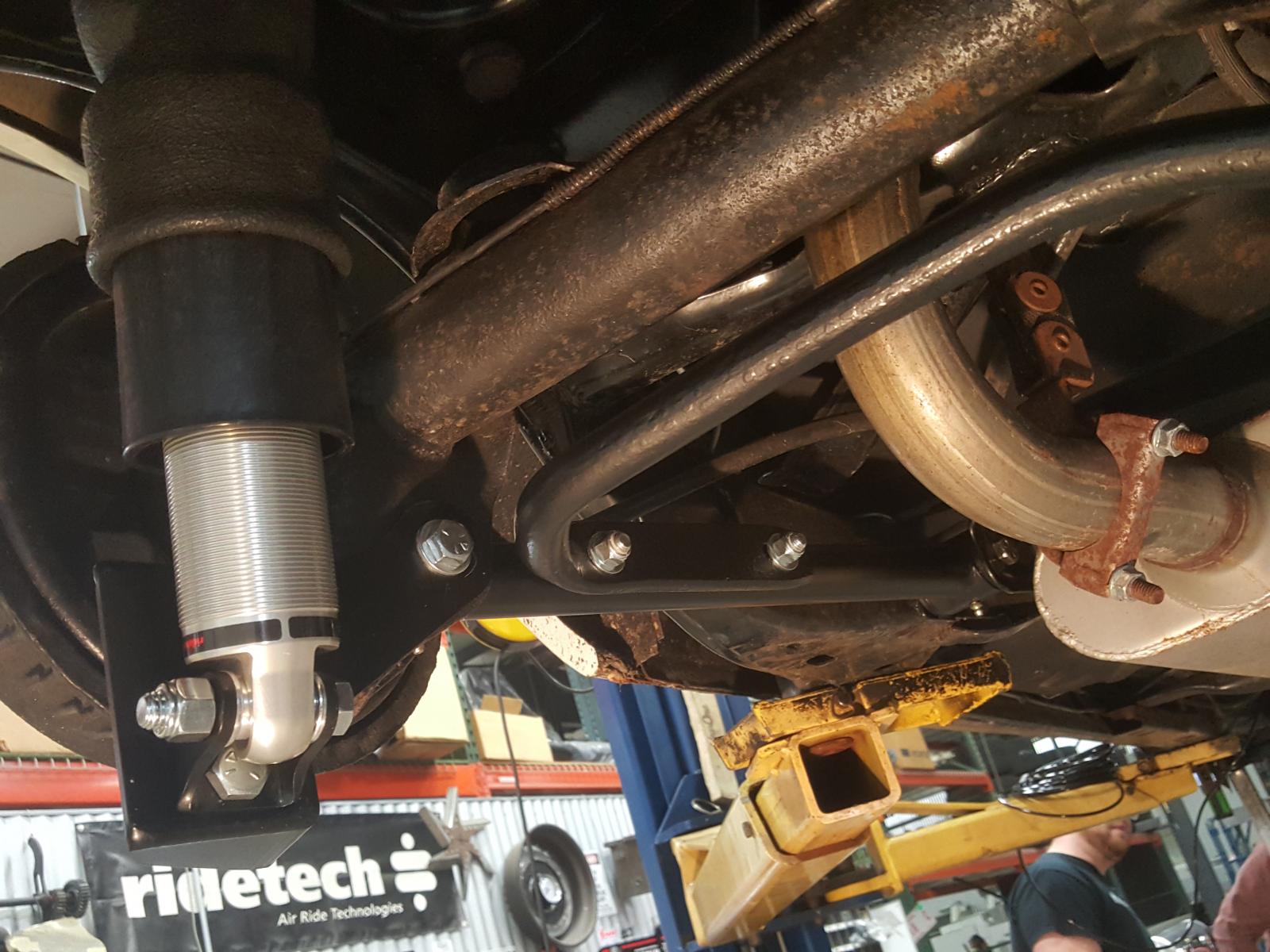

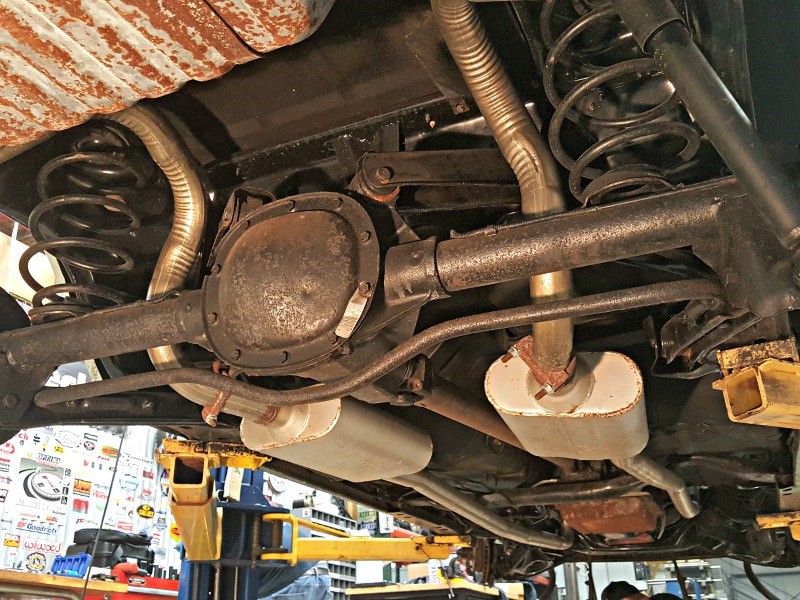

      Once you have the front of the car buttoned up, its time to move onto the rear.
      Rear suspension components install in place of the OE pieces and utilize the factory bushings on your differential. Pay close attention to the direction and orientation of your upper and lower arms. Locate the lower arms so that your sway bar mounting holes are closer to the differential than the front mounting holes.
      The upper bars will mount so that throughout the movement of the suspension, the rear mounting brackets will not interfere with the housing. The stamping on these brackets will indicate correct placement.
      Original Components:
      Name:  Rear Before--Edit.jpg
      Installation of StrongArms:
      Note the orientation of the stamping on the upper StrongArm. This will indicate the correct direction of the upper arms.

      The kit will include a new MuscleBar rear sway bar as well. It will mount up accordingly using the holes on the lower bars.
      For products used in this build, follow this link to our webpage! https://www.ridetech.com/products/su.../product-3254/

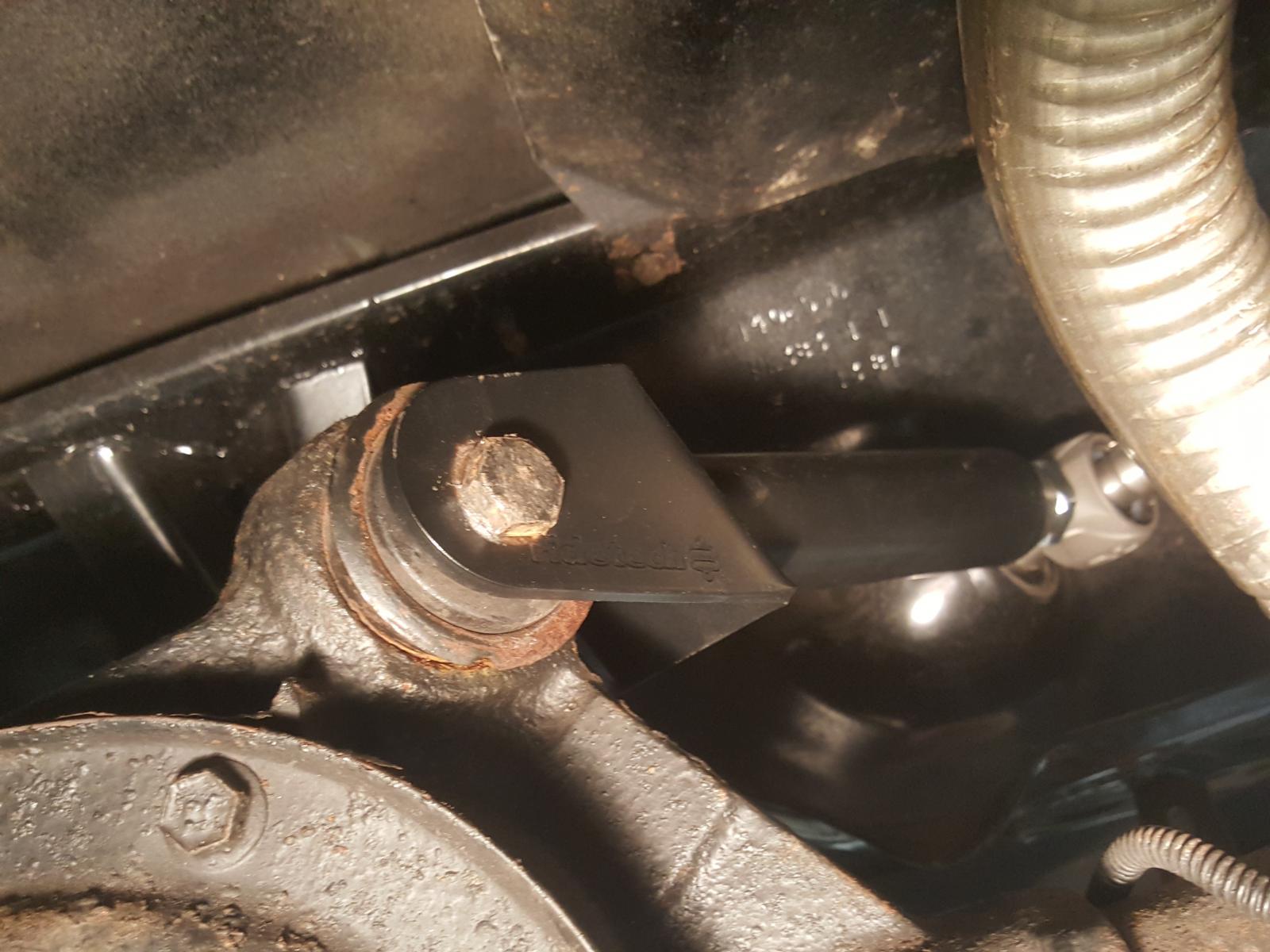

      Why weren't the outer tie rod ends that are supplied in the Tru-turn kit used?
      Jan 2017
      Live in Owensboro KY. Work in Jasper IN
      72
      Quote Originally Posted by Streetbu View Post
      They were, the picture was just taken before they were installed.
      Sorry about that, I will try and post a new picture of them installed ASAP.
