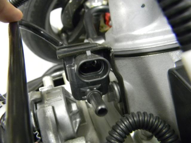

      I'm installing a GM Connect and Cruise in my 71 Camaro and can't figure out what gets plugged in this connector. Can someone tell me what goes here??

      This connection is the purge solenoid for the evaporative system. The solenoid runs to the canister that vents the fuel tank.
      Not normally used on a swap. You can remove the solenoid and install a plug.

      Great, thanks guys!
