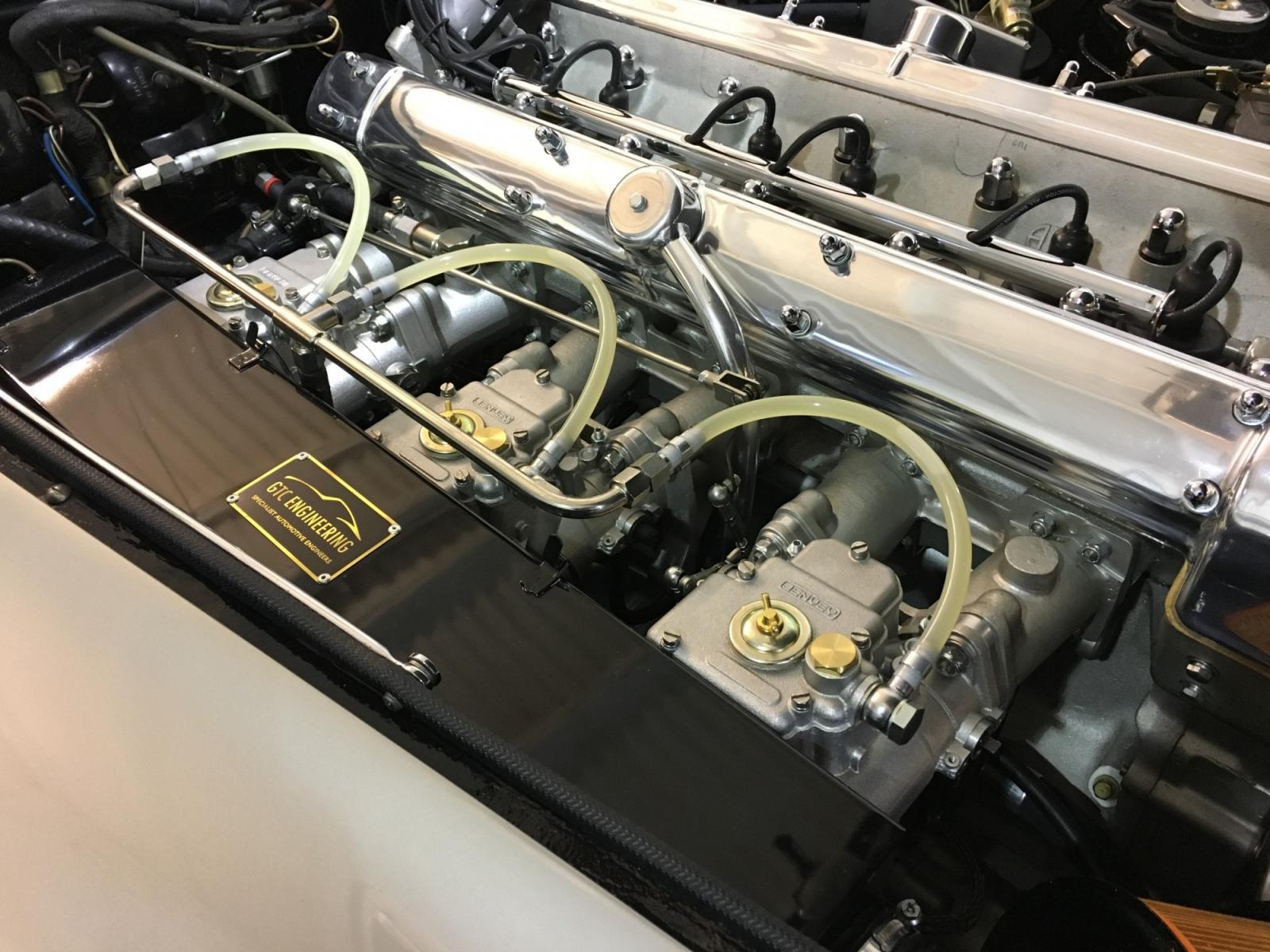

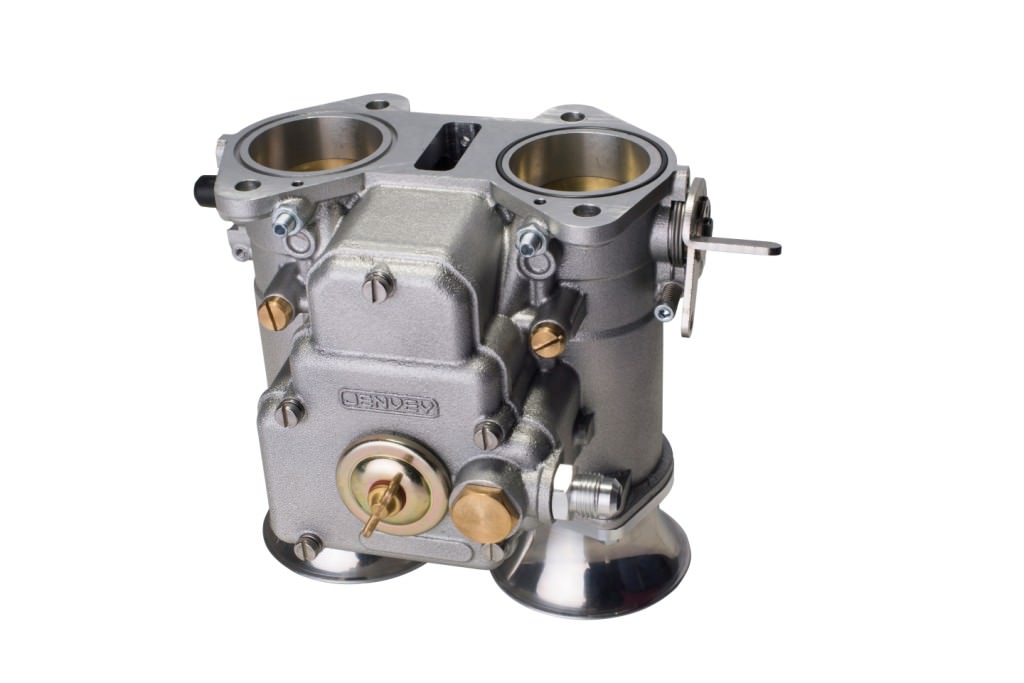

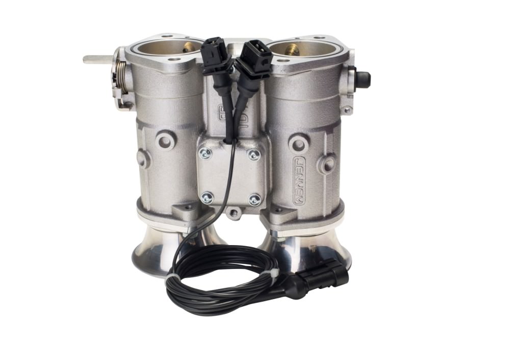

      Quote Originally Posted by 275nart View Post
      Richard,
      I'm hoping to keep the factory lucas EFI (I have the entire harness and ECU pulled from the running jag) but if not I'll either do 6 webers or AEM or Pro EFI. We'll see how it goes, or doesn't!
      Ahhhh- Lucas - "The prince of darkness!!!"
      Do look at the Jenvey Heritage ITBs -look like Webers. I wish these were available when I did my ITBs.
      Richard
