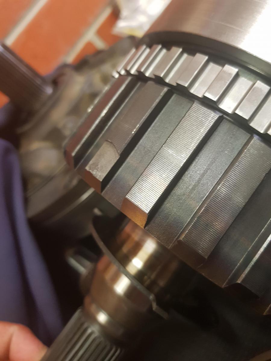

      hi guys beginning re assembling my 4l80e and noticed a chip is missing from my rear planetary drum please see picture my question is will this chip compromise the transmission in anyway to me that tooth on the drum serves no purpose there was no metal in the box when i disassembled it only damage i found was the direct clutch was smoked im just after some opinions on what to do i need a trans in the car and being from Australia 4l80 boxes and parts are very hard to find they never came in any cars here so any bits i order from the USA will take me 3 weeks plus to get took me over 2 months to land a core box and rebuild kit here. what do you think gents will it be ok to assemble this is my first 4l80 build

      That's actually a normal machine mark from when it was balanced. Some of those drums will have multiple lugs that look like that depending on how much material has to be shaved off to get it balanced. You're good to go.
      Thankyou so much i thought this was the case had to confirm.
      if you were in australia id buy you a beer thanks mate 👍👍👍👍
