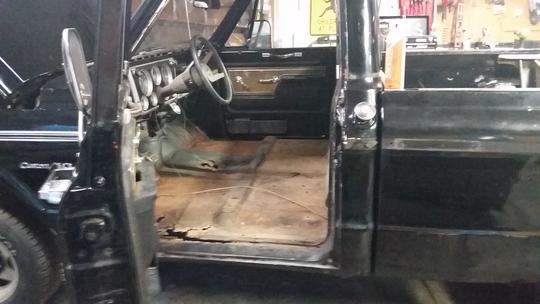

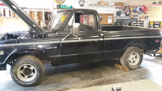

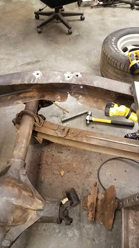

      I picked up this beautiful piece of vintage American engineering, a 1972 C10 short bed, in September of 2016.
      The motivation behind building a truck to do all of this instead of the typical Camaro, corvette, etc was because I was told “you can’t race a truck.” So being stubborn as I am, I decided to set out to prove them wrong. I have always wanted to build a 67-72 C10 but I have no experience restoring vehicles or building hot rods. I am a mechanical engineer by trade, I worked in the motorsports industry, and grew up wrenching on various things. But I have never restored a vehicle from the ground up.

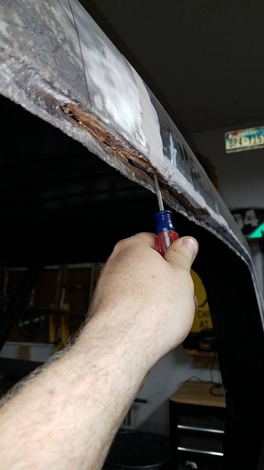

      Long story short, I bought a basket case and way overpaid for it. I had no idea what to look for when I went looked at it. I was excited about finally finding a short bed 67-72 C10 that I could afford which made me overlook a lot of red flags. It was just a rolling chassis, no motor or trans. One of the previous owners (not the guy I bought it from) was very skilled at hiding rot/bondo/etc. But hey, you have to learn lessons somehow, right. Well, I got taken to school on this one. The more parts I took off, the more rust I found.
      Name:  rotten rear window.jpg
Size:  40.2 KBName:  rotten rockers.jpg

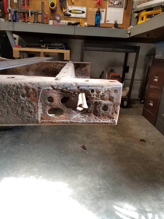

Size:  26.2 KBName:  rotten frame rails.jpg
Size:  64.5 KBName:  rotten rear frame.jpg
      The entire bed went to the scrap yard, minus the front panel. I began trying to repair the floors, rockers, cab corners but soon learned that this cab was far beyond my skill set. A guy I know, that was providing guidance on rebuilding the cab, had an extra cab that was in much better shape than the one I was trying to save. He gave me a decent deal on it so it was a no-brainer. Having to start over wasn’t all negative though, I learned A LOT on the first cab.

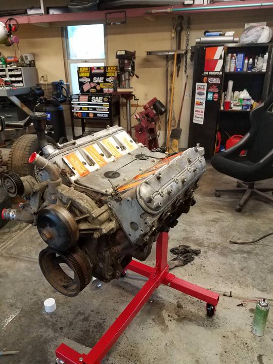

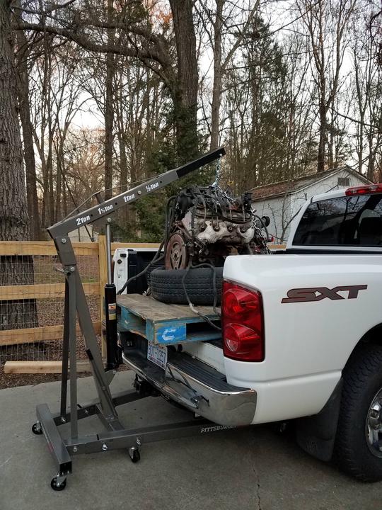

      So before I got a new cab I came across a deal on an engine I couldn't pass on. I picked up a 5.3L LM7 from a friend's dad. I had it delivered to my work to utilize the loading dock and fork lift. I brought it home, got it cleaned up and ready to be torn down for the head/cam work that it will be receiving.
      Name:  lm7 in bed of truck.jpg
Size:  98.8 KBName:  lm7.jpg

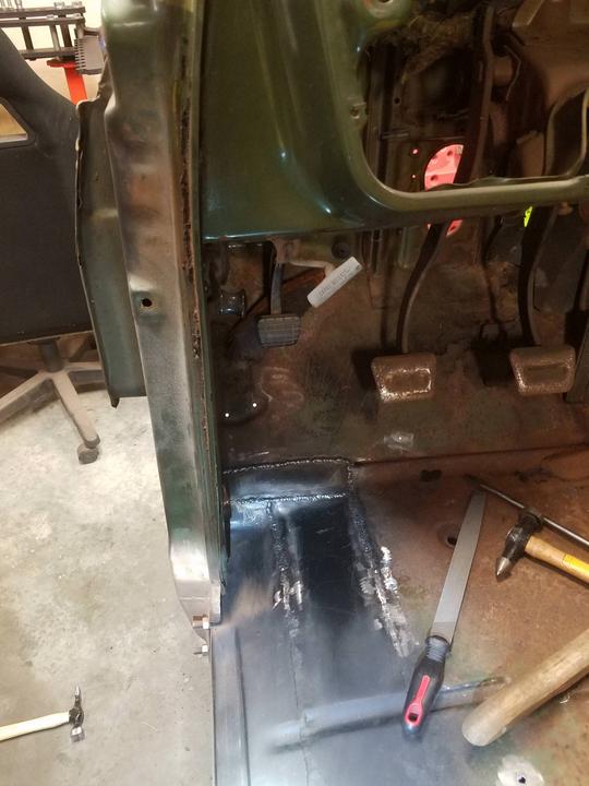

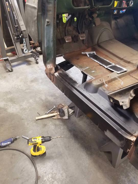

      So once I got the new cab, I began cutting out the rust and welding in new metal. Here are some pictures of that process.
      Name:  new inner rocker.jpg
Size:  58.4 KBName:  new cab rocker last pic before birth2.jpg
Size:  56.6 KBName:  new cab.jpg
Size:  53.7 KBName:  new floor.jpg
Size:  49.1 KBName:  new cab rocker last pic before birth.jpg
      And shortly after that last weld was complete on the cab's sheet metal repair, I am talking 5 minutes or less, my wife went into labor and we were on our way to the hospital to welcome our first child into this world!

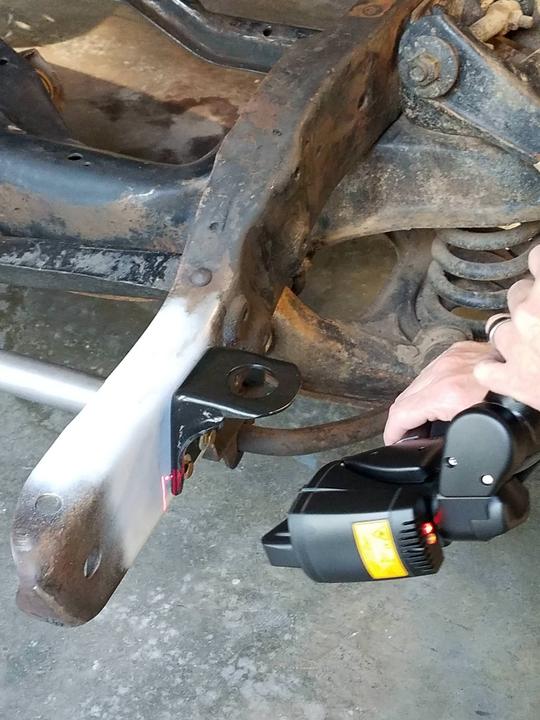

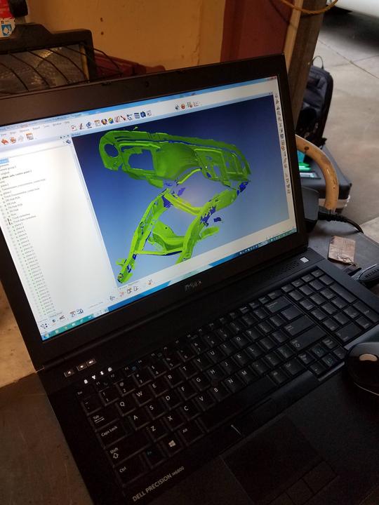

      So after our son was born, I didn't have a lot of time to spend in the shop, so we got to more of the fine detail planning. The original plan was to go with a LS motor, T-56, 9 inch rear, front drop member kit and a rear step notch, full coilovers, and keep things as light weight as possible. However, that plan quickly changed. Some friends of mine, Adam and Alan from Skoons Hot Rods, built a Chevelle that was a full custom chassis that utilized a C5 Corvette drivetrain and suspension. Well, long story short, they convinced me to do a full frame with C5 Corvette suspension. We are still working out the details of the drive line (specifically what we are using for the rear diff).

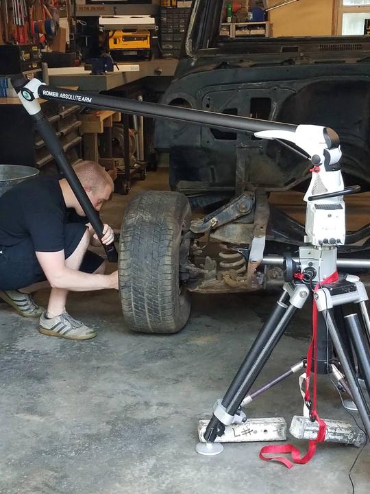

      So once we decided on this direction for sure, we started designing the frame. The first thing we did was measure the stock chassis with a ROMER Arm. For those of you who don't know what that it, it is a portable Coordinate Measuring Machine (CMM), sold by Hexagon Manufacturing Intelligence. These things are super accurate (can measure to about 0.001”-0.003") and can measure just about anything. They are typically used in a quality control or reverse engineering role. The arm we used has a laser scanner on it so you can gather several hundred thousand data points per second. Probably a bit overkill for this but hey, utilize the resources you can right?! We measured the frame rails, body mounts, axle center-lines, firewall, and just about anything else that is important.
      Name:  measuring stock frame2.jpg
Size:  64.0 KBName:  measuring stock frame.jpg
Size:  69.9 KBName:  cab scan.jpg
      Then I gave all of this data to Adam and he began the CAD design.

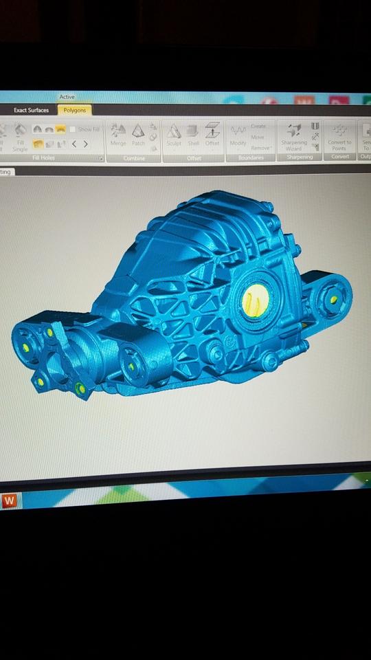

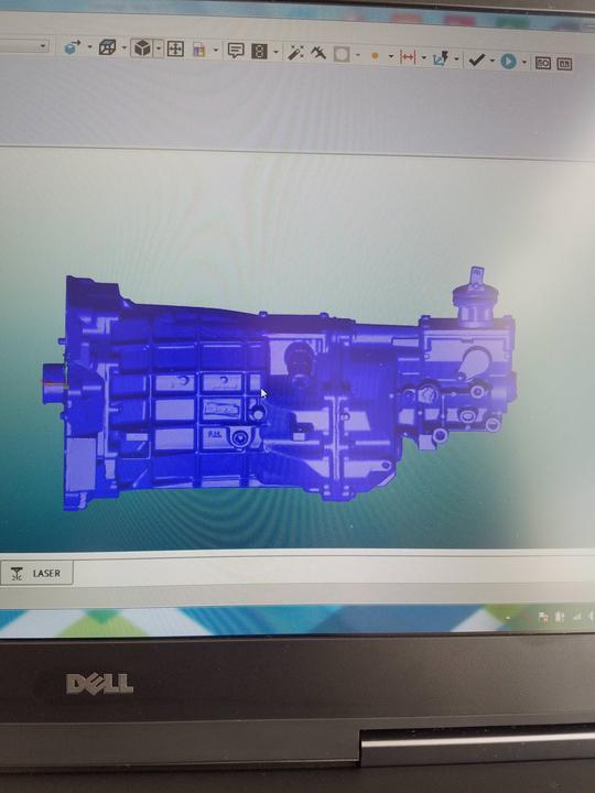

      While I was at it, I laser scanned the T56 transmission and Gen5 Camaro rear diff so we could use those for modeling purposes as well.
Size:  34.5 KBName:  diff scan.jpg

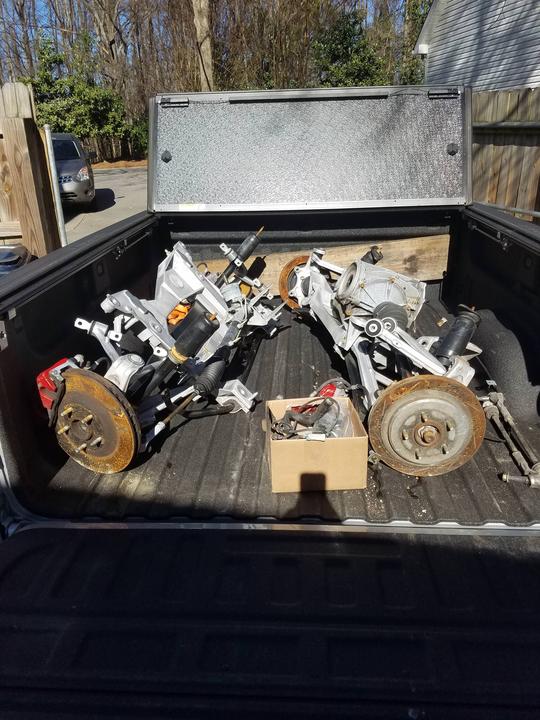

      Also picked up the C5 suspension from VettePros in Charlotte, NC.
      Name:  c5 suspension.jpg

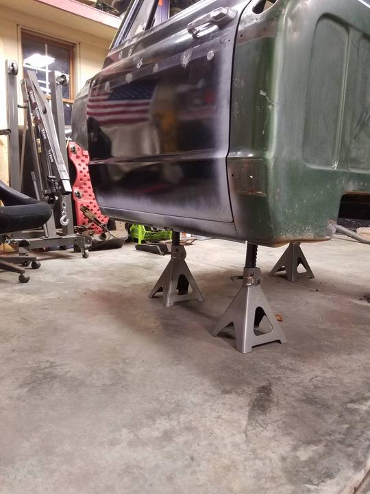

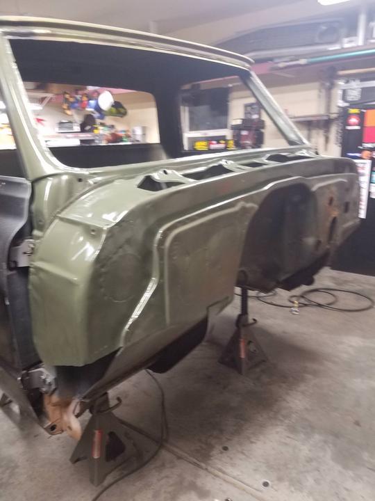

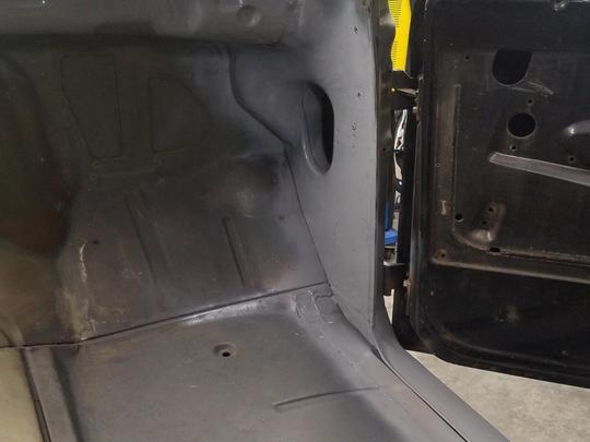

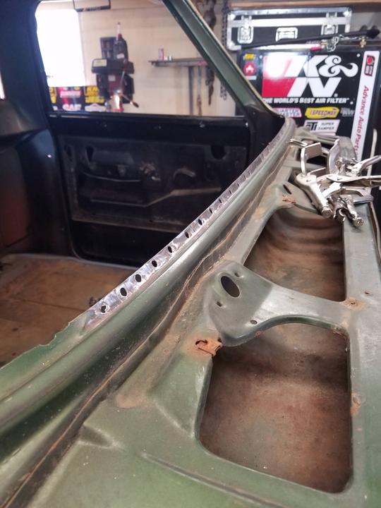

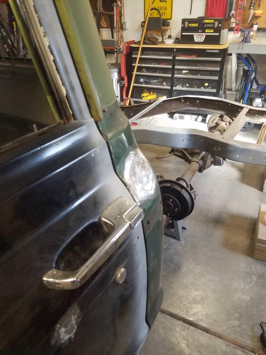

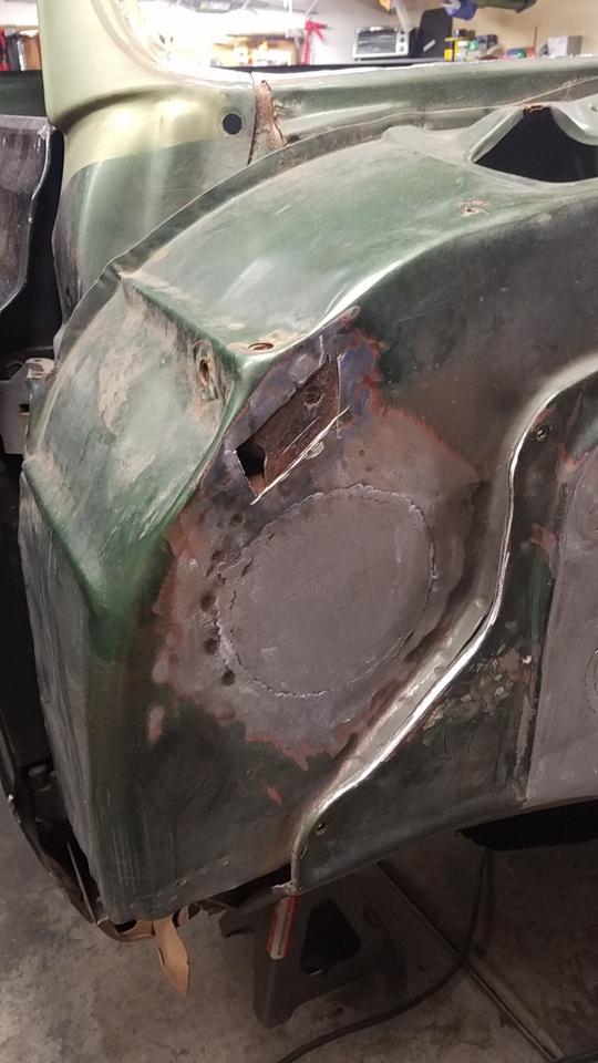

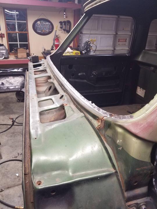

      So after picking up the suspension I got back to work finishing up a lot of the metal work on the cab. I filled the stock fuel filler hole and since I am not running A/C in this truck I filled those holes on the firewall. I am also doing some sort of custom dash that works better with the cage so the stock dash was removed and I replaced the metal on the back side of the lip where the windshield sits.
Size:  58.2 KBName:  windshield channel 2.jpg
Size:  53.5 KBName:  firewall.jpg
Size:  33.4 KBName:  hvac.jpg
Size:  64.4 KBName:  windshield channel 1.jpg
      Just threw some rattle can paint on it to keep it from rusting until i get the rest of the fab work done on the cab and can start body working it.
      I also repaired the kick panels.
      Name:  kick pannel.jpg
      Now its time to move on to repairing the rusty doors....yay. Once I have that done, I will post the pictures.

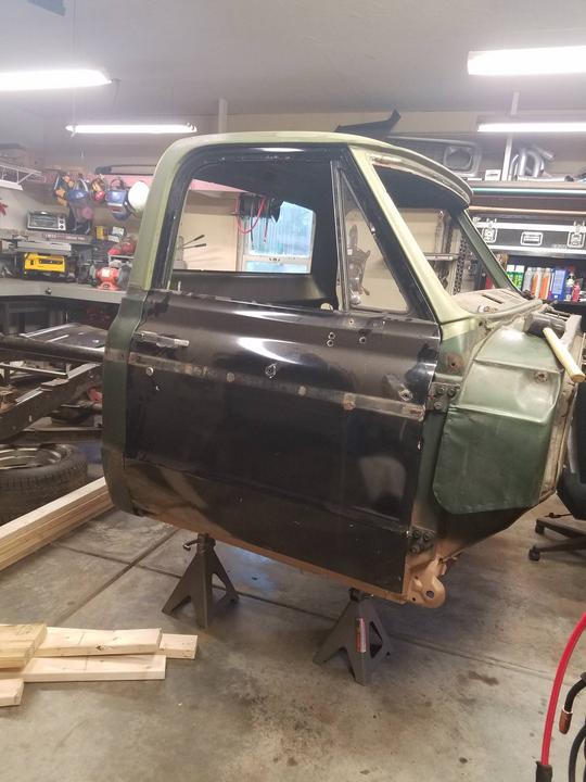

      It has been a while since I last posted an update on this project but it is still alive. Had a lot going on lately that has limited the amount of time I could dedicate to the truck. Work trips, home repairs, holidays, etc have all gotten in the way but I am finally finding some more time to get on this project.
      So here is an update on the project. Started fixing the door bottoms. The inside panel was shot and the bottom outside corner had some bad rust. I cut it all out and began making the patches. I fit the panels and patches pretty well and was really careful about getting too much heat in it but still ended up warping the door a bit. I think it was because the part I had to cut out on the outside bottom corner was really close to the edge. It can be fixed, just going to take some work.
      Still have to repair the driver door. Saving that for another day. I have had enough of the sheet metal repair for the time being.
