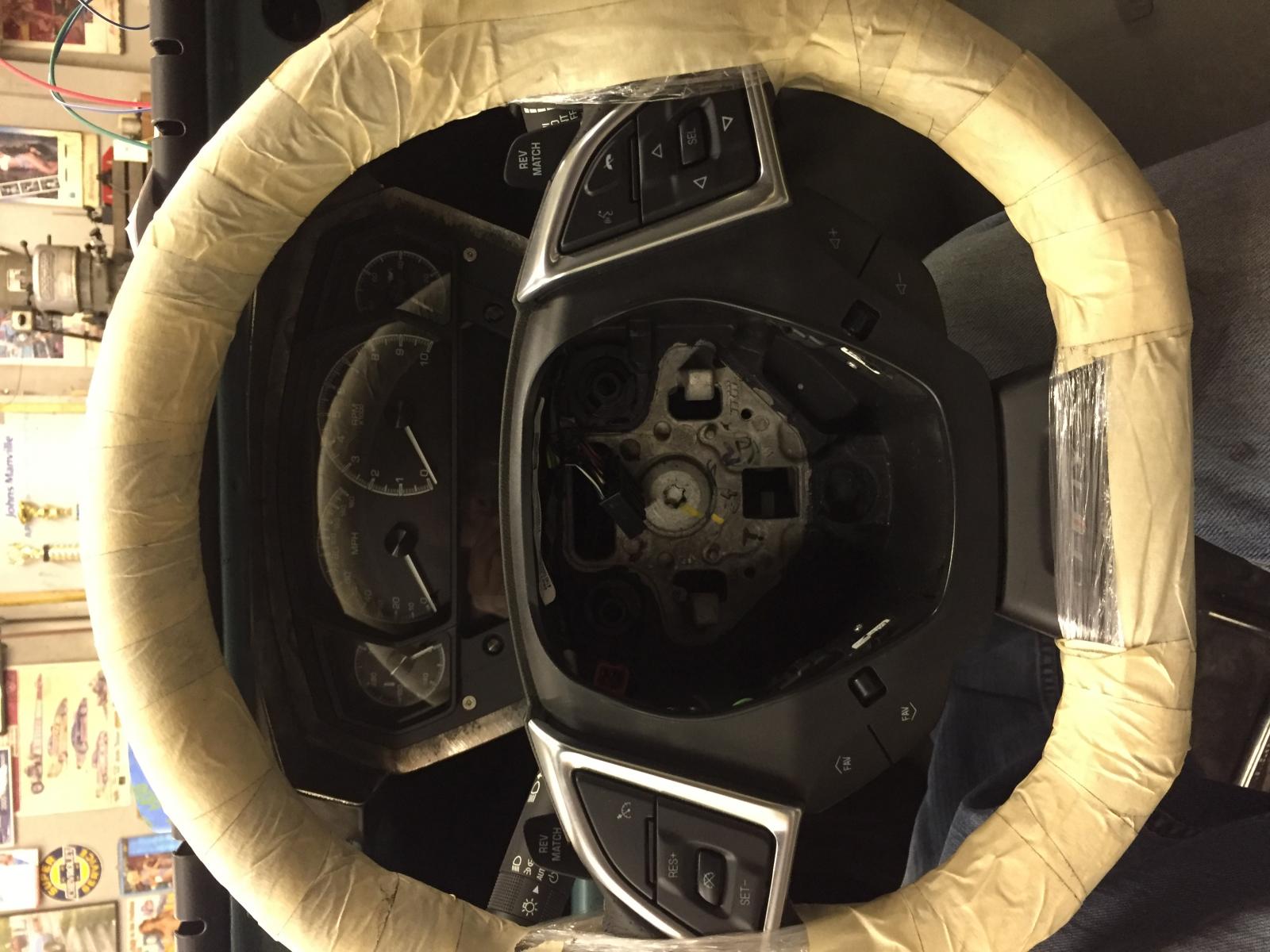

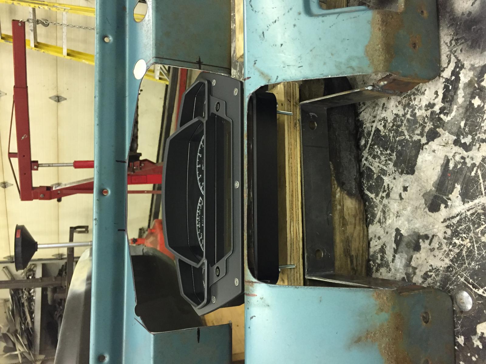

      Just got my new cluster in from dakota digital. It's a brand new release for them. The quality is top notch. Now I just got to get it mounted in the dash. Some modification will be required. Haha
    4. #44
      Oct 2015
      94
      Started cutting in cluster
    5. #45
      Oct 2015
      94

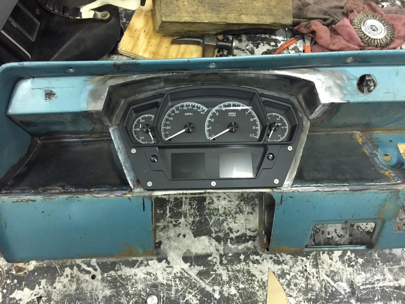

      Got the cluster mounted , now I have to fill in the sides.

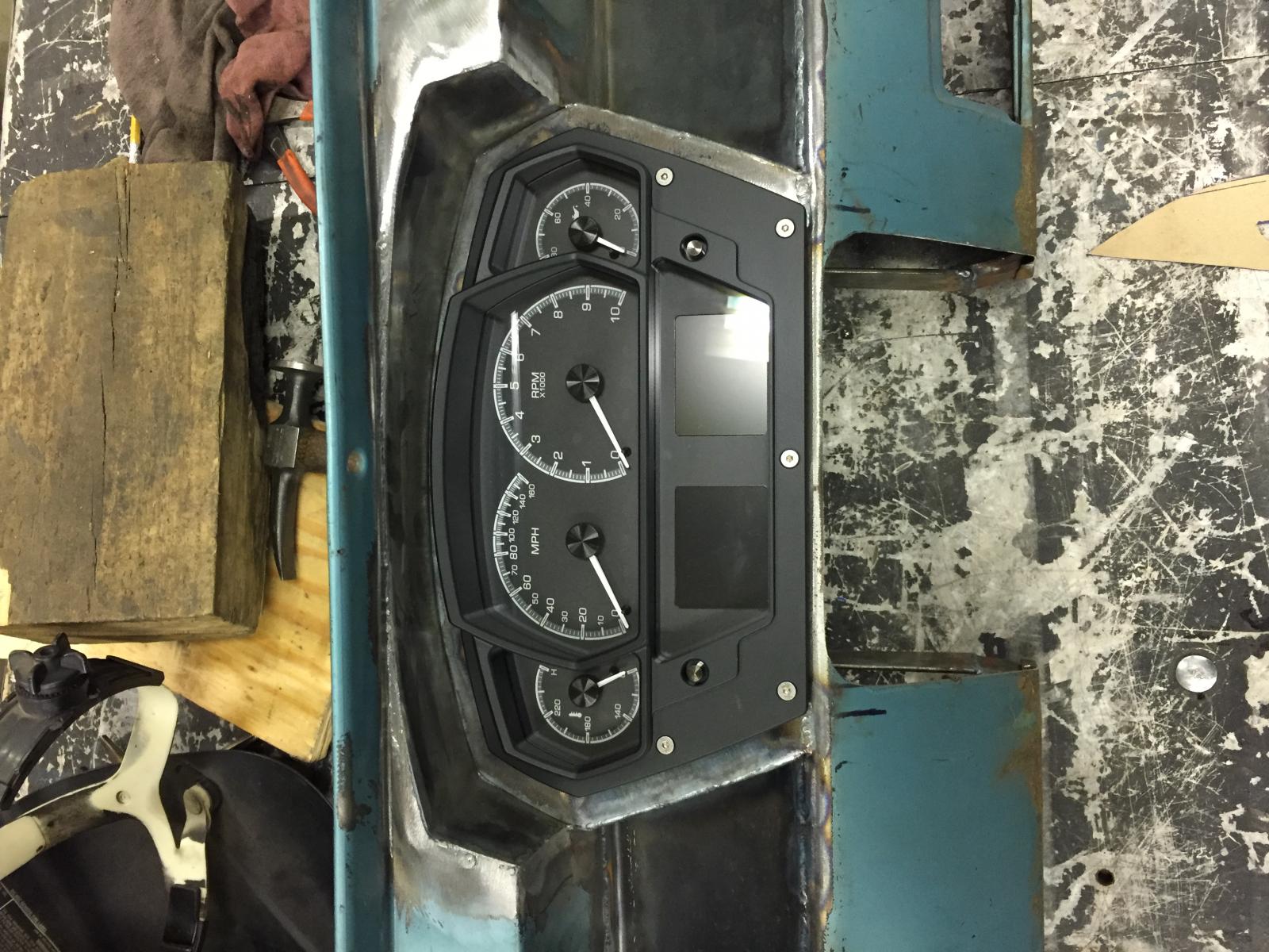

      Finished off mounting cluster

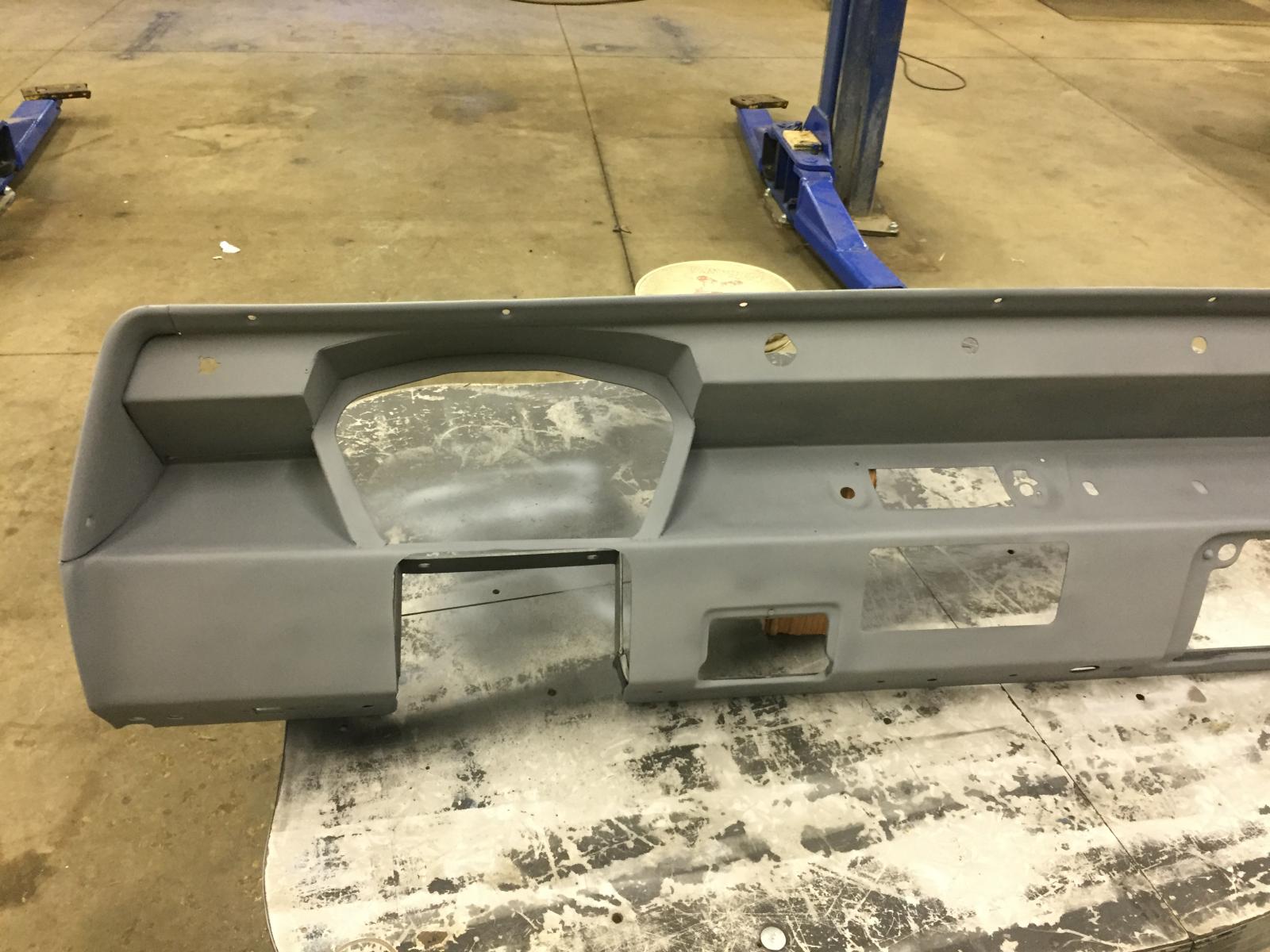

      Thanks pittpens24, looking back it's going pretty fast but at the time of doing it, it seems to take forever. Here's a pick if dash all cleaned up and a little primer to keep from rusting till I get time to do body work.

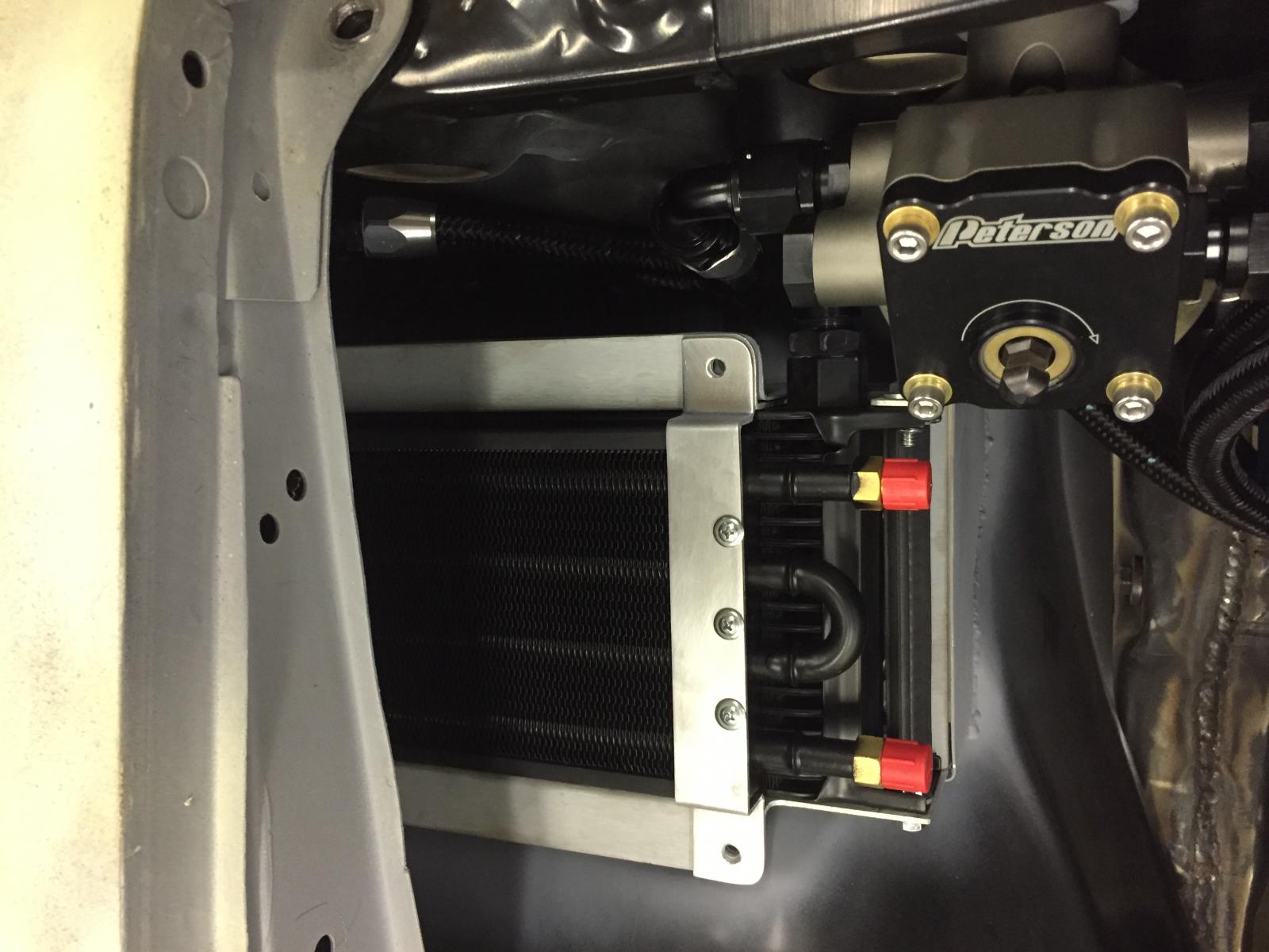

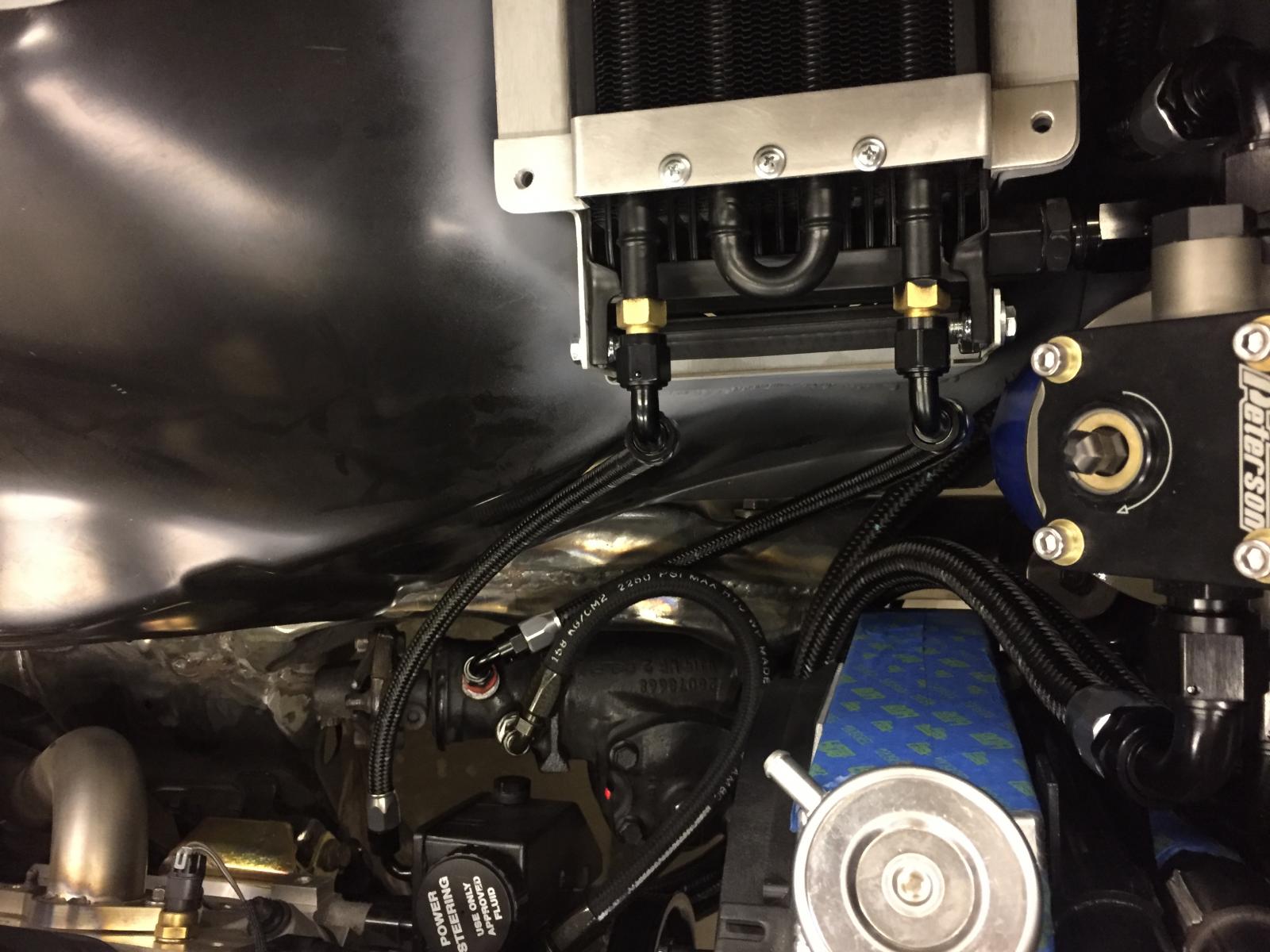

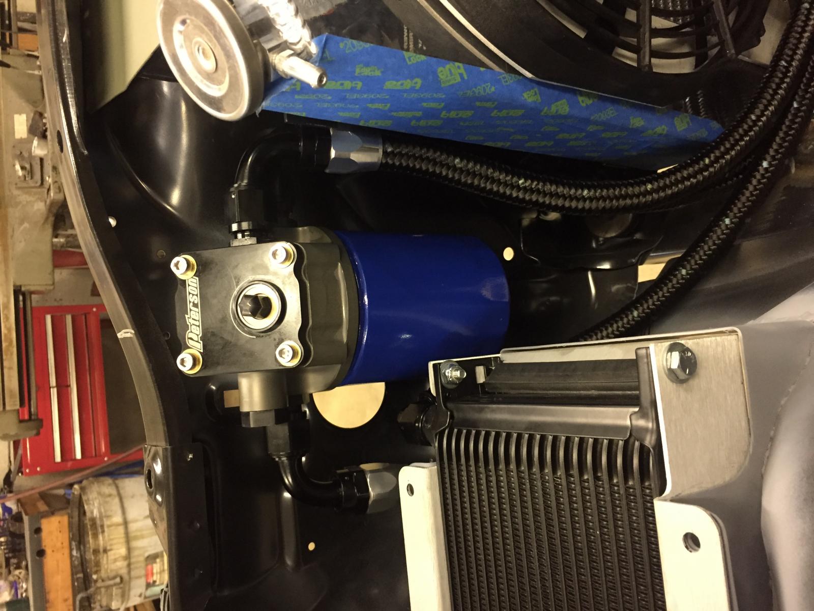

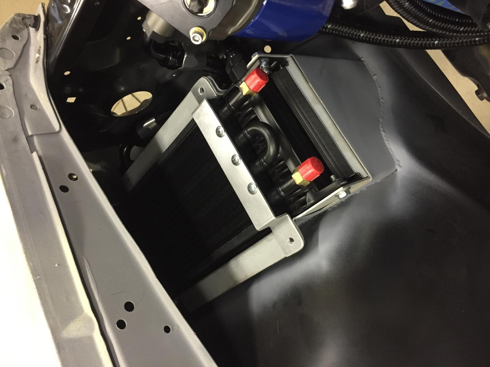

      Here's some pics of power steering cooler I stacked on top of engine oil cooler. Oil cooler has twin 5 inch fans on it so they should move enough air for both.

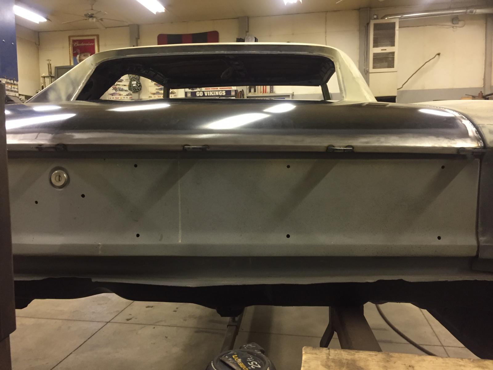

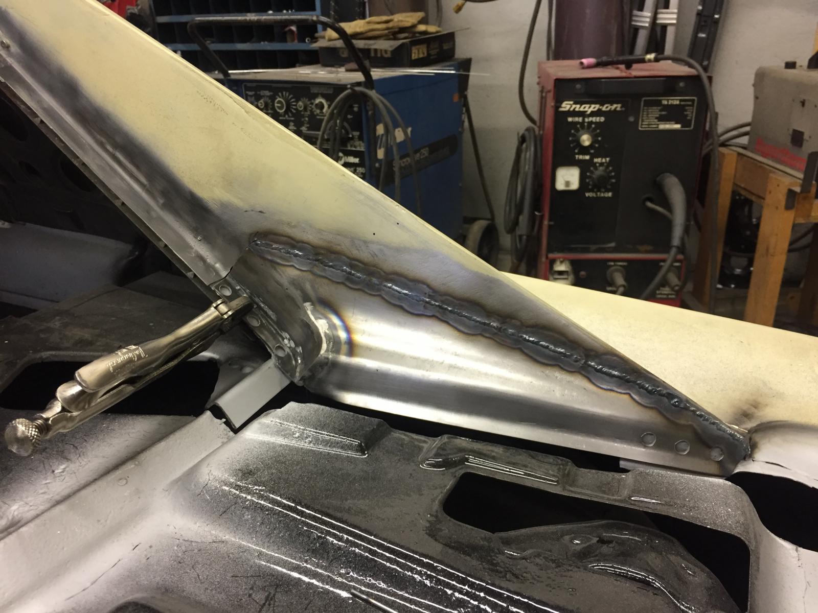

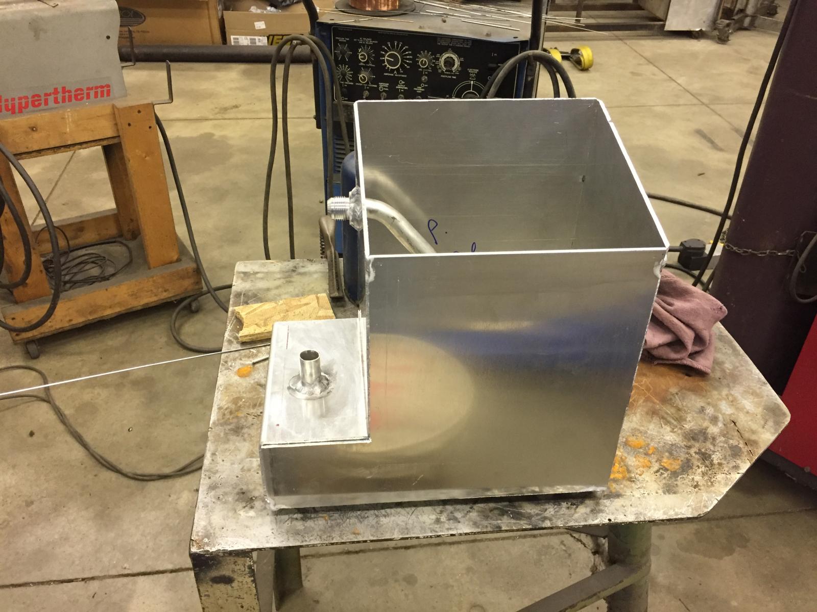

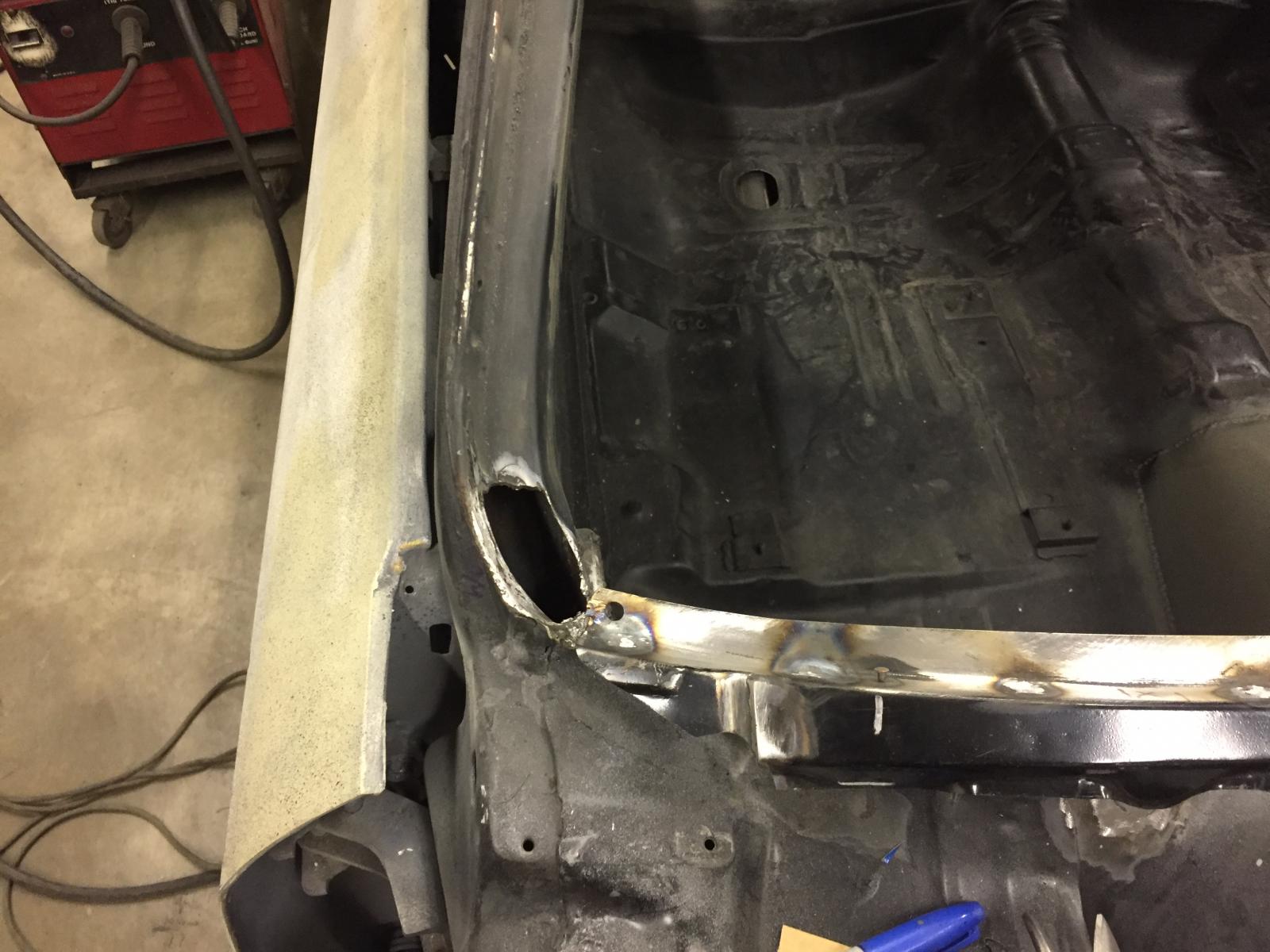

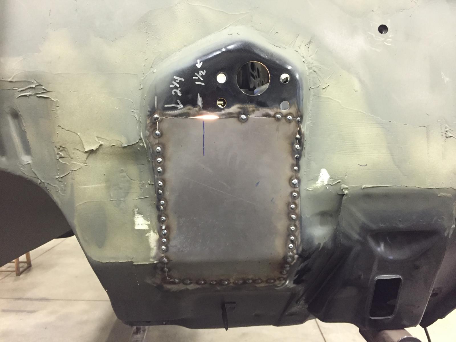

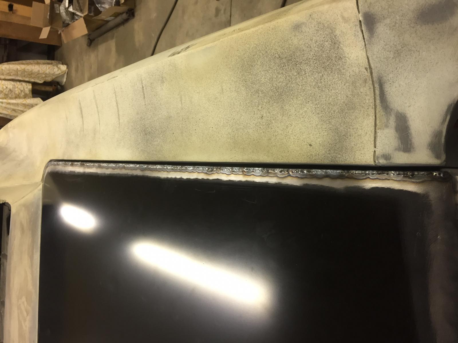

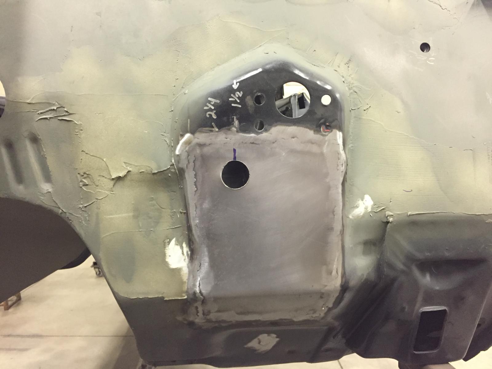

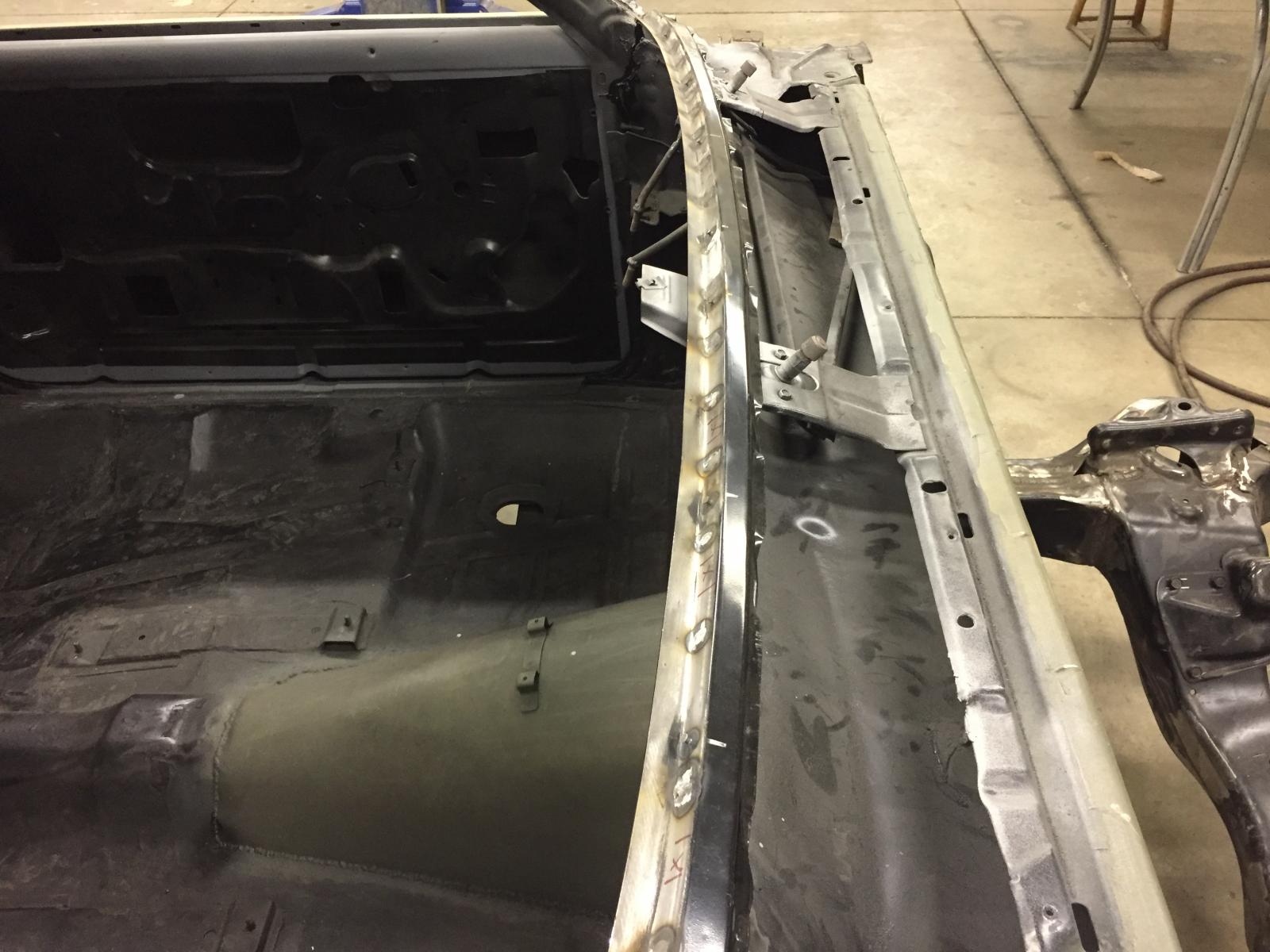

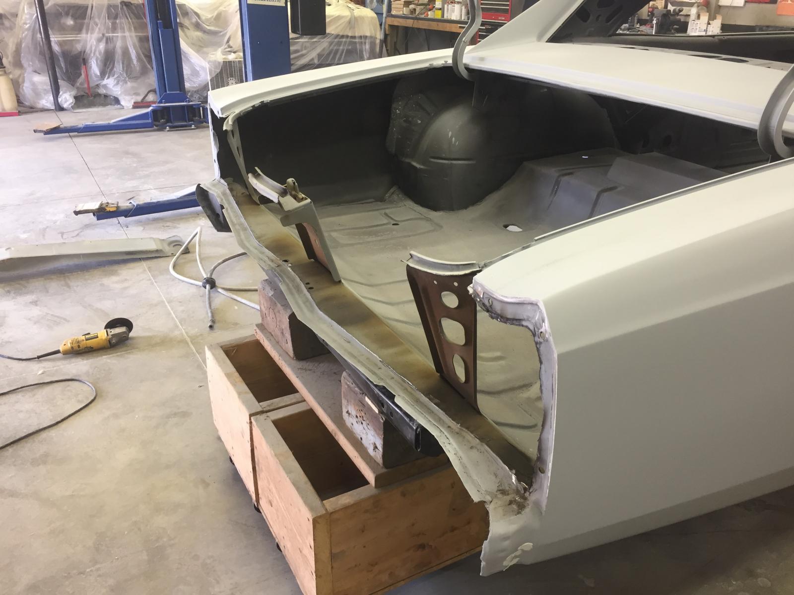

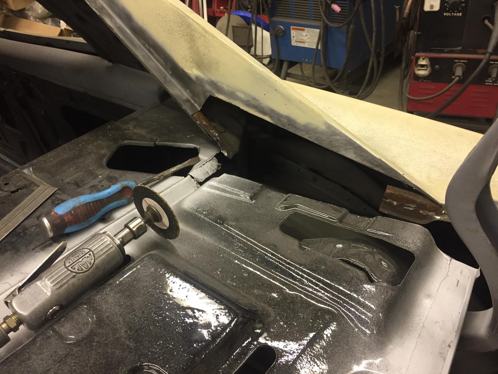

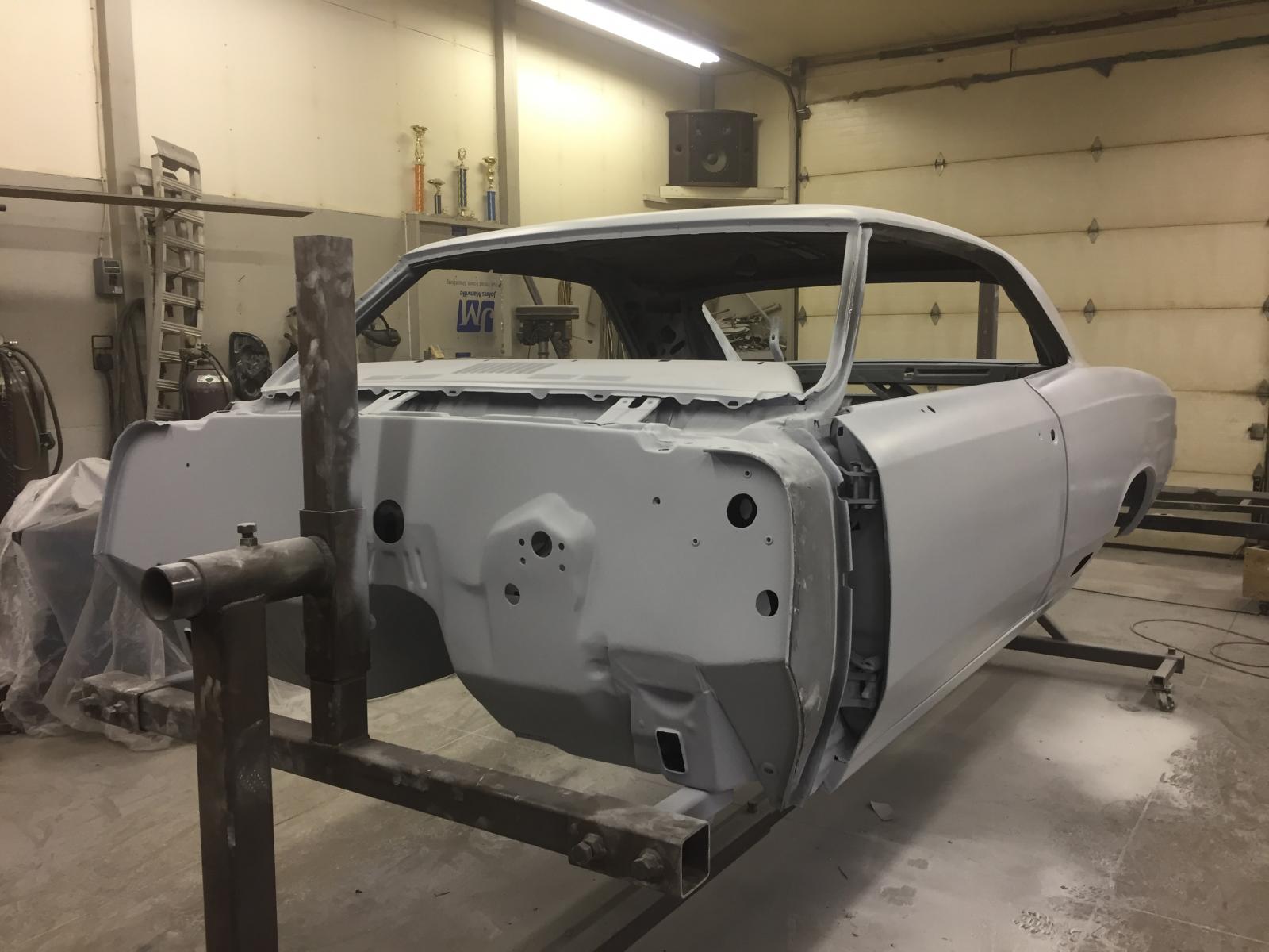

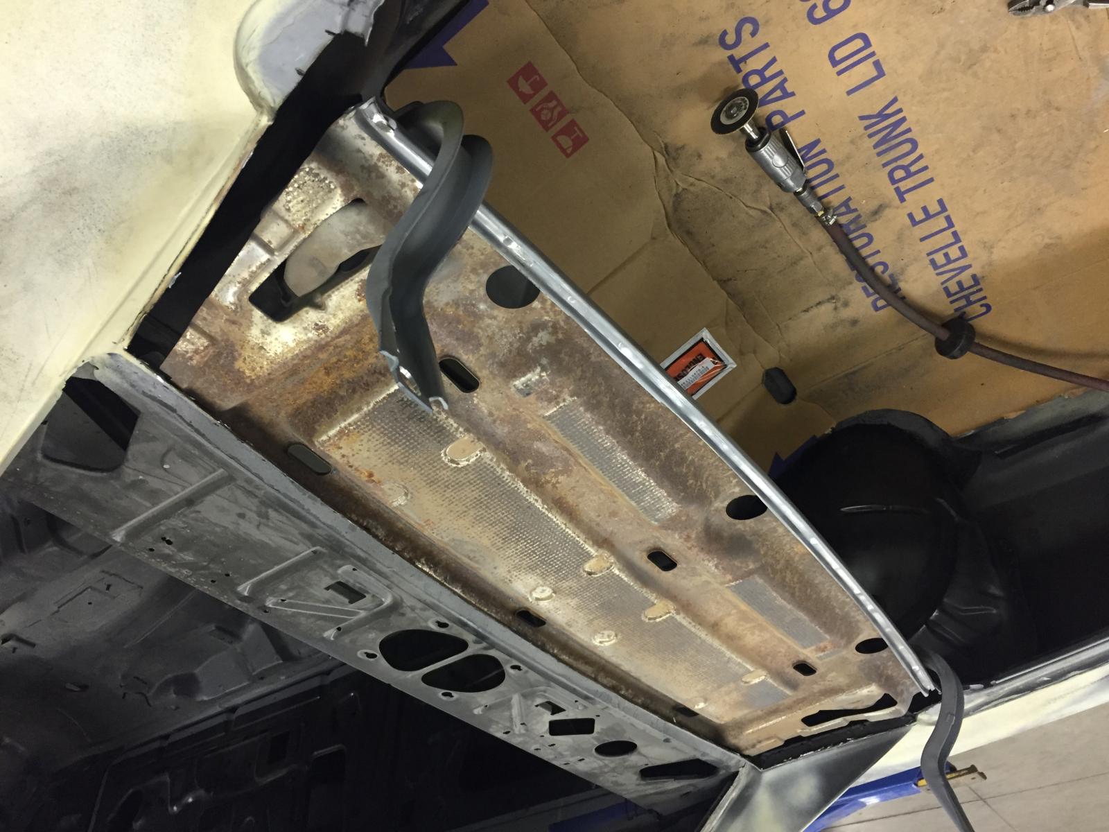

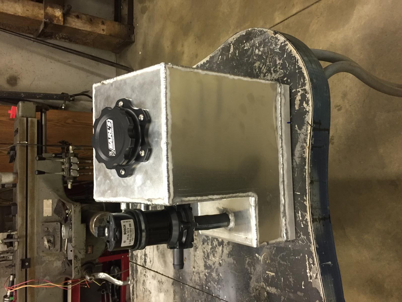

      Hello everyone, it’s been a while since last post, been doing a lot of sporting events with family. What I have been doing to car is kind of boring stuff. Fixing problem areas in body work that was started by someone else. Here are some pics of what I got done. Also I built a water tank that goes in the rear for the supercharger intercooler. I also did have car running before I totally disassembled it to do body work.

      More pics
