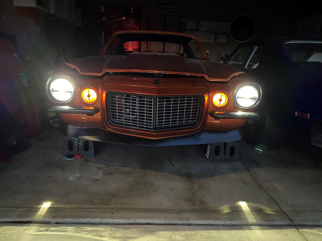

      Got the car wired up and love how bright the Truck Lite headlamps are. Was able to get the car fired up - no leaks!

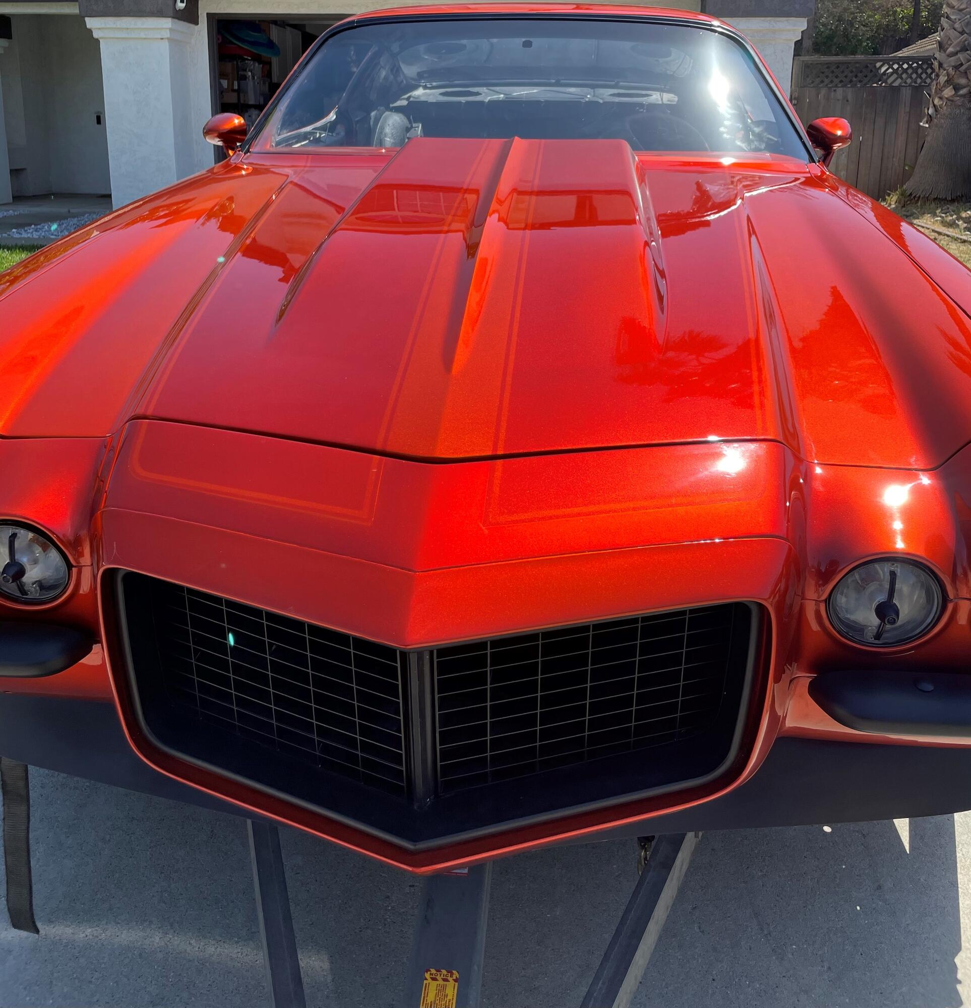

      Finally received the car back from paint for the final time. Finishing up the engine bay and wiring. Next step is to get the driveshaft built and shift installed.
      Has anyone installed a 6L80 tap shifter in a 2nd gen? Seems to sit pretty tall on the tunnel.

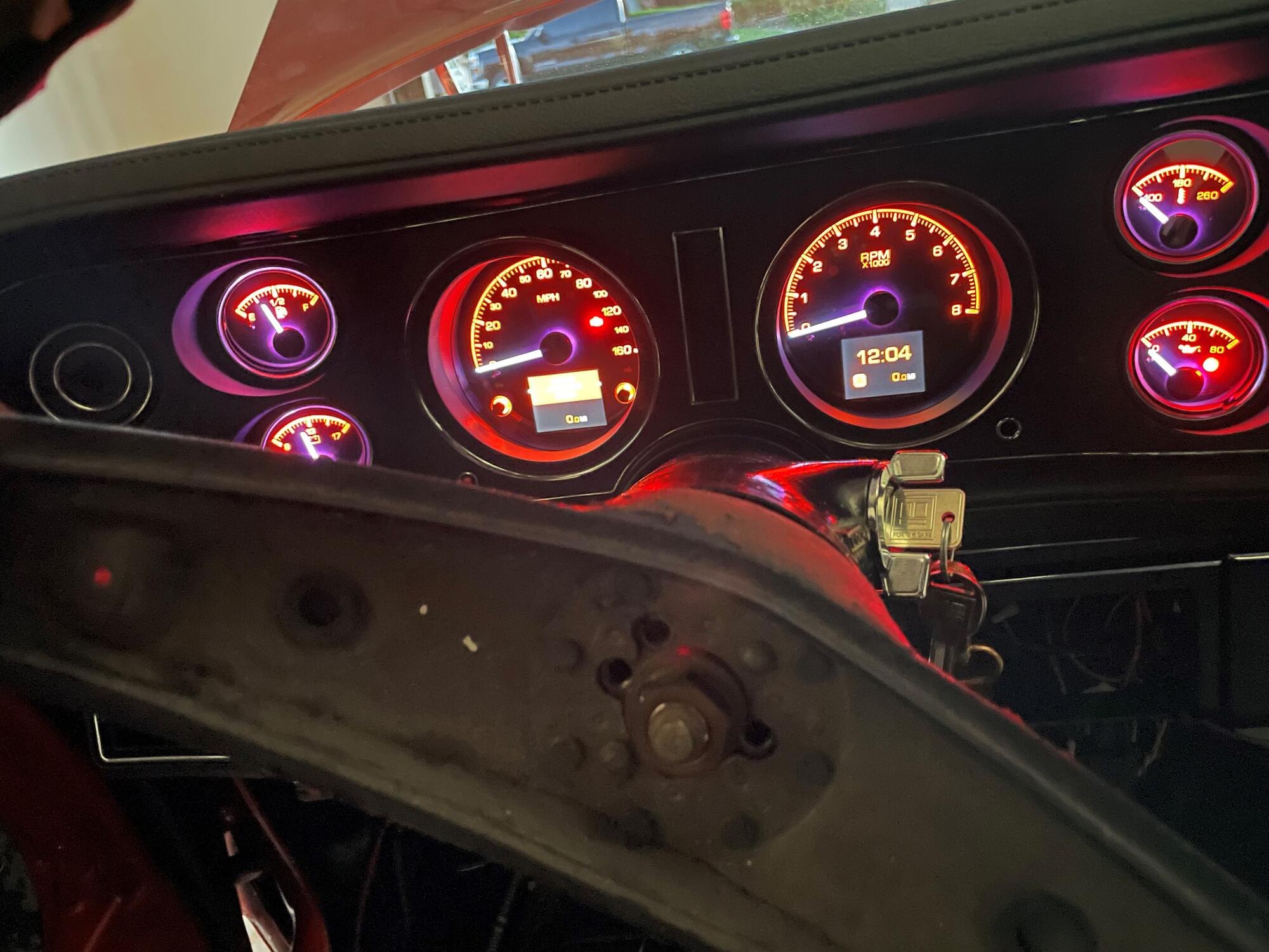

      It's been a while but things are coming together. Wilwood 6 pistons up front, Dakota Digital HDX dash. Trying to get everything ready before my interior appointment in 6-8 weeks.

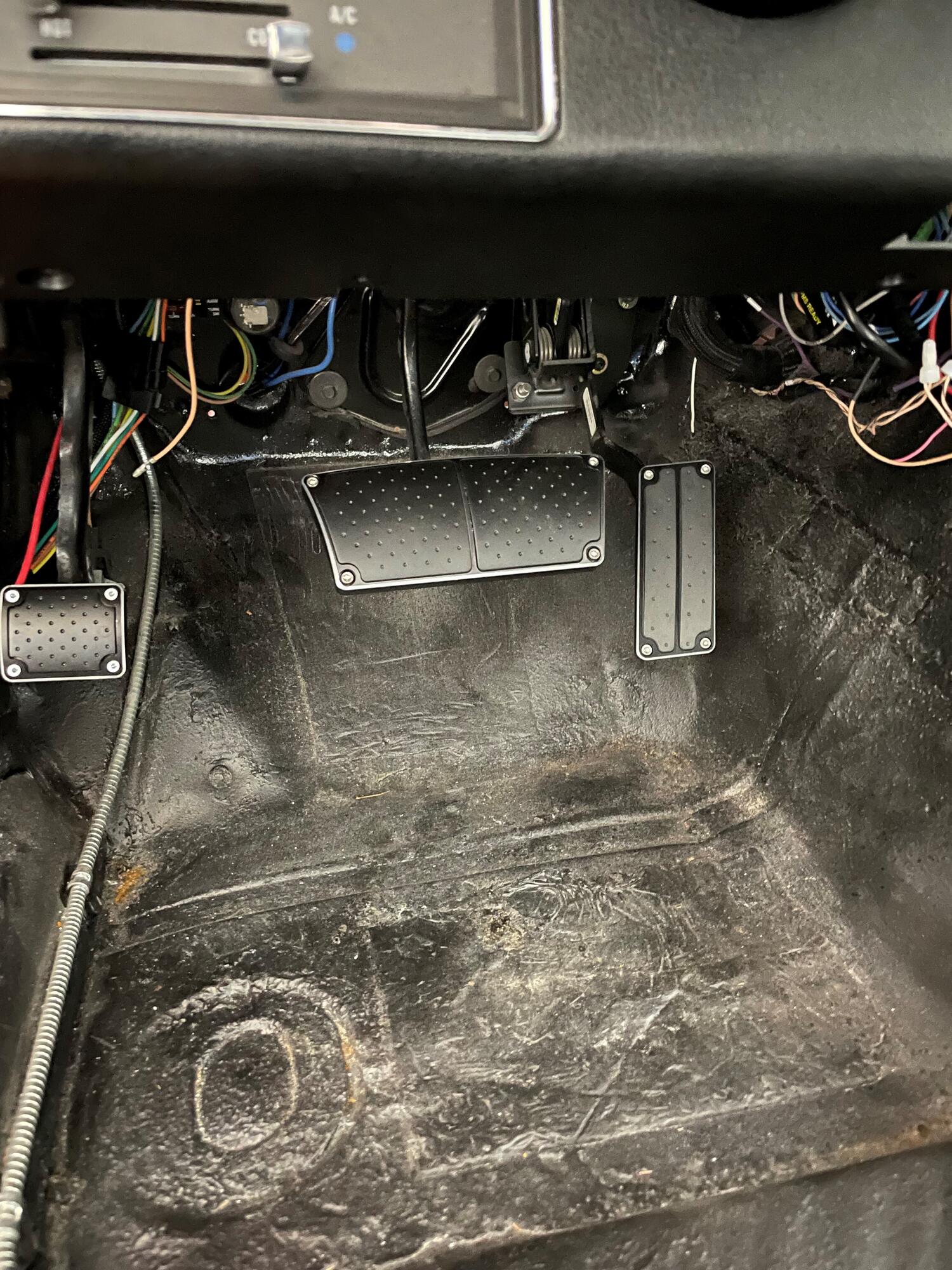

      How hard was it to get the clayton gas pedal mounted to the stock DBW unit?
      Sep 2013
      Oakley, CA
      108
      Quote Originally Posted by linenoise View Post
      I had to use the DBW mount from PSI Conversions. It was pretty simple with that mount.
      69 Camaro LS3/6L80e
      70 Camaro RS LS3/6l80e
      74 Nova 434 SBC
      Aug 2021
      2
      Wondering same thing. how hard was the clayton gas pedal cover to mount to the LS pedal unit? Can we get a pic of the back of that pedal so we can see how it mounts to the LS pedal part?
      Sep 2013
      Oakley, CA
      108
      Unfortunately I do not have the car with me, it is currently in the interior shop 6 hours away. But here is what was done to make this work.
      I had to swap the DBW pedal from the 2014 Camaro with a 2007+ Corvette pedal from PSI Conversion ACC-1007. This part bolts up to the firewall like a stock 70 Camaro pedal.
      I removed the old style pedal cover and put Clayton Machine Works TA-206-DBW pad on to replace the pad that comes with ACC-1007. They both use pin and E style clip to secure the pad onto the assembly.
      You do have to swap the wires from the ECU to match with the new DBW assembly. I have to double check but if I recall correctly, I swapped dark blue and light blue. there are write ups on the wire swap for the 07+ Corvetter DBW.
