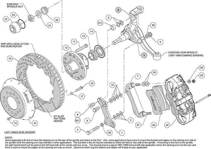

      Thanks Rod. Found some good stuff. My biggest priority is finding spindles that will fit my QA1 Suspension, 18" wheels, 14" Wilwood brakes and Flaming River power steering. I did find through Suspension geek that ridetech has a set of 2" drop spindles I would like but it appears that I would need to buy some stock steering arms and one thing I don't know is if the brakes calipers bolt directly to the spindle or is there is a bracket I need.

      those spindles will take any A-F-X body brakes, the willwoods you have should have a bracket that mount to the spindle.....what steering arms do you have?
