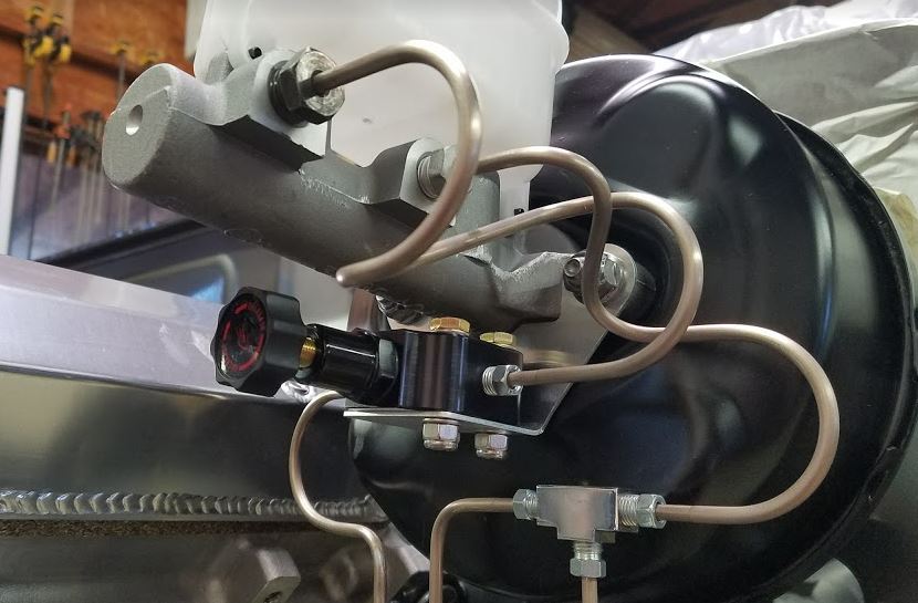

      Kinda Like this?
      S10 Master, Corvette Booster, Baer PValve, DSE low angle brackets to the firewall, custom made lines
      Bolts right up on a 2nd Gen, Slight tweaking of the hole in the firewall

      Where'd u get the T block / 3 way block??

      did you have to do anything to the push rod?

      Tee Block

      Pontiac heads behind that MC in the picture?

      Yep, Kauffman's prepped by Dave at SD. Nice catch Skip.

      Could tell by the A/C-accessory bosses there. Have a few around to look at
      Nice clean setup.
