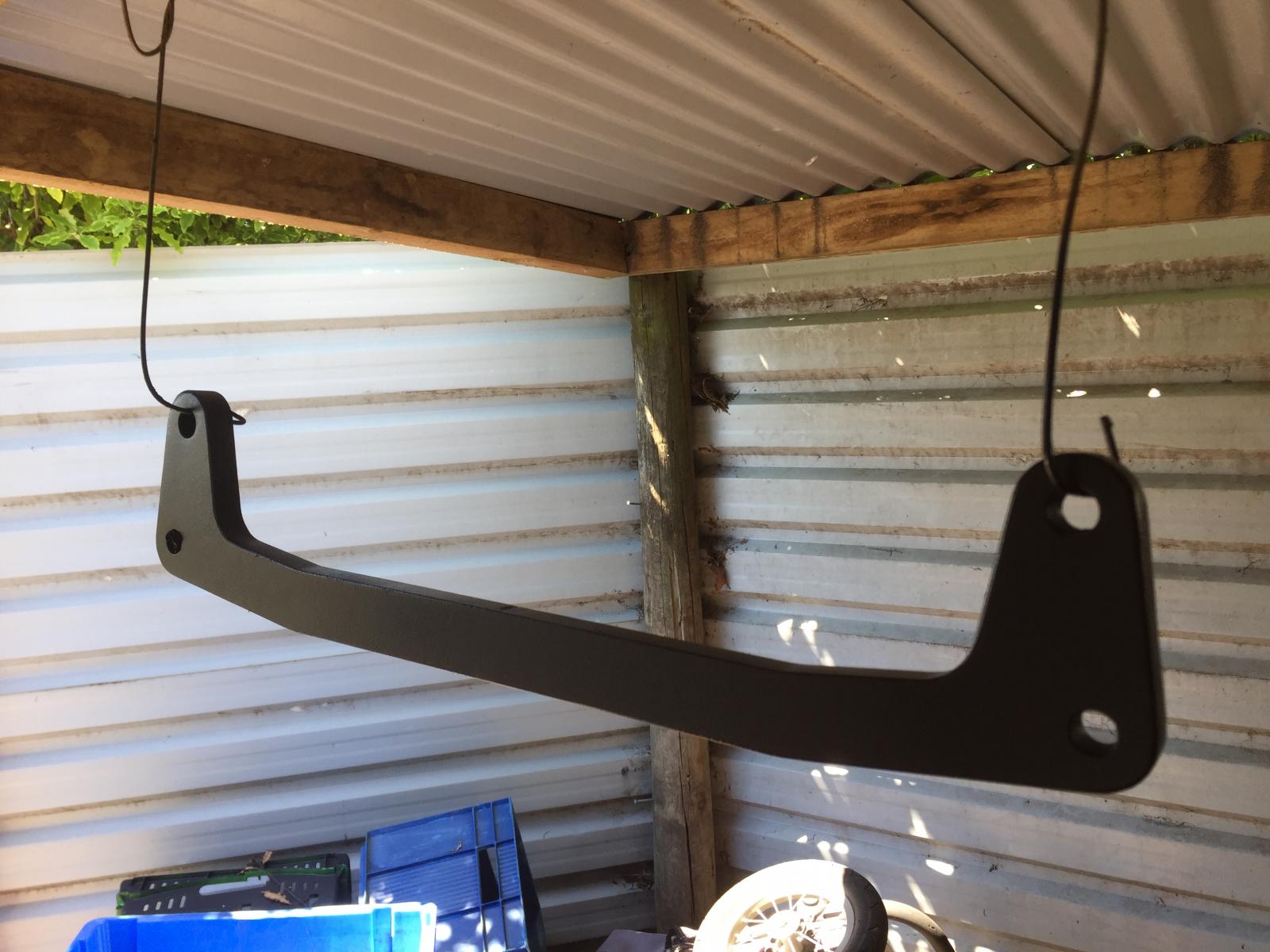

      New drag link, custom to my car. Bottom holes to match OE drag link. Done away with ridetech slot. Didn’t mention before but that would have failed also.

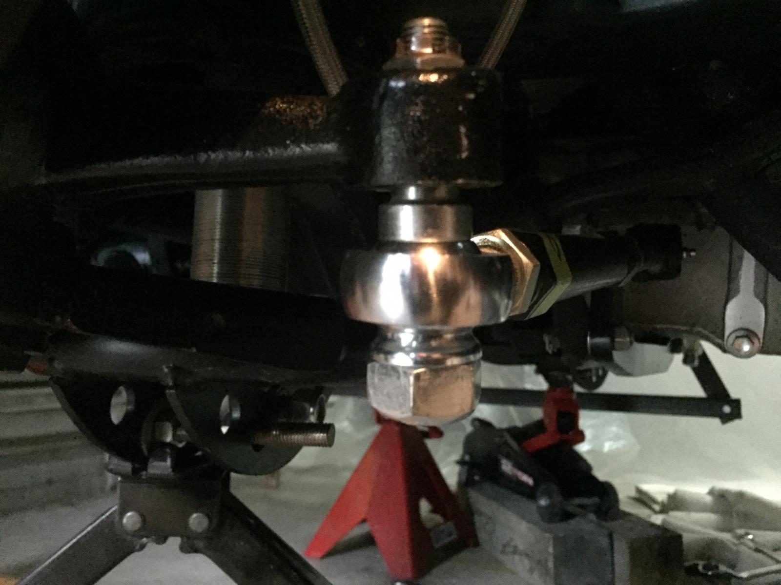

      Another thing that failed on the truturn was the outer tierod heim joints bind on the lower nut.
      Easy fix, tapered spacers to allow heim joint full movement.
