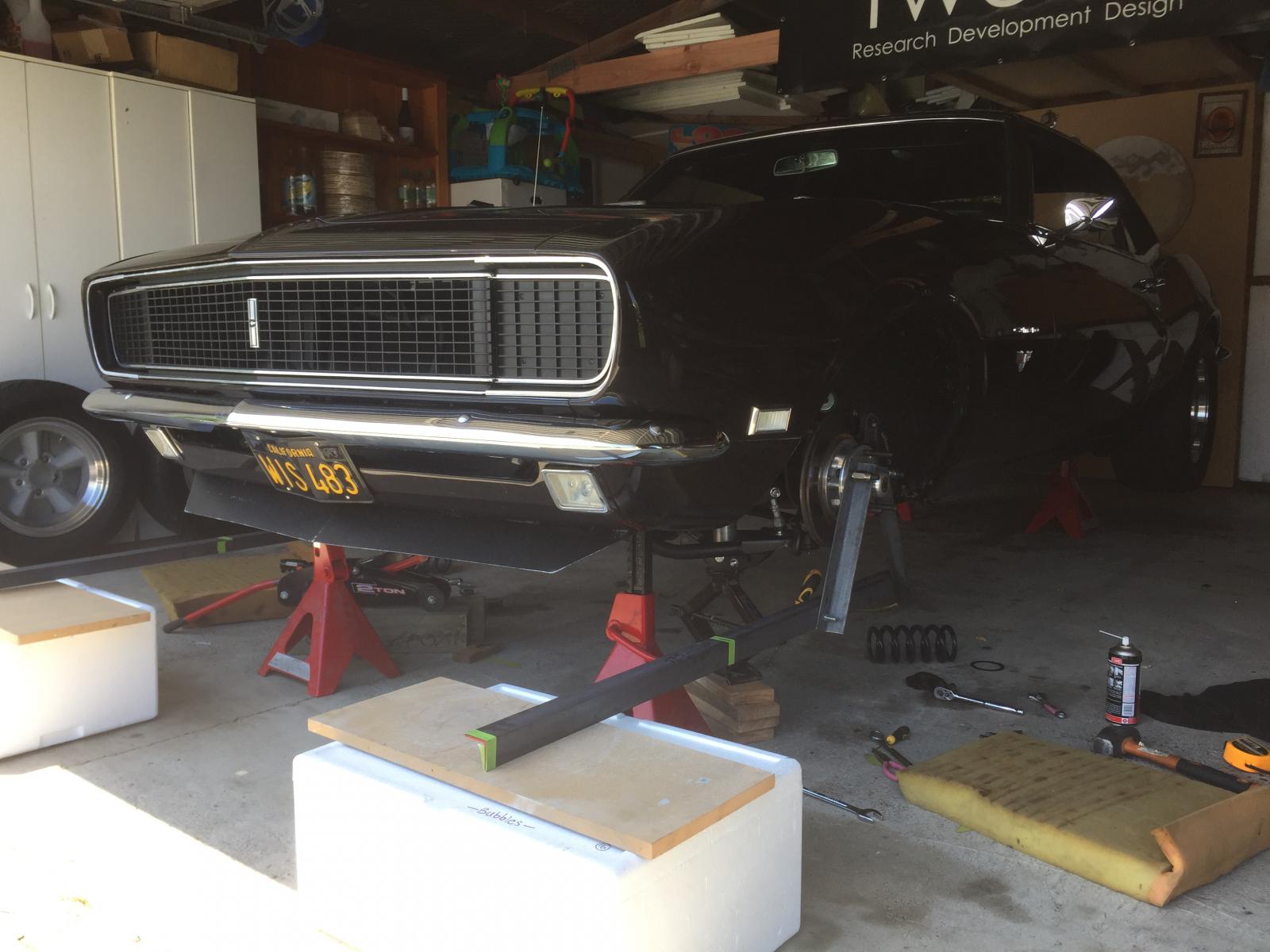

      Hey Bret
      I'm at work now, Monday morning here in NZ, will take images tonight.
      No this system doesn't magnify results at all. Yes it will change overall widths, but the toe angles stay constant.
      If It is 2 degs. at the rotor face, then its 2 degs further forward.
      The two pieces of tape you can see indicate the diameter of the tire. Other wise my ride height toe angle would be off, which it isn't.
      This jig allows you to get very accurate measurements when suspension is fully compressed as the chassis isn't in the way.
      Cheers

      But you gave measurements in inches, not degrees. Those measurements will definitely change if you take them at different distances from the wheel centerline. I would take measurements at the tire radius distance.
      Hey Andrew
      I would suggest you do a simple chalk drawing on the ground of a triangle. Measure the distance of the third angle over a given distance (say 26") then move along the triangle and take the distance of the third angle over the same distance and the measurement will be the same.
      You measure Toe by distance ie. 1/8+ toe, but this is define by the ANGLE of the rotor. Angles stay constant and relative to the other rotor.
      Hope this helps
      Damien

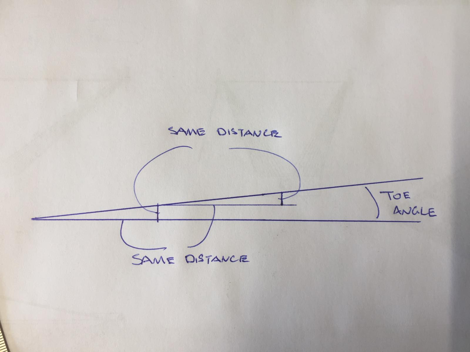

      Quote Originally Posted by Tweak View Post
      Hey Andrew
      Hope this helps
      Hope this helps
      Damien
      Napier, New Zealand
      Project Page: https://www.pro-touring.com/showthread.php?99096-Project-Camaro-68-P-T-Muscle
      Next Project: 1956 Chevy Truck, Full C3 Suspension, Nascar Inspired

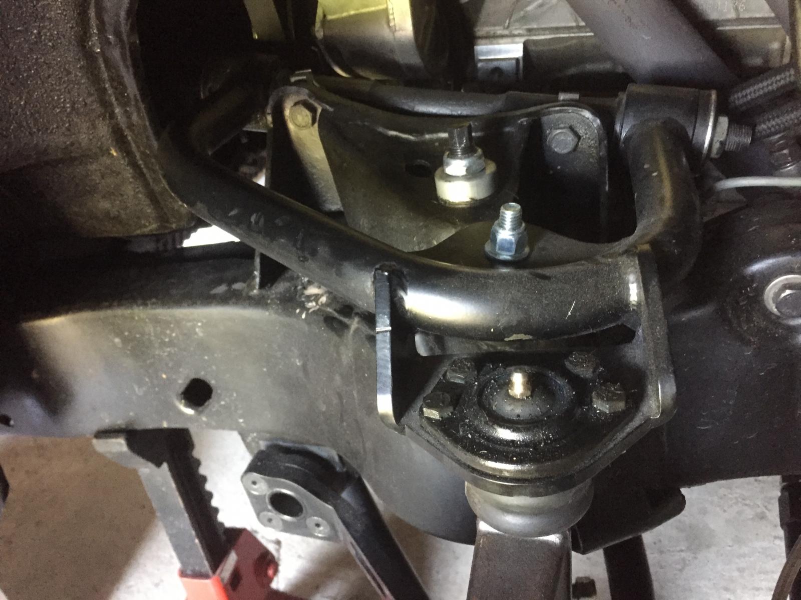

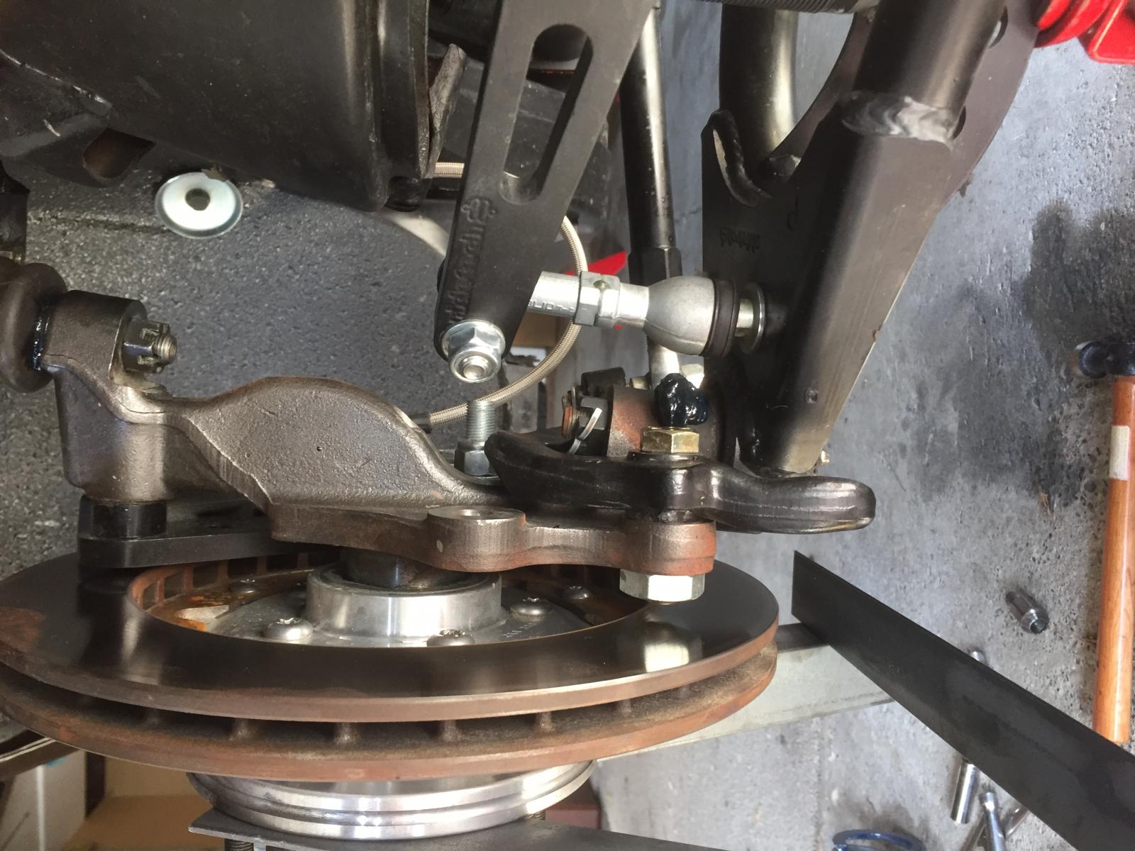

      For Bret
Size:  135.8 KBName:  820FFA58-018D-41D5-8F62-1A382064FF21.jpg
Size:  209.3 KBName:  F2752337-8511-499D-A2E0-AF739F47F06A.jpg
Size:  216.0 KBName:  3BA2F071-CB0E-468E-82EC-80F1F6D971EA.jpg
      Damien
      Napier, New Zealand

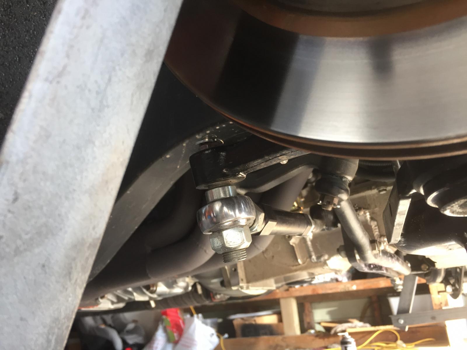

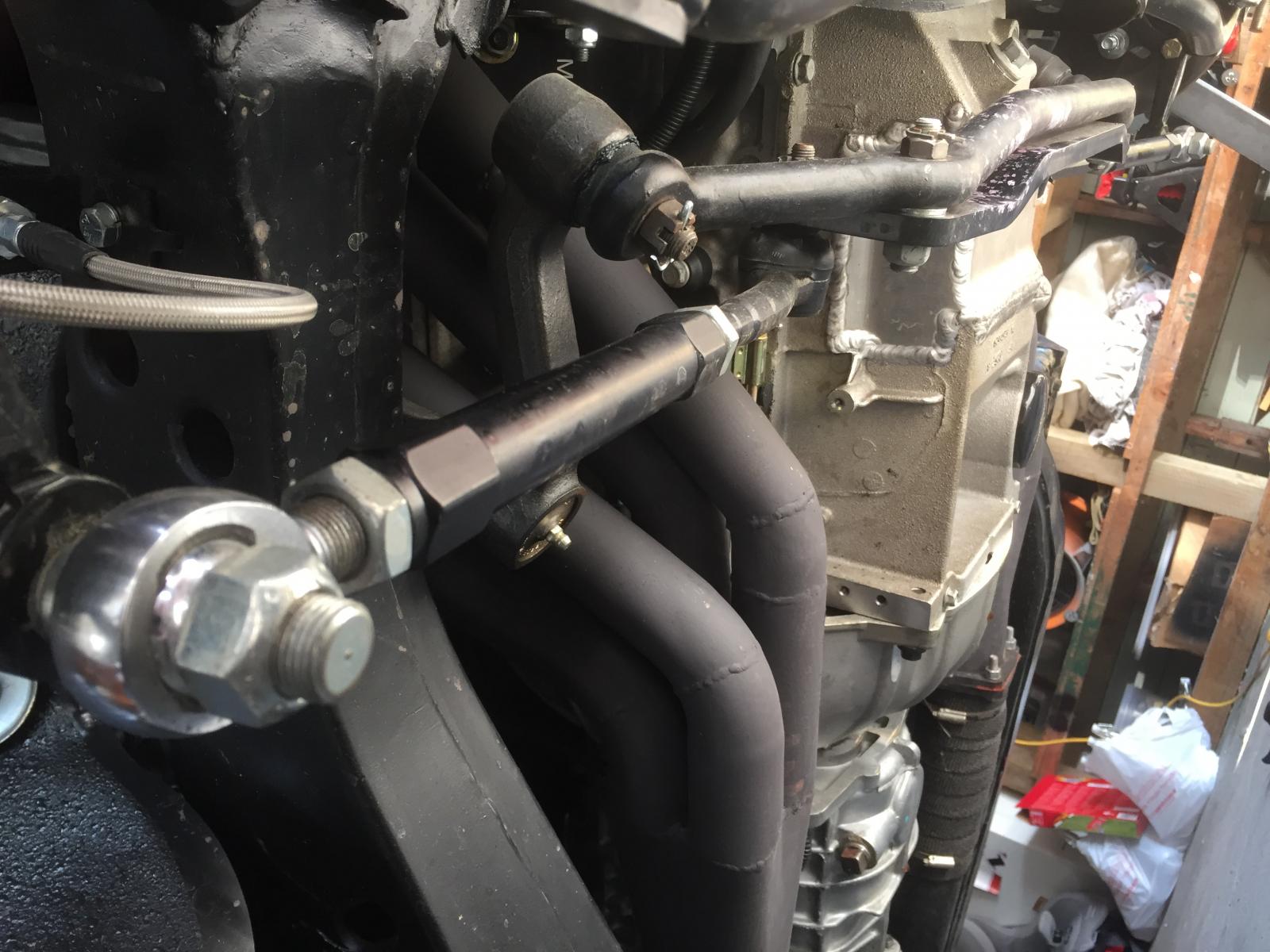

      Anti bump steer Test equipment
      Not sure why, but it appears ridetech have gone very quiet on this thread.
      I have reached the limit of adjustment I'm prepared to go at the steering arms.
      So new test equipment will determine design of drag link and dial out all bump steer.
      Damien

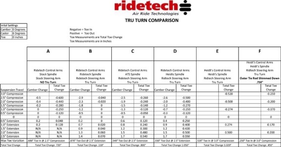

      Name:  Tru Turn comparison chart1.jpg
      Column B is the numbers we measured here at ridetech.
      I'm curious in the length of your idler arm and pitman arm? The chart I posted is with the 5.8" on both the idler and pitman arm. There are 2 lengths that are common, 5.25" and 5.8".
      When you are measuring full compressed and full extended, are you basing those off the shock travel? Dimensions of the shock for this setup is 10.48" compressed, 14.08" extended with 12.55" ride height.
      Rodney Mason

      Hey Rodney
      Yes I have 5.8” on both and have shocks in with no springs
      I am testing travel from bump stop to bump stop of shock travel and ride height is very similar to yours
      I’m starting to think maybe ridetech doesn’t fully understand what bump steer is
      Your chart you provide states at the top toe in is negative toe, when in fact toe in is positive toe
      I’m sure your measurements are correct to your test method, problem is I’m pretty sure your method of testing is incorrect
      The front end of a Camaro isn’t rocket science and I have fitted all components as designed

      You have yet to tell us your alignment settings. As more positive caster is added, the steering arm is lowered, which affects bumpsteer.
      Just looking at your images the shims on the upper control arms appear to be about even (though difficult to tell). If correct, that means you don't have much caster in the alignment as it sits.
      Let us know what you are running for alignment and we'll go from there.

      You must keep the angle irons level in side view when jacking up your suspension. If you let them droop as you raise the suspension, any camber change will affect the toe angle of the irons IF they are not kept level.
      As Brit said, your caster setting affects the height of the outer tie rod ends, & bump steer. More caster = less toe out in bump.
      I do think trying to get perfect bump steer over the whole range of suspension travel is pointless. The car doesn't operate there. I would look at 2" of bump, and 1" of rebound, but it's your car.

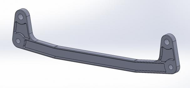

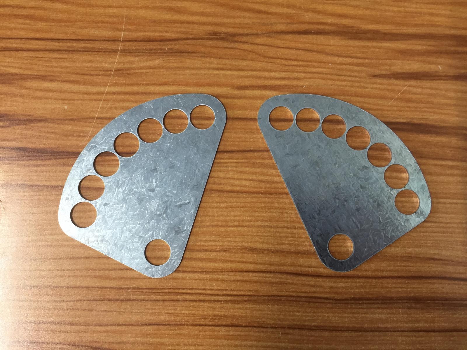

      Hey Brett
      Cheers for your input
      I still believe ridetech was the right choice for my car. Well made strong components
      I have spent many hours fine tuning my front end and I have decided to make a new drag link similar to your version but have moved the tierod pick up points slightly
      With them moved I ended up with

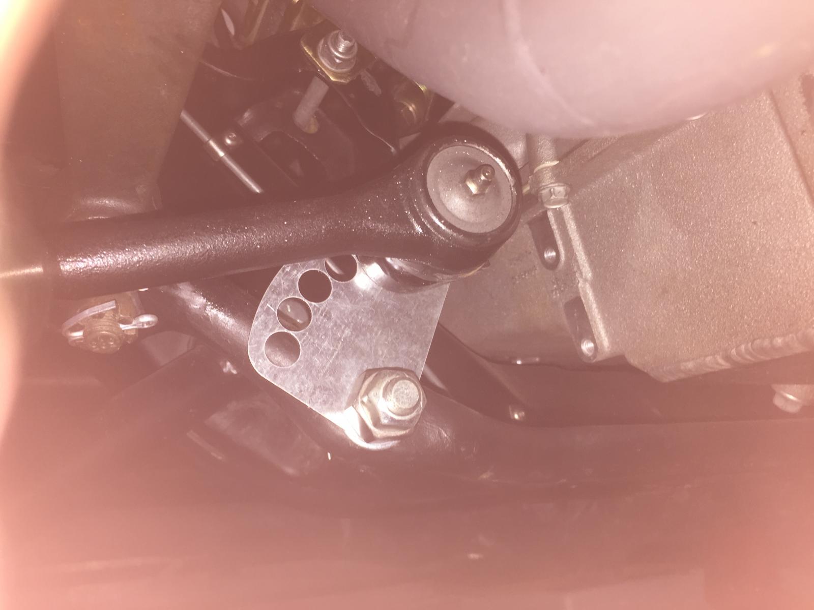

      Ride height toe +5mm 13/64
      Full up toe +5mm. 13/64 No change
      Full down +6mm. 15/64
      I reckon I’ve found the sweet spot
      Attached image isn’t great but shows what I’ve done
      Will build a more rigid test rig to lock in new dimensions before I cnc new drag linkName:  C5FEFE4E-2A1D-4470-B802-BAB237848555.jpg

      I like your tie rod test plates.
      GM designed in some toe-out in bump to compensate for lower A arm bushing deflection which allows the spindle to move inward & rearward when cornering hard. The problem was, it had much more bump toe-out in production than was optimum. My point is, shooting for zero toe change is probably not ideal under real-world conditions. However, the Ride Tech components reduce deflection immensely, which reduces the need for compensation. If your inspectors require near zero bump steer, it will drive ok.

      Here is what I have proposed for certification. Not far from the ridetech part.
      I haven't put the kink in it to match shape of GM draglink as I'm running LS7 oil pan and bottom of pan sits above drag link with no clearance issues.

      Very nice! You did that very quickly!
      Somewhere between zero and .125" toe-out per side in 4" travel is great. I was advised .080" out per side over a 4" travel by Dick Guldstrand on race cars with solid steel A arm bushings. The small amount of toe out will help offset any deflection. I have no way to predict deflection but there has to be some. A small amount of toe out in bump also helps assist Ackerman correction which isn't a bad thing at all.
