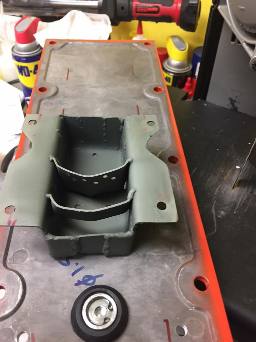

      Hi all, I need help spending my tax check. Lol. Anyway, looking Billet specialties valve covers ( not the hidden coil ones) and relocating coils. Wondering what the best solution for pcv might be. One suggestion I have heard is to put a fitting into the back of each and run to a catch can with a breather. Would I get mist oil everywhere and do I need a baffle of sorts inside the covers?? I already have a Mike Norris catch can installed in valley cover and throttle body. Any help appreciated.

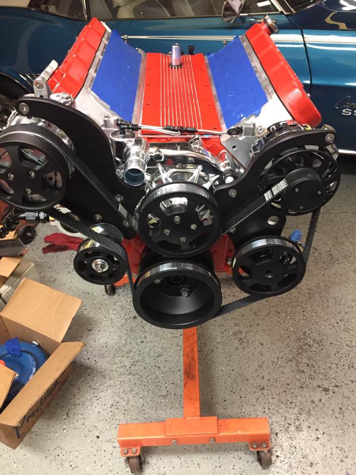

      I machined a spot face and thru hole in the valley cover for my PCV. I also made a bolt on baffle to act as a oil & air separator I'm hoping I wont need a catch can with this set up.
