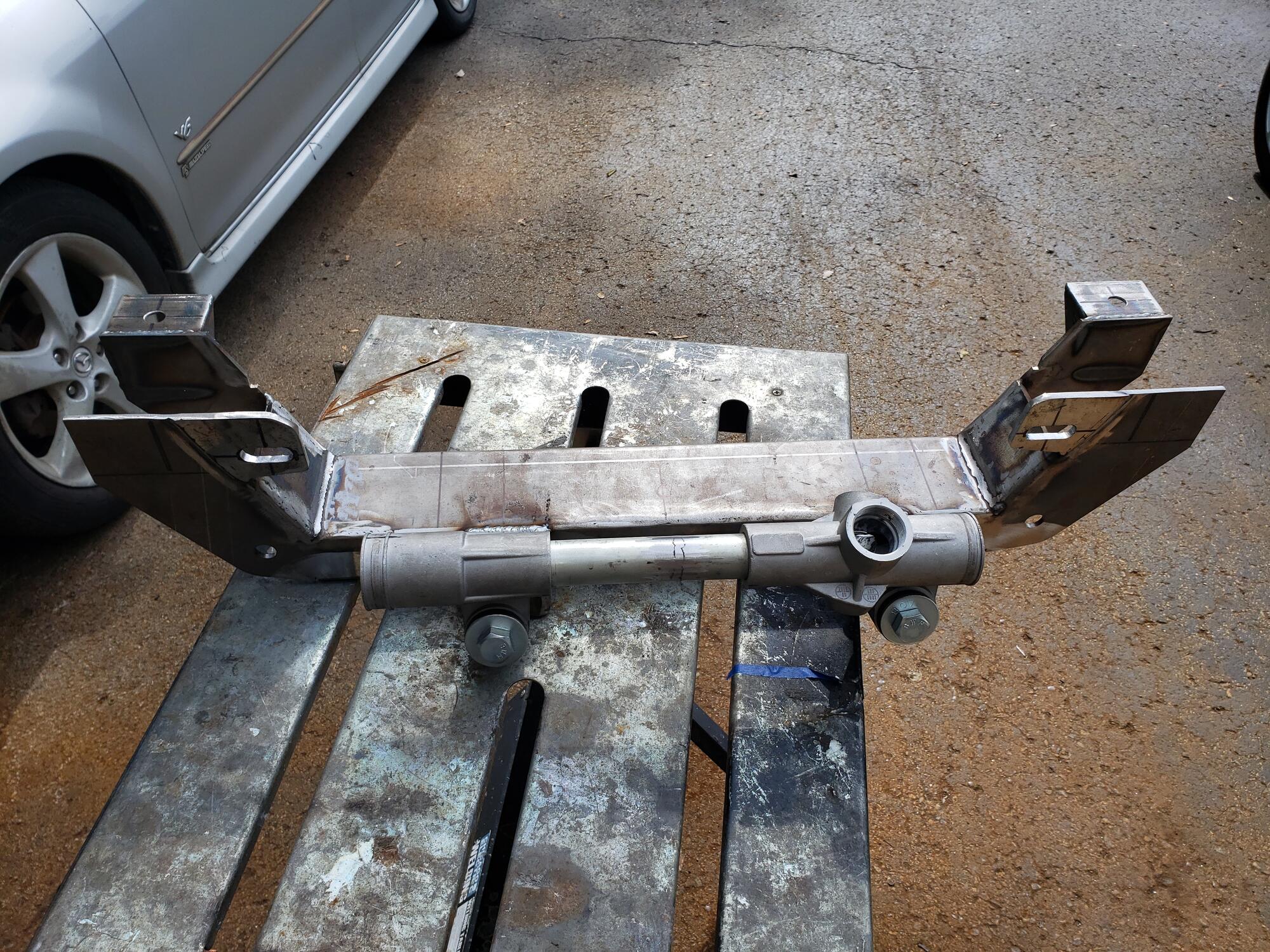

      I had a similar issue. Not because I wanted wider tires...but for other reasons. My car is a '66 Mustang so I am not sure how the Camaro is set up...but I think its already front-steer? My solution for the Mustang though was to convert to front-steer. In my case I used MII spindles and put them on the early-style Mustang control arms(I did have to ream out the spindles slightly to fit the ball joint correctly). I then used a Mustang II crossmember that I modified to hang a MII rack:

      In this case, I am NOT installing the MII suspension, only the MII steering. Because of that my steering rack now mounts below my LCA instead of above it like it does in the MII application. In this picture the green line represents how the MII pivots points for the LCA and UCA line up. The red line shows how the early mustang pivot points line up. You can see how the MII pivot points intersect the pivot points of the MII rack....and you can see how the early Mustang pivot points do not. What this means is that the steering rack has to be shortened so the inner tie rod pivots do line up(some vendors sell pre-shortened racks by the way)...this is to prevent bump-steer(same thing needs to happen with the outer pivot points as well, but the spindle takes care of that. So I simply shortened the rack and moved the rack mounts inward:

      Now the inner pivots line up. As part of this front-steer conversion, the aftermarket MII spindle steering arms are inside my 17" wheels:
      The original steering arms were longer than the MII steering arms. This is a 7" wide wheel with a 225 tire...but I could fit a 315 tire on a wider wheel under here if I wanted to now....but since I am keeping manual steering, I am not really interested in doing so.
