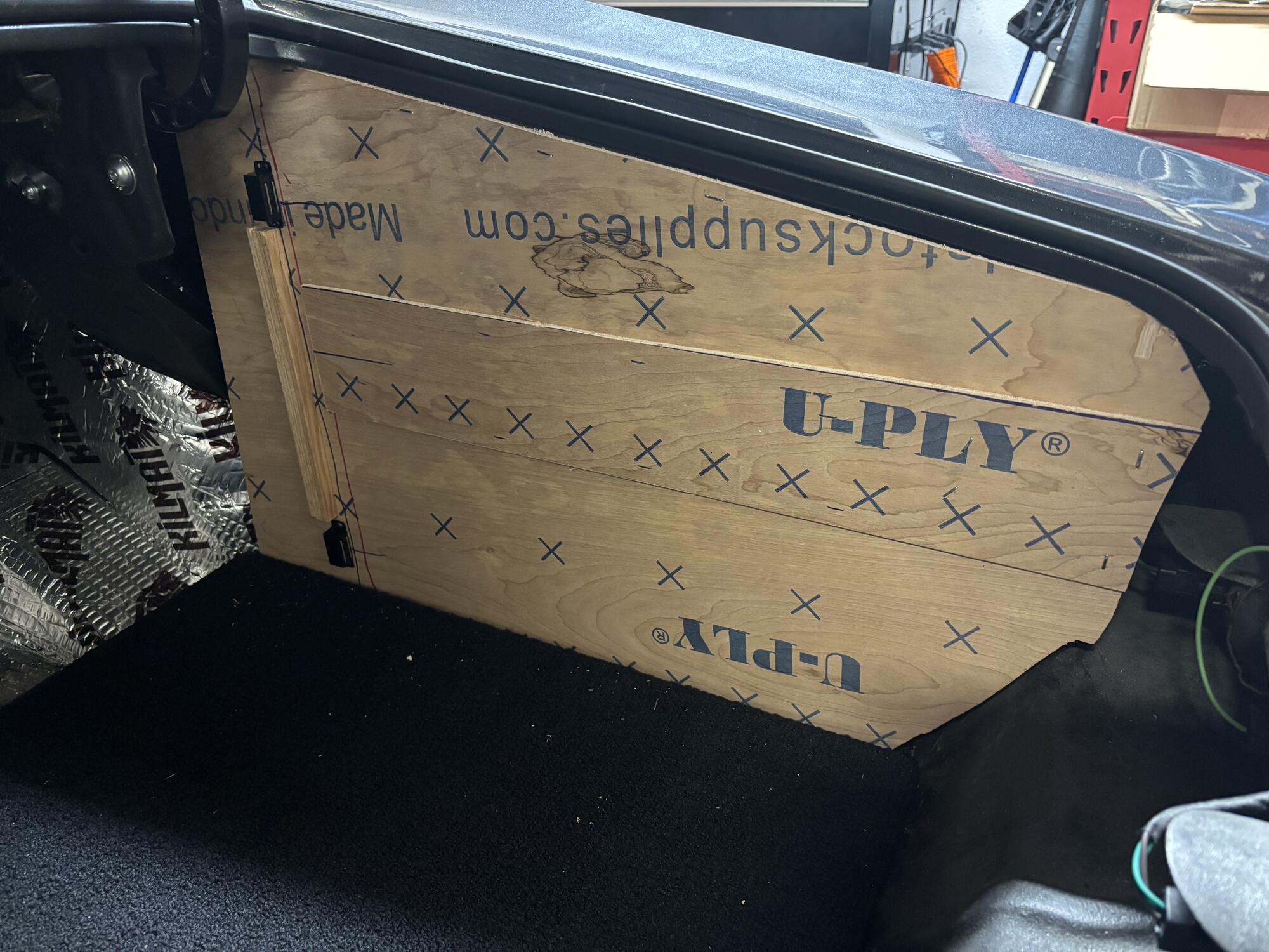

      The weather in Oregon is miserable and I’m board so I’m finally starting to work on closeout panels for the trunk. My grand plan is to mimic the design in the center of the door panels but we’ll see if my skills can match my imagination. Name:  IMG_5993.jpg
Size:  346.1 KBName:  IMG_5994.jpeg

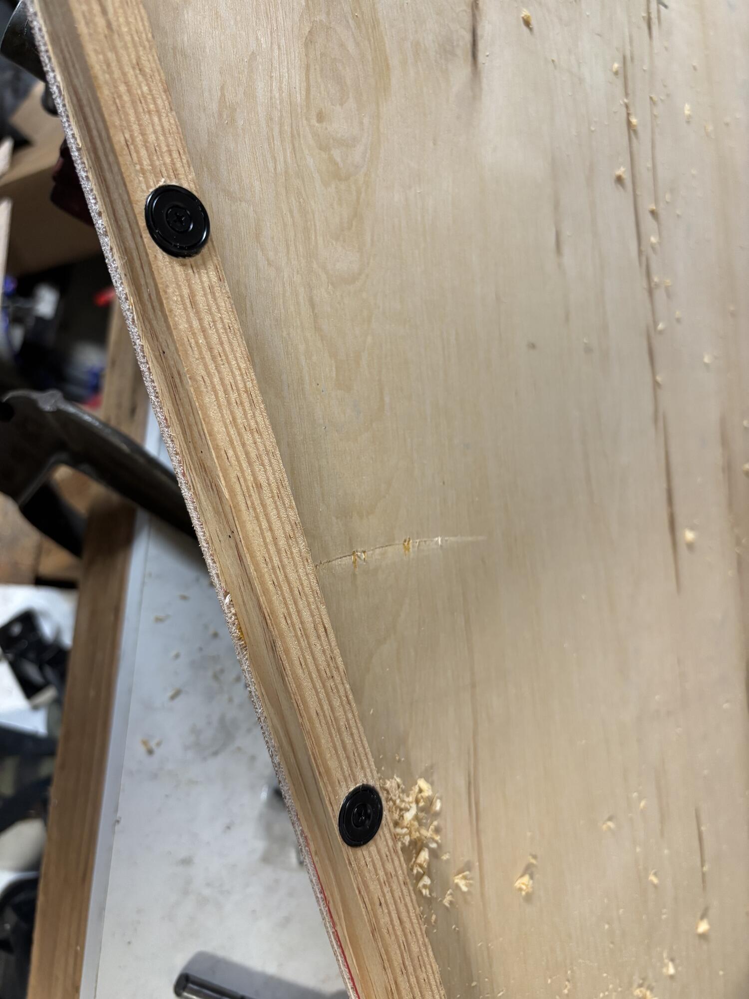

      Trunk panels are coming along pretty good. Not show quality by any means but once it’s all wrapped in black vinyl it should look presentable. I’m using two different types of magnets to hold everything in place. Some little round magnets for holding the sides to the sheetmetal in the trunk and some magnets used for kitchen cabinets. They’re actually working out better than expected.
Size:  226.9 KBName:  IMG_6002.jpg
Size:  195.6 KBName:  IMG_6003.jpg
Size:  415.3 KBName:  IMG_6001.jpg

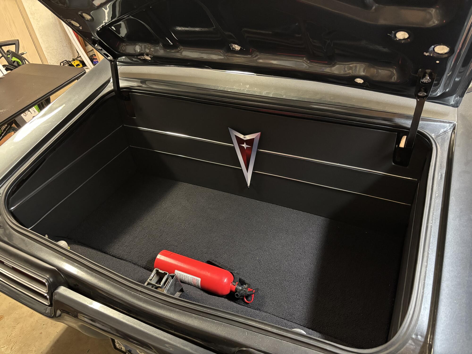

      Got it all upholstered. Used 1/4” adhesive backed wheel well trim for the chrome stripes and I found a vendor on eBay that made this sweet laser cut Pontiac spear. The only thing I have left to do is wire up some LED strips on the back of the spear for a little back glow when I open the trunk. It’s definitely not a professional job but looks pretty good and probably cost me $200. Name:  IMG_6020.jpg
