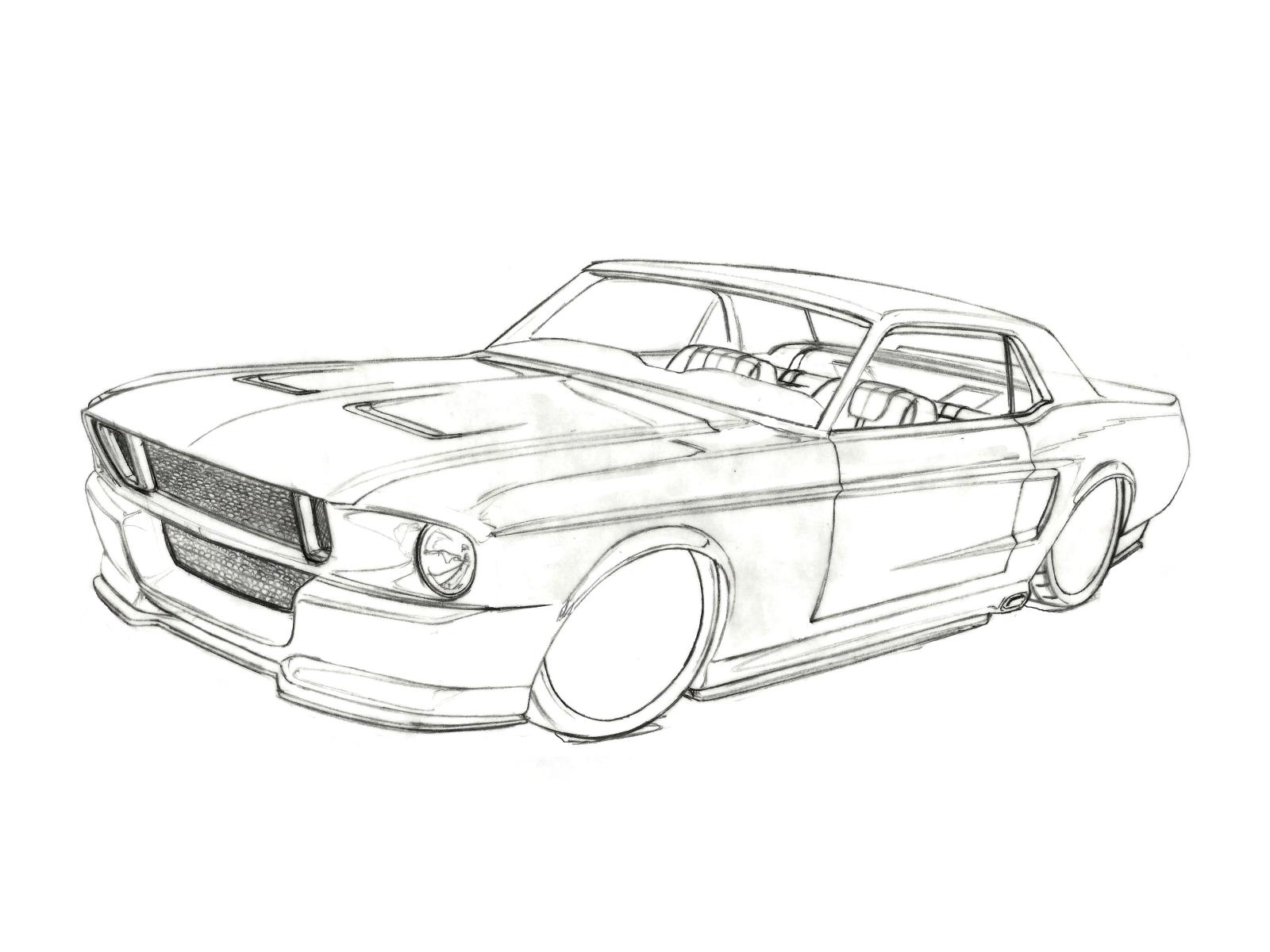

      Getting a rendering done to finalize color and wheel choice as well as figure out a couple other details
      Name:  corruptt sketch 2.jpg

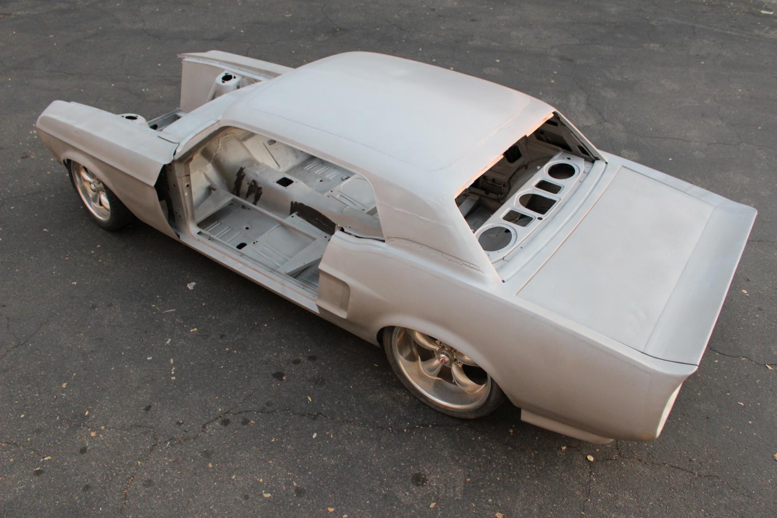

      love the chopped top ! can you give us some details on it?how much was taken out, front posts leaned back or not, what about the windshield glass? how about the door glass? I have been contemplating a one inch chop on my 67 cougar custom but haven't figured out the door windows yet
      Oct 2017
      14
      Quote Originally Posted by hardwork1 View Post
      It's chopped 2.5" straight down. The windshield is at the stock angle. The rear window has been laided down and flushed and is still the stock size. Windshield will be flush mount glass cut down to fit. Door glass still needs to be figured out. Probably going to use 69 door glass to eliminate the vent window. Door glass material will end up being acrylic

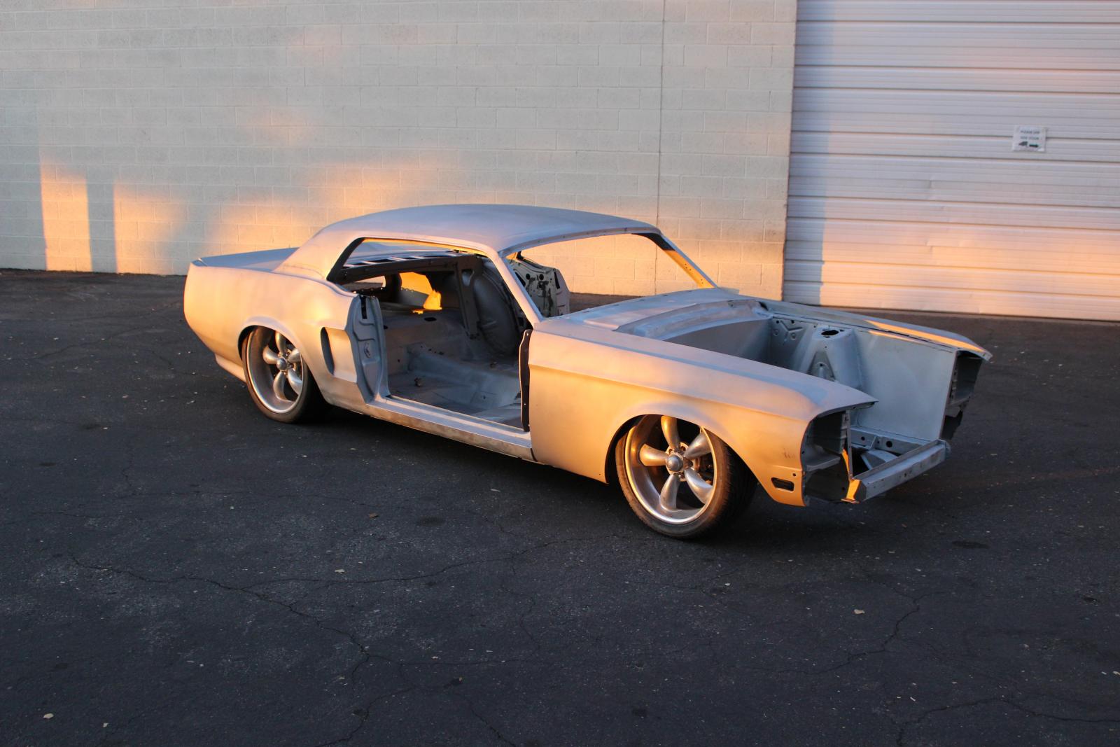

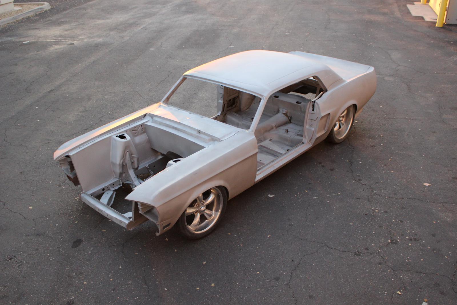

      Back from the blaster. Ready to figure out what it's gonna take to make the engine fit
Size:  217.8 KBName:  IMG_0052.jpg
Size:  192.6 KBName:  IMG_0062.jpg
Size:  171.6 KBName:  IMG_0049.jpg

      Love the new pics. I have been researching glass for my chop and I think there are several glasses that have a good chance of fitting, Your idea of 69 glass is great also look at 90’s Eldorado 2 door it has a flat top also. I made a cardboard template and hit the local upull-it.
