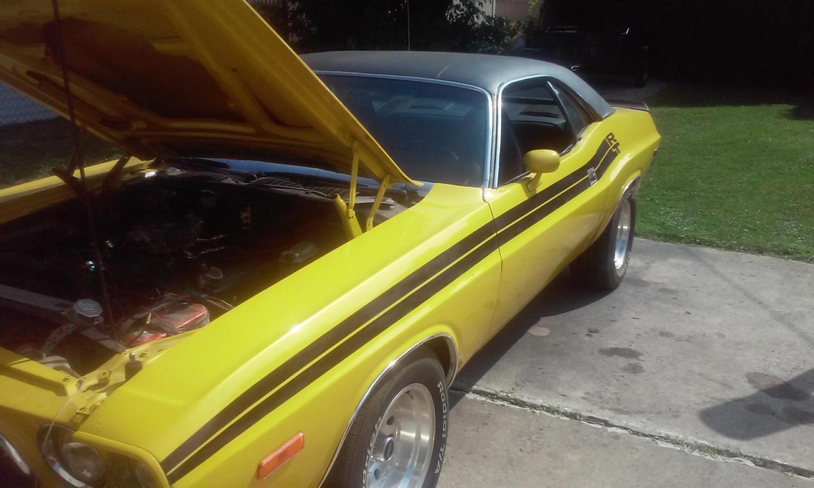

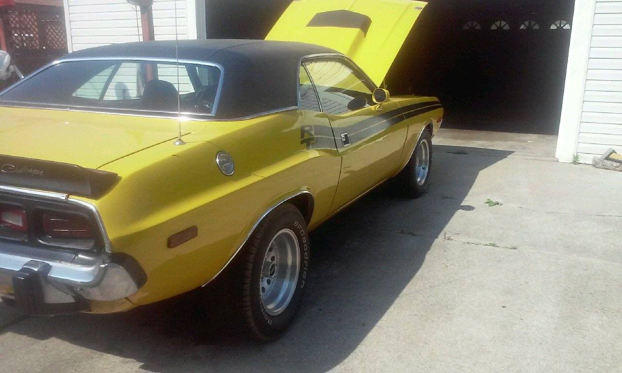

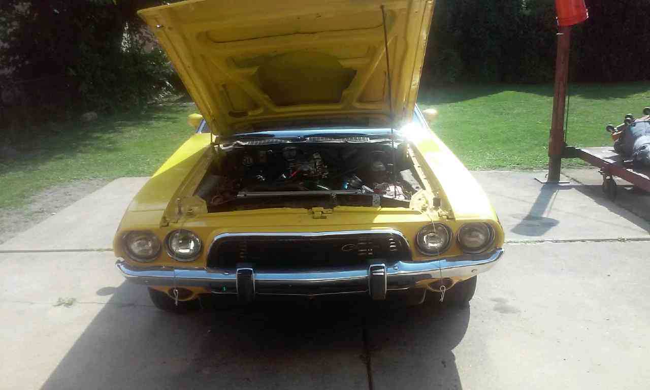

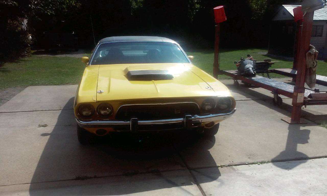

      So recently my my uncle has approched me about purchasing his 73 challenger, he has owned the car since I was about 6 years old and I’m 26 now. In that time he’s only put 4000 miles on the car and 1000 on the 440 he found for it about 12 years ago. Car started as a plum crazy purple with a white top and had a 340 six pack in it.
      I have big plans for the car but I first want to address the suspension, I know about the Hotchkis system but not sure about any other companies that support the mopar E body platform, are there any coilovers systems out there? I guess I’m looking for someone who can point me in the right direction on where to look for suspension systems. Real world experience would be appreciated.

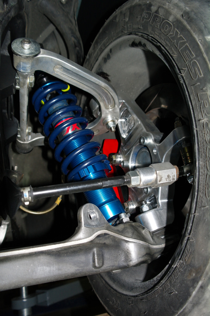

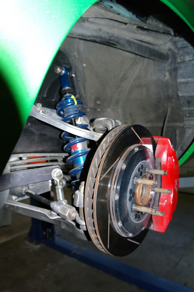

      I would like to add another option in the Coil Over department.
      https://xvengineering.com/ sells a Corvette C6/C7 based front suspension that is all aluminum. They also offer a 3-link rear suspension with a panhard bar. I have this system on my 70 Cuda, and have had it since 2010. Real deal handling. I can assure you. The front sells for $5595. It has second-to-none engineering behind it. Done on 4-post rig by Multimatic. It was developed by now defunct XV Motorsports. But employee Chris Reinhardt continued the effort.
      I have a playlist from Dream Car garage about the development of this system here -->https://www.youtube.com/watch?v=12rA...rmaqxMTtXoFdGv
      As for brakes you have endless options since it's Corvette based. I have Stop Tech. Also there are a huge aftermarket support for anything Corvette, I have drop spindles from LG Motorsports on mine.
